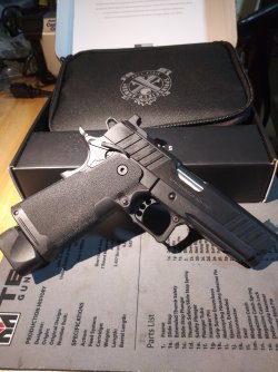

Put another 50 issue-free rounds of Browning 115gr FMJ through my Prodigy today. This gun is a dream to shoot and silly accurate. I brought two of my classic Sigs along today as well, and easily out-shot them with the Prodigy. Unless I have a signficant issue with it at this point, I consider it GTG and won't keep updating. I trust it enough at this point that it's getting rotated in for nightstand duty.

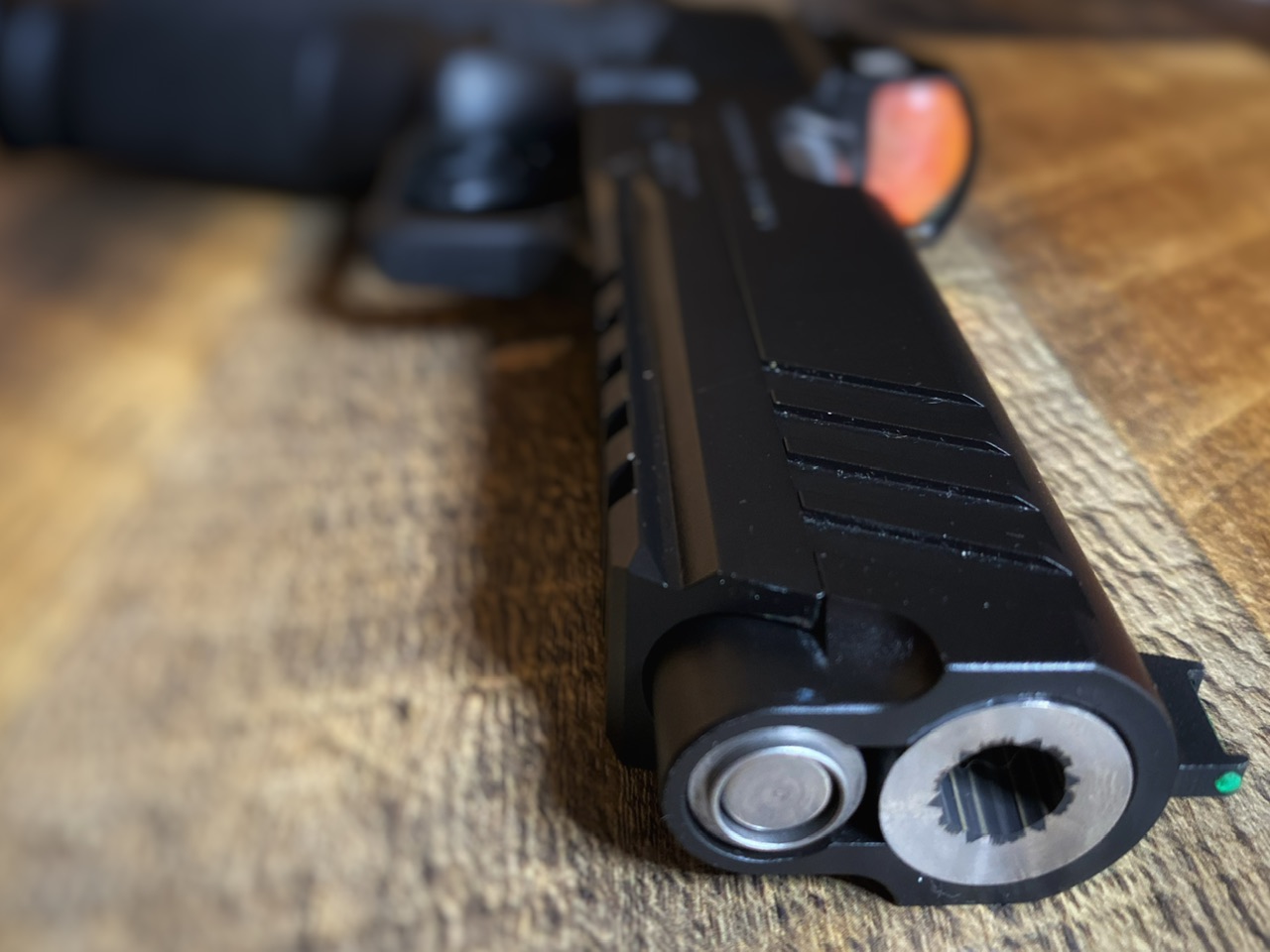

I installed a Dawson Precision Tool-less guide rod in my 5in Prodigy. If you don’t like the two-piece guide rod - and I was not a fan - this thing is a no-brainer. It actuall natures the spring via a small lever that looks the spring in place. It also comes with the correct sized reverse plug which also becomes part of the captive spring assembly. The whole thing is stainless and matches the bull barrel quite nicely. Put a box of Mag Tech 115 gr through it today to do a function check. It ran just fine.
