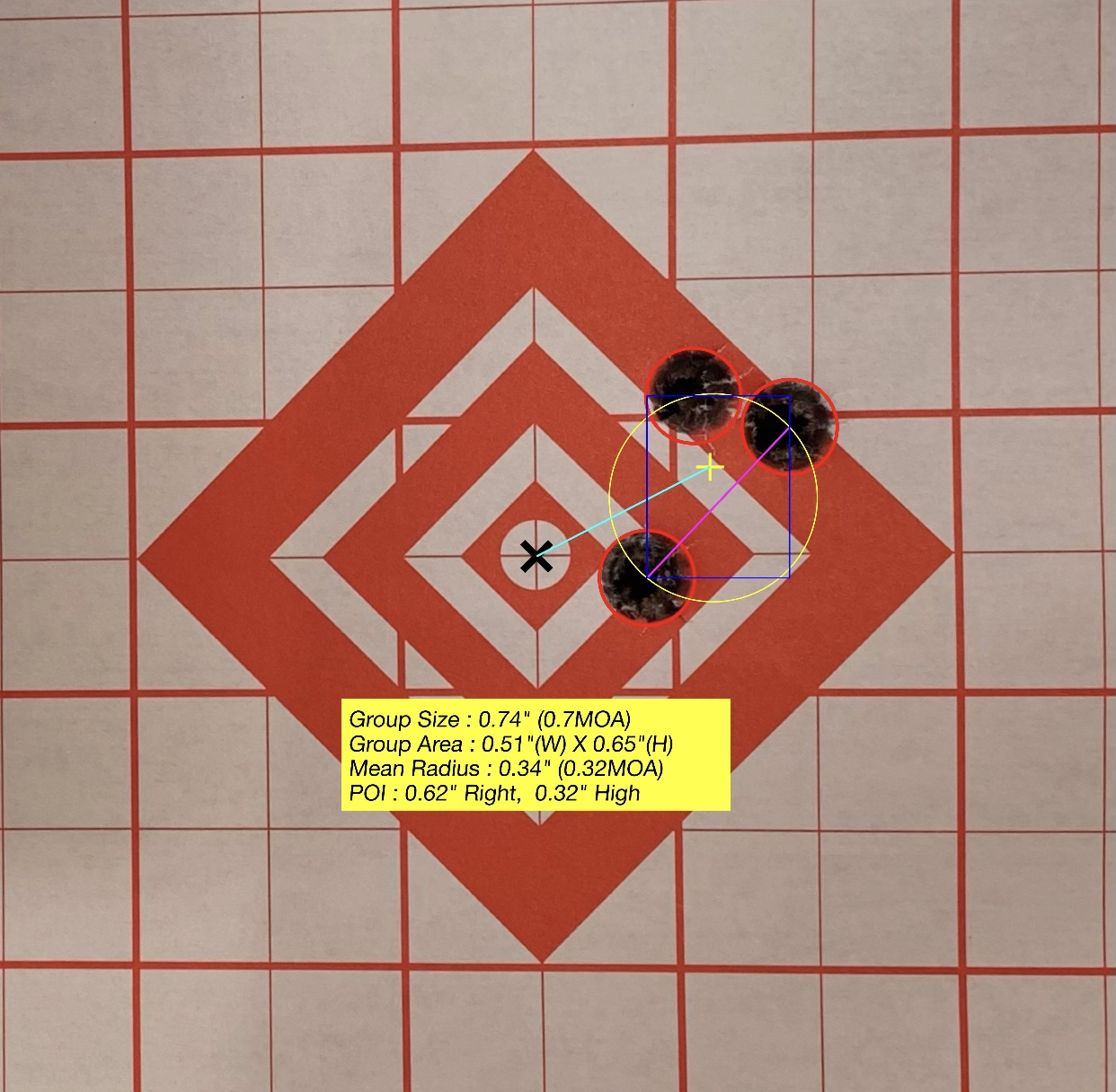

Mine has shot most factory ammo pretty well. It was a bit finicky to load for. I was running to pressure signs earlier than expected with most loads. I finally got this combo to work and it shoots very well. I also think this will be a great combo for hunting with. 2690fps with the 300gr accubond.
The weight is really not bad considering, definitely light enough to hunt with. It is very long with the supressor but since the stock folds it’s still compact enough to carry slung or in the side by side.
Pictures are 100 and 300 yards.

Barrel length, coal and powder charge? US869 fits the heavy 270 and up, but marginal on 250 and 265gr. US869 is like rl33, n570 and lrt work best for the heavies.
