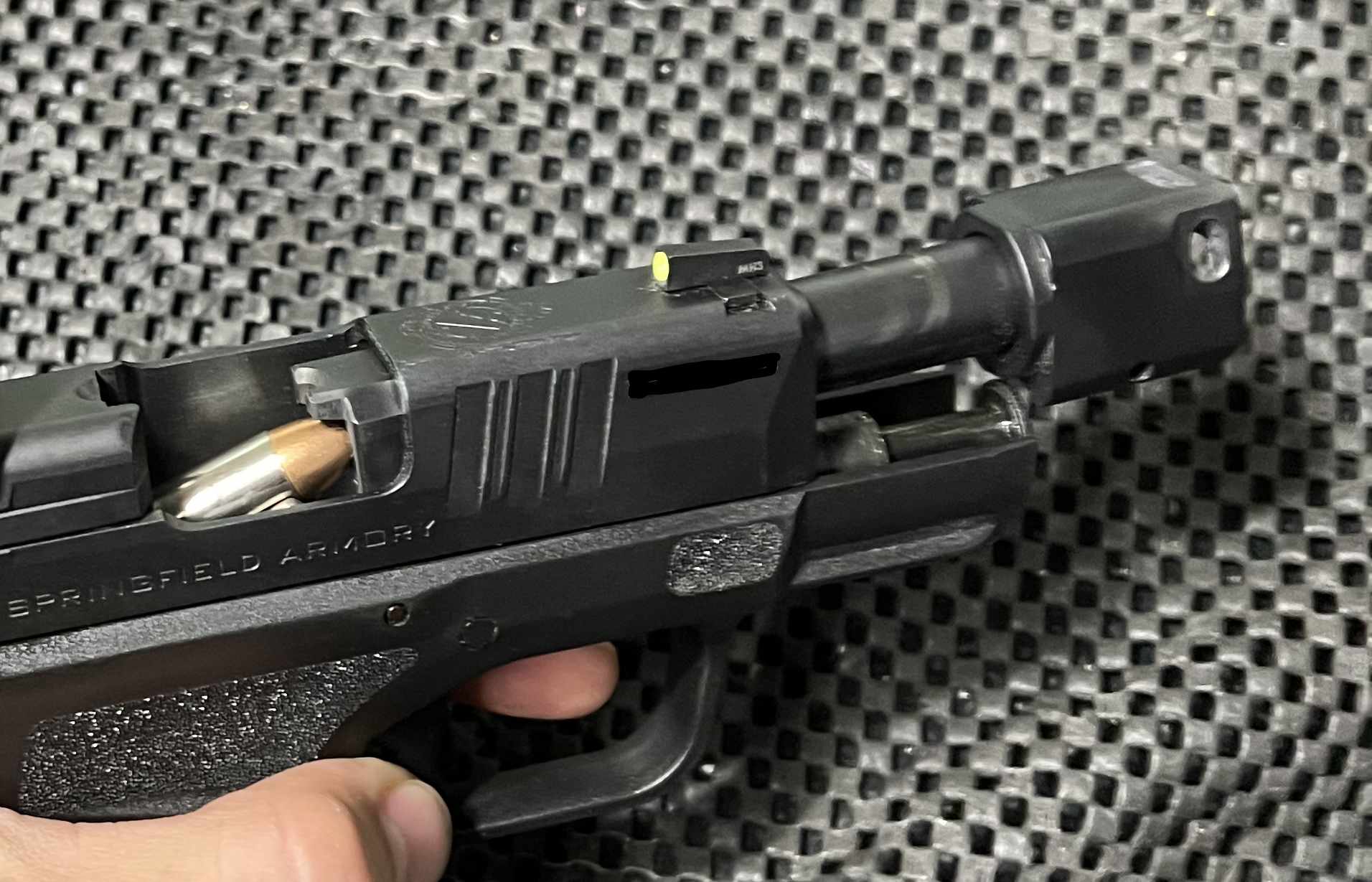

- The gun jams pretty frequently too (photo attached.

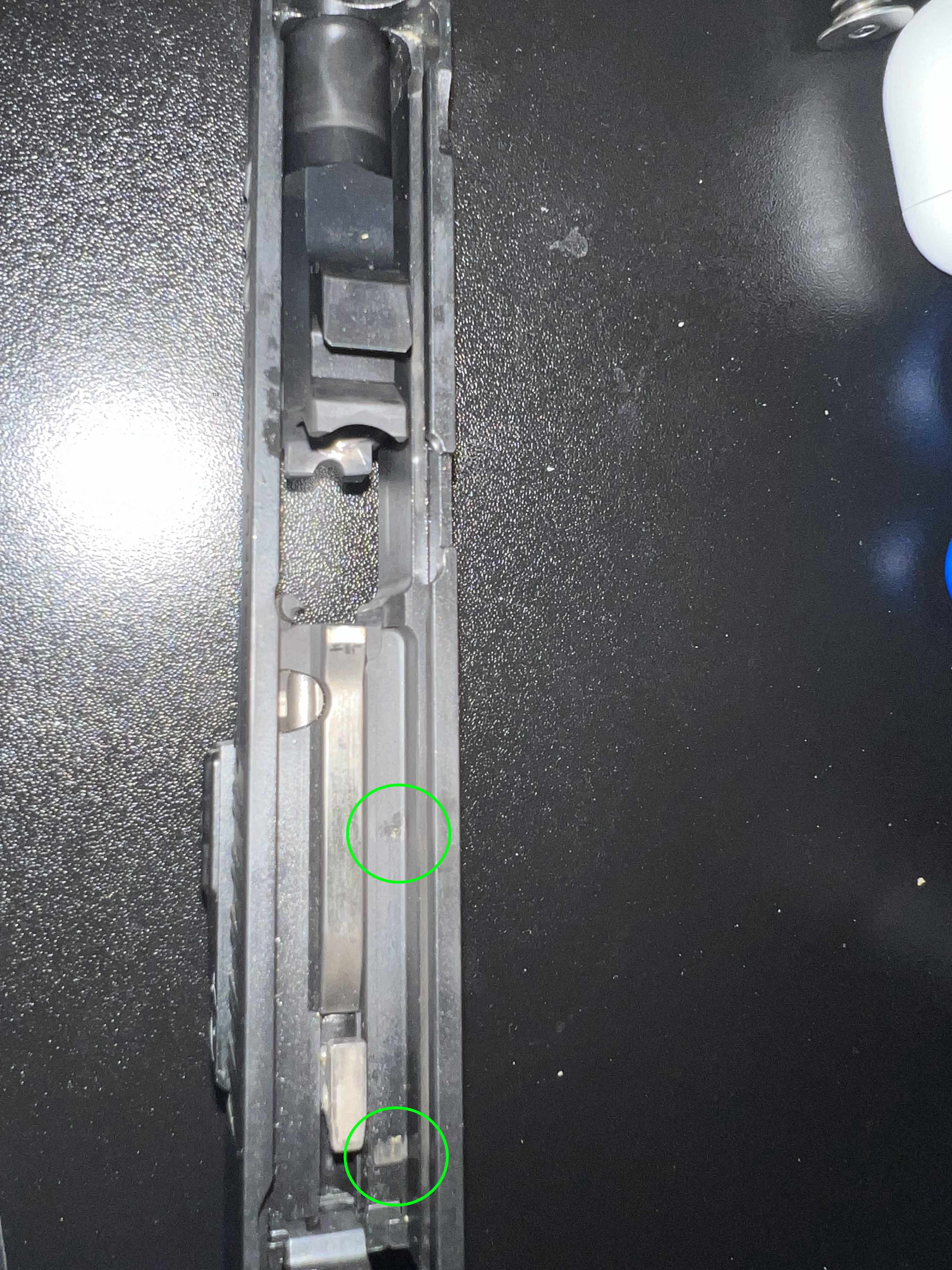

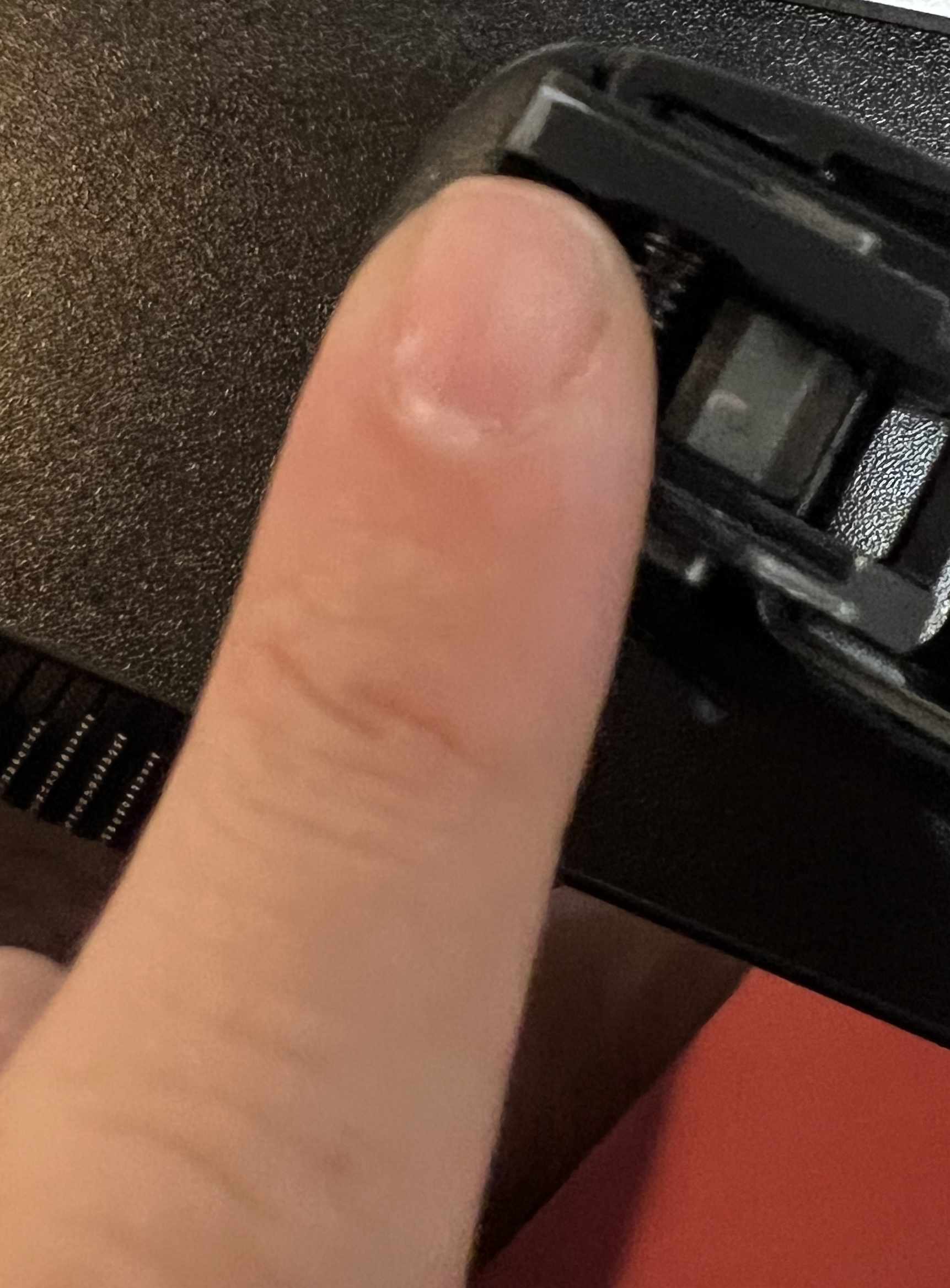

- After the gun jammed at the range and I field stripped it, the range officer pointed out excessive wearing in the slide (photos attached)

Judging just by the pictures and your description of the problem my first thought would be that the slide is defective (not machined to tolerance), but I would just document the issues in as much detail as possible and then get it into the hands of a qualified GS or the manufacturer. Save yourself the frustration and if that’s a gun you carry the risk of it not working when you need it most.

As far as the pictures showing wear, sorry but I don’t see it although the pictures are not great.

I would start by stripping the slide (Removing the striker and the extractor with its associated parts.) Be careful, they are under spring tension. Disassemble inside a large clear plastic bag in case parts launch. Give everything a good cleaning and re lube per operation manual guidelines. Both the problems you describe (feeding and not firing) could be caused by fouling buildup in the striker and extractor spring channels. A sticky extractor is often to blame in feeding problems. Don’t use any oil on these parts during reassembly.
As far as excessive wear goes, your pics look odd. Nothing should be touching the slide where you circled. Same for the spot on top of the rear rail. It makes me wonder if a piece of debris got inside your pistol and ground its way through the gun with slide reciprocation. If this is the case I don’t think it did any serious damage. Only cosmetic.
