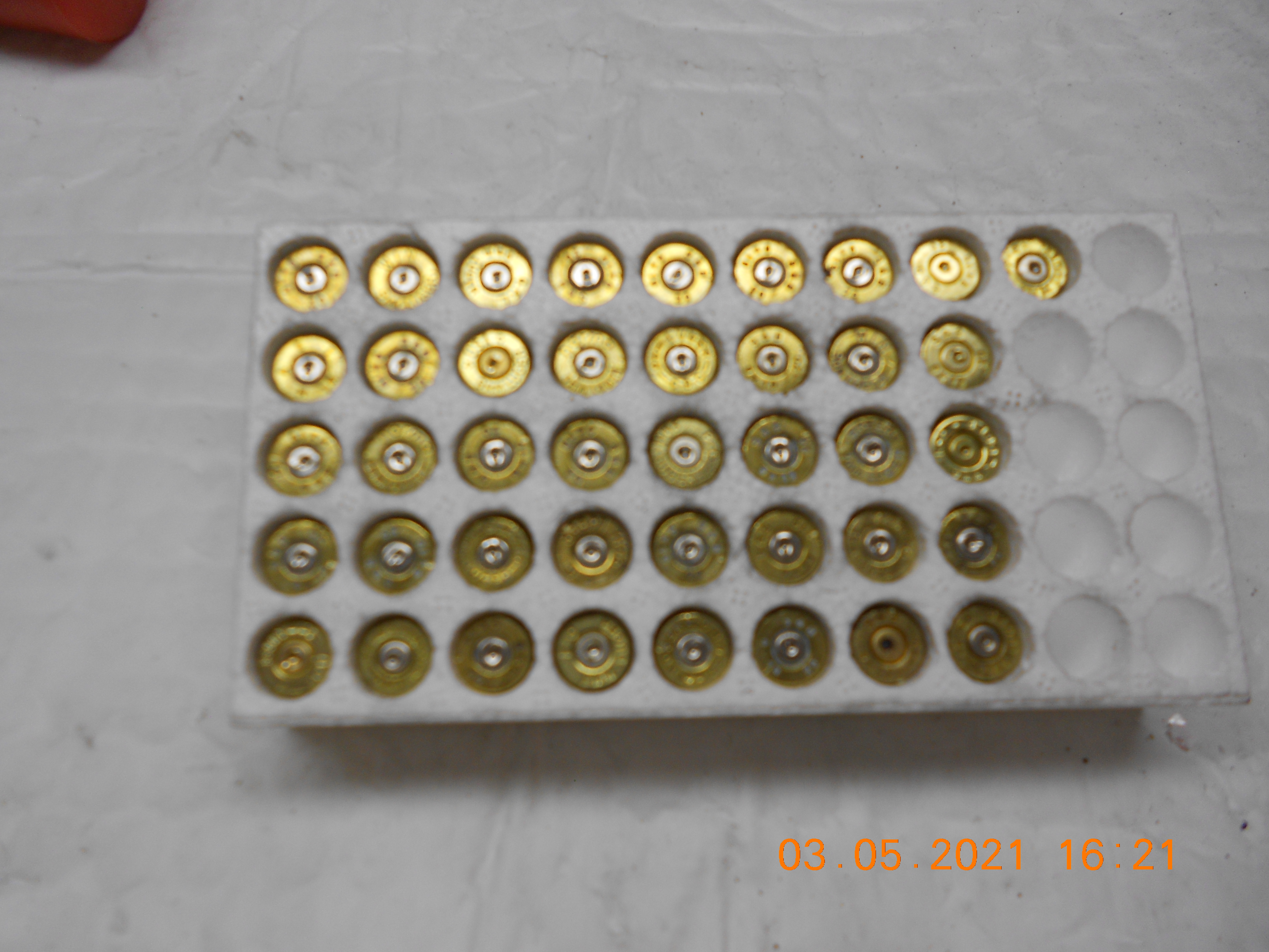

i took my hellcat to the range today.
this is the best my lousy camera can do, but i can assure everyone, there is some firing pin drag here too.
the striker fulfills it’s life expectancy
