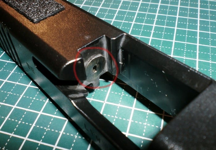

i recall seeing the back side of the breech face destroyed by constant dry firing with out snap caps.
here is only 1 that i could find right now
breach-face-jpg.14617

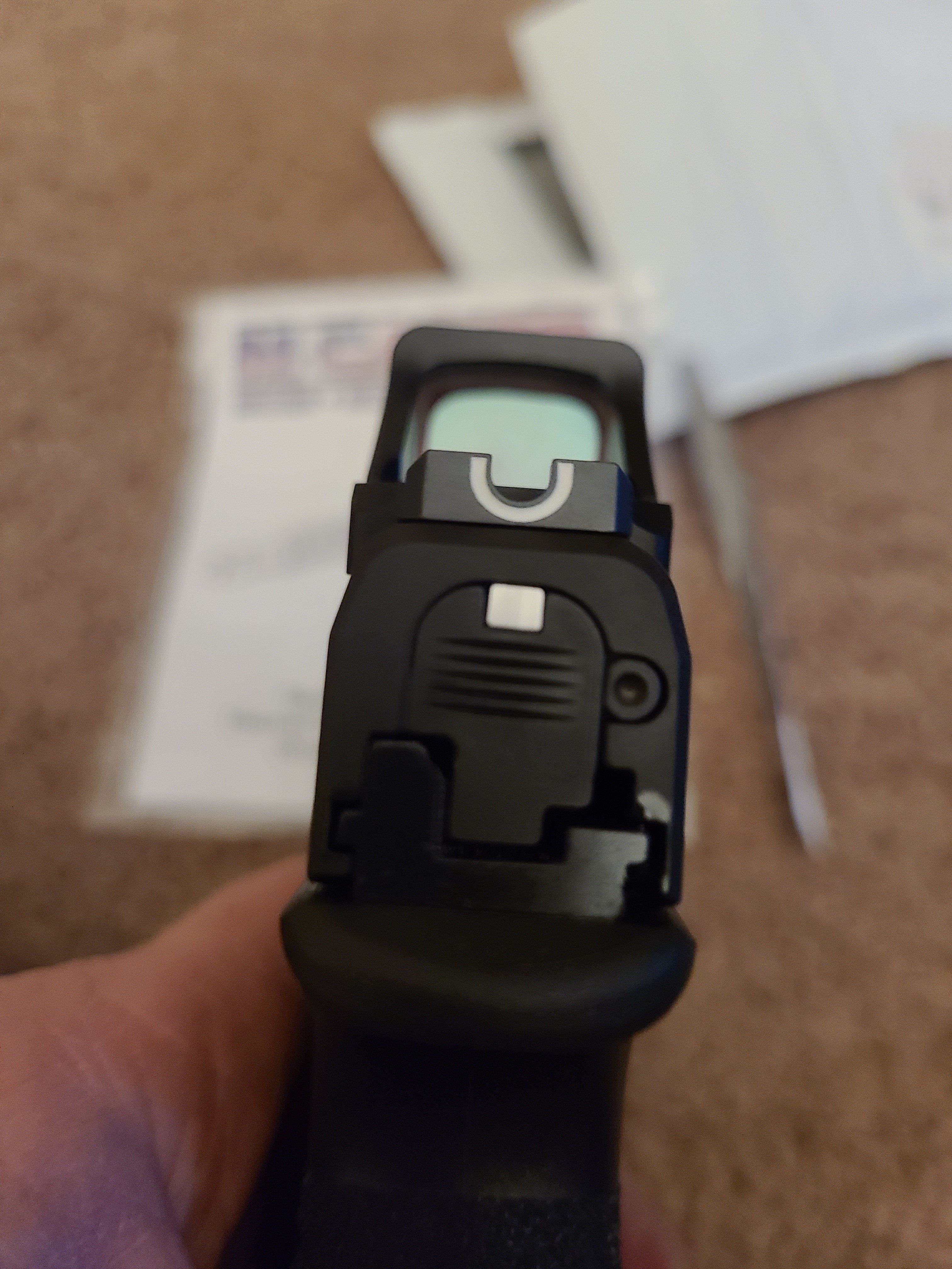

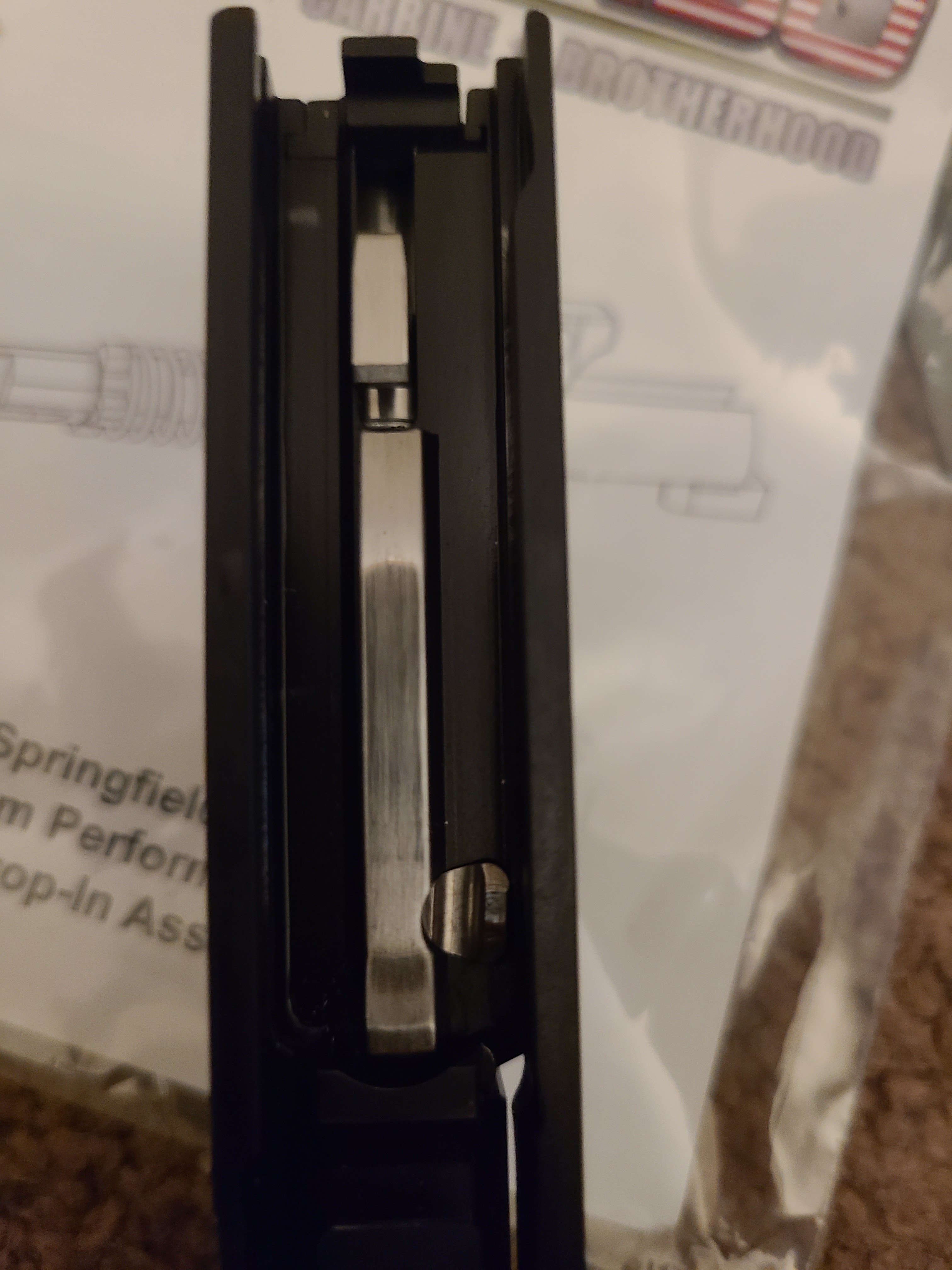

Just got the new Titanium Performance Striker kit from Mcarbo in. The Striker, spring, sleeve and cups comes all assembled already. Kit also contains a softer safety and sear spring. Installed every thing very quick and easy. The click is way more quite, trigger press is way way more smooth, wall is way nicer and break is very nice. Only dry fired it with snap caps so far. Dropped a laser cartridge in for one shot, just to see if everything is good to go and it looks like it is. I hope to hit the rang tomorrow.
In this shot you can see the titanium sleeve post at the rear. That is usually some plastic thing.
you're going to see, and feel a much better Hellcat, like i did, and i also had the MCarbo trigger installed.
I hope so. I'm holding off on the trigger till I shoot this some. It's so soft and smooth now. I do like a touch hard wall at the moment. We will see how it goes. There is no red dot movement now after the trigger press.
