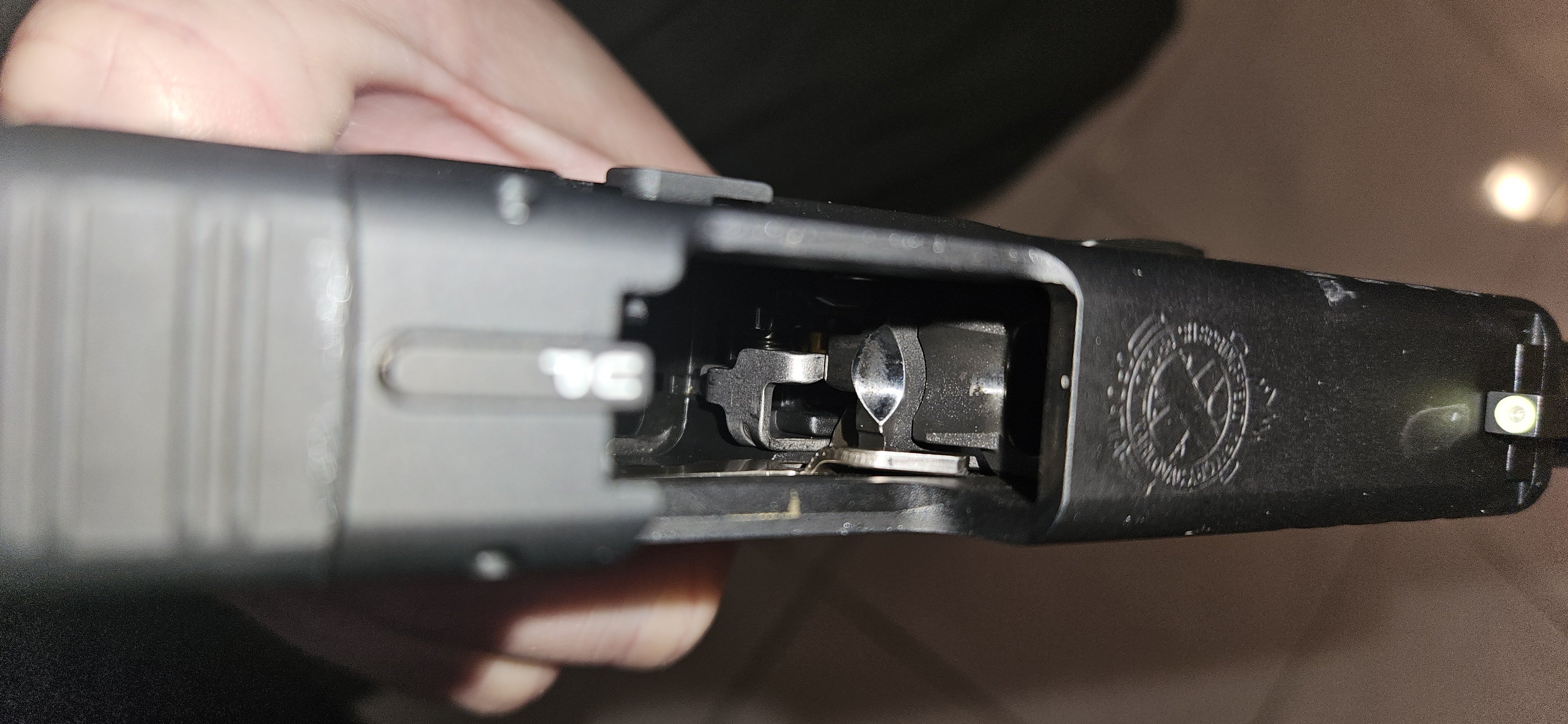

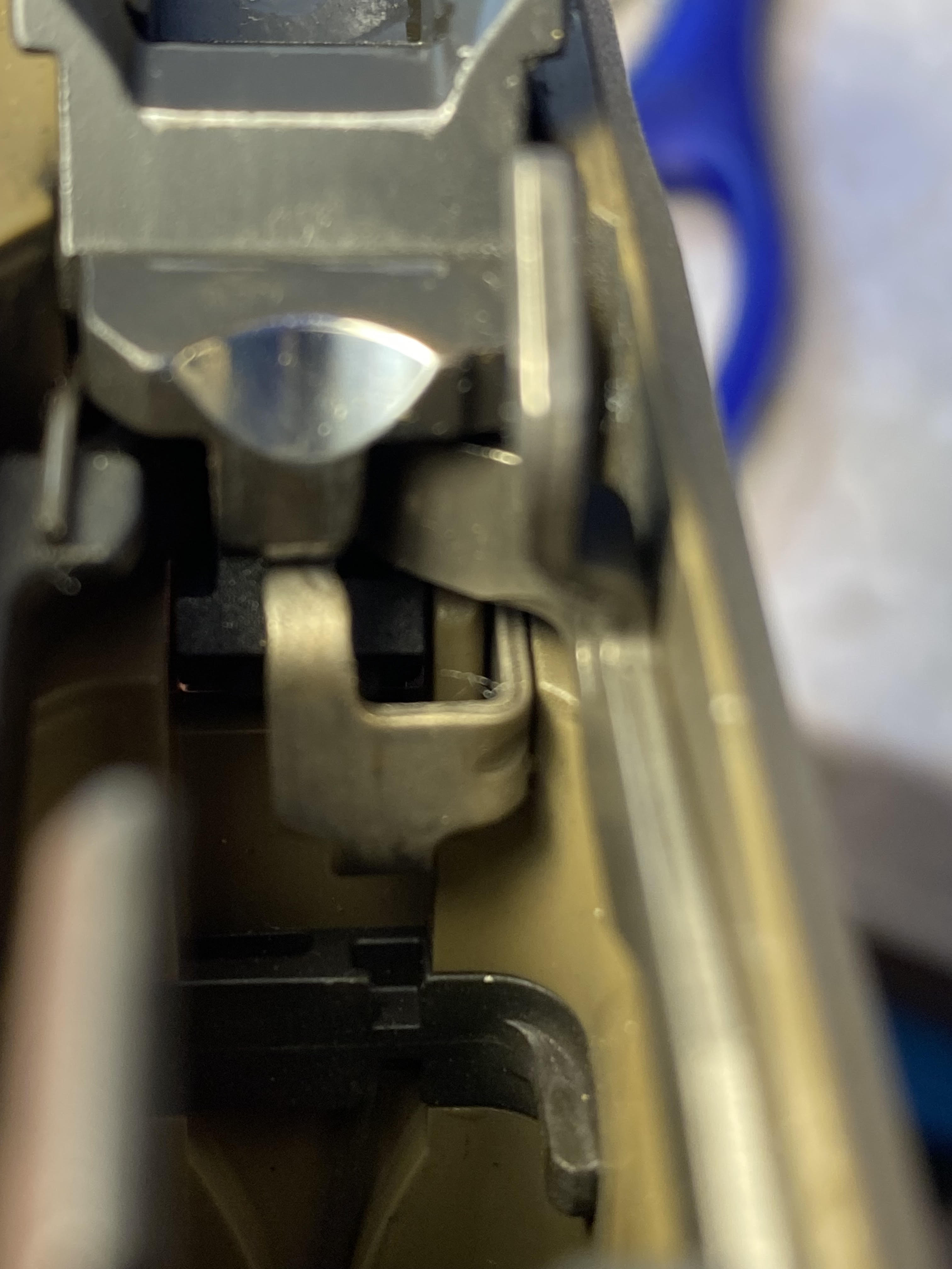

So I installed a Tyrant trigger on my hellcat pro. When I put everything back together I think i overlooked the "Magazine Blocking Lever" It wasn't seated in the right position. All the pins were put back and went to put the slide back on.
Now I can't dry fire or even take the slide off anymore.
Need help! How Can I remove the slide a different way than the normal. so I can reposition the blocking lever
Man I wanted to help you out but I can't duplicate this yet... are you saying that with the magazine block lever installed incorrectly, the slide went back on correctly? Also you say you cannot take the slide off or fire, but does that mean you can, or cannot rack the slide? If you can rack the slide, can you take a clear picture of the blocking lever? Wanted to recreate this for my own knowledge and perhaps to help someone in the future as well.

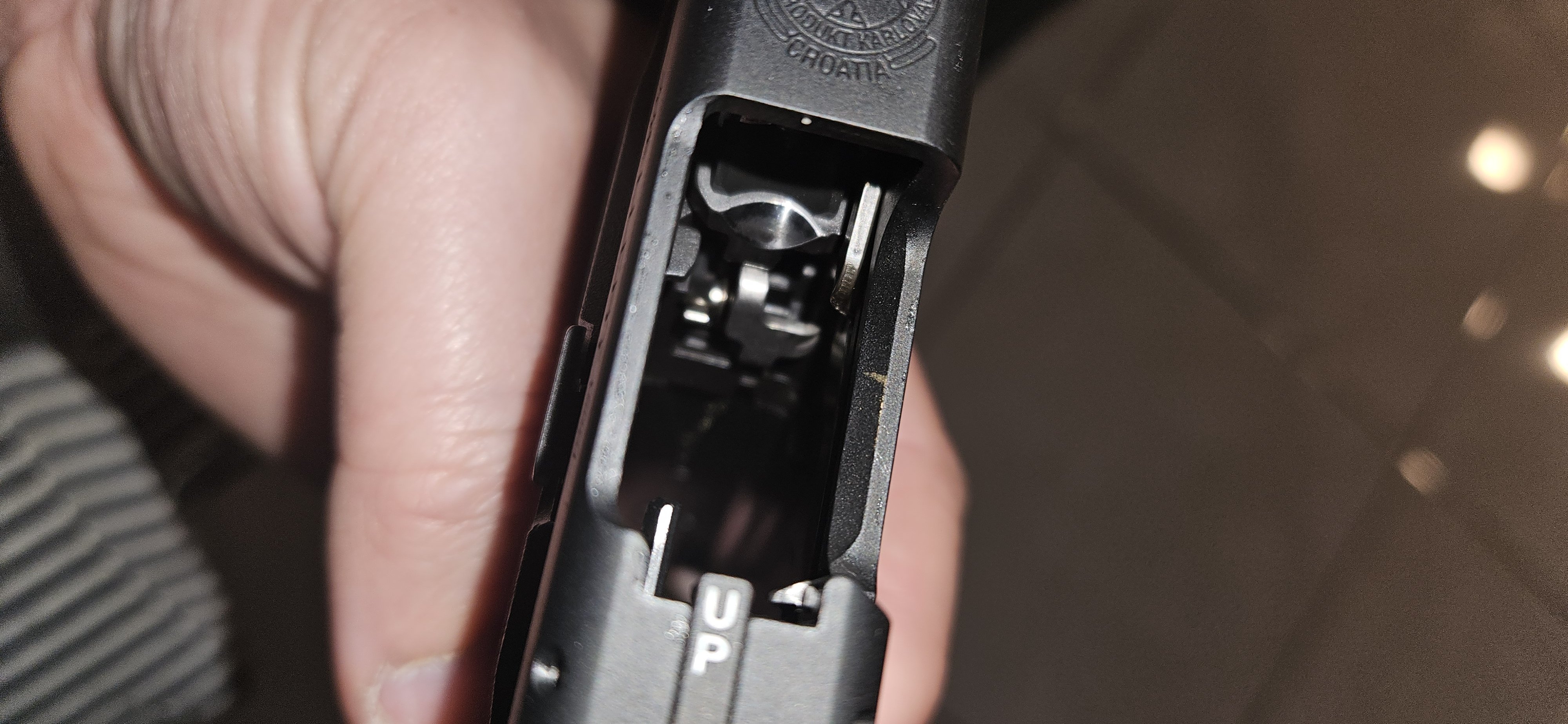

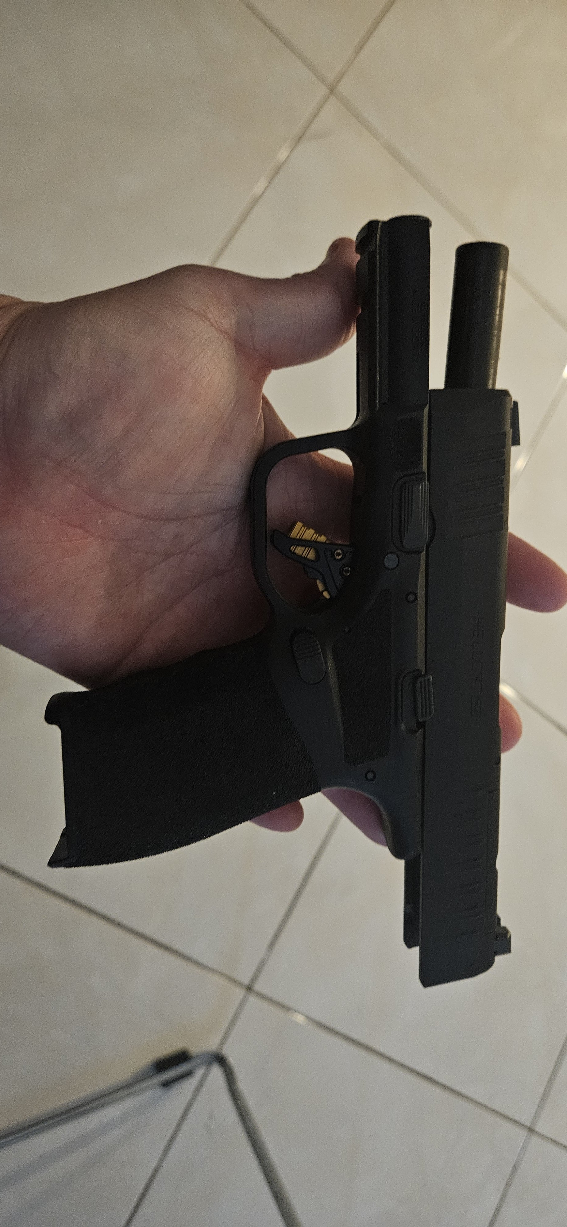

I was able to put the bigger pin back in correctly and put the slide back on. It racks perfectly fine.
I CAN'T slide a magazine all the way through. When I rack it back I can see that the magazine hits the blocking lever not allowing it to fully keep going. In the 2nd image. that U shaped piece is "I Think" supposed to be hooked in on the bottom instead of sitting on the outside of the block. I might be wrong with my terms.

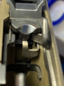

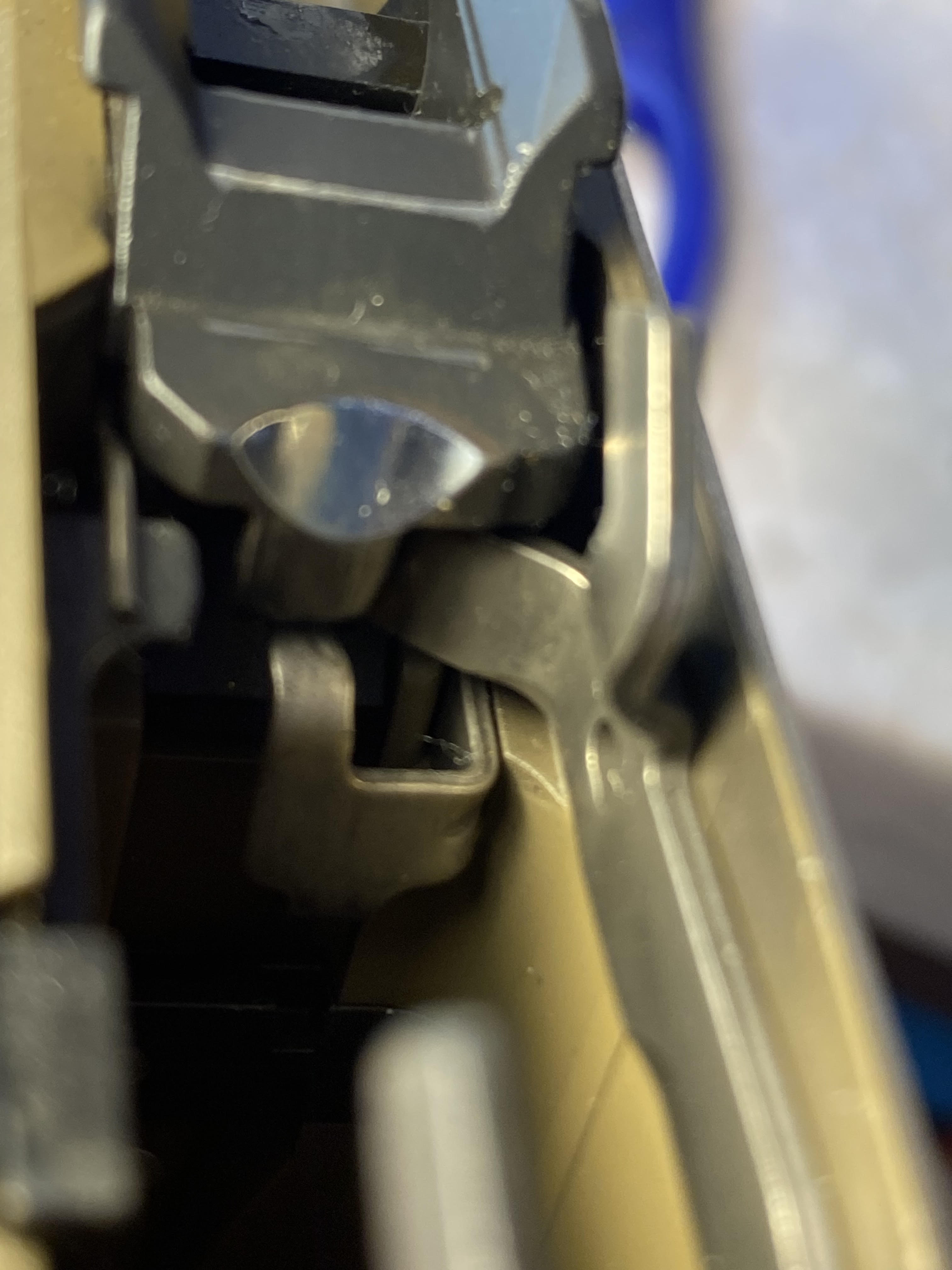

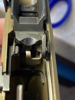

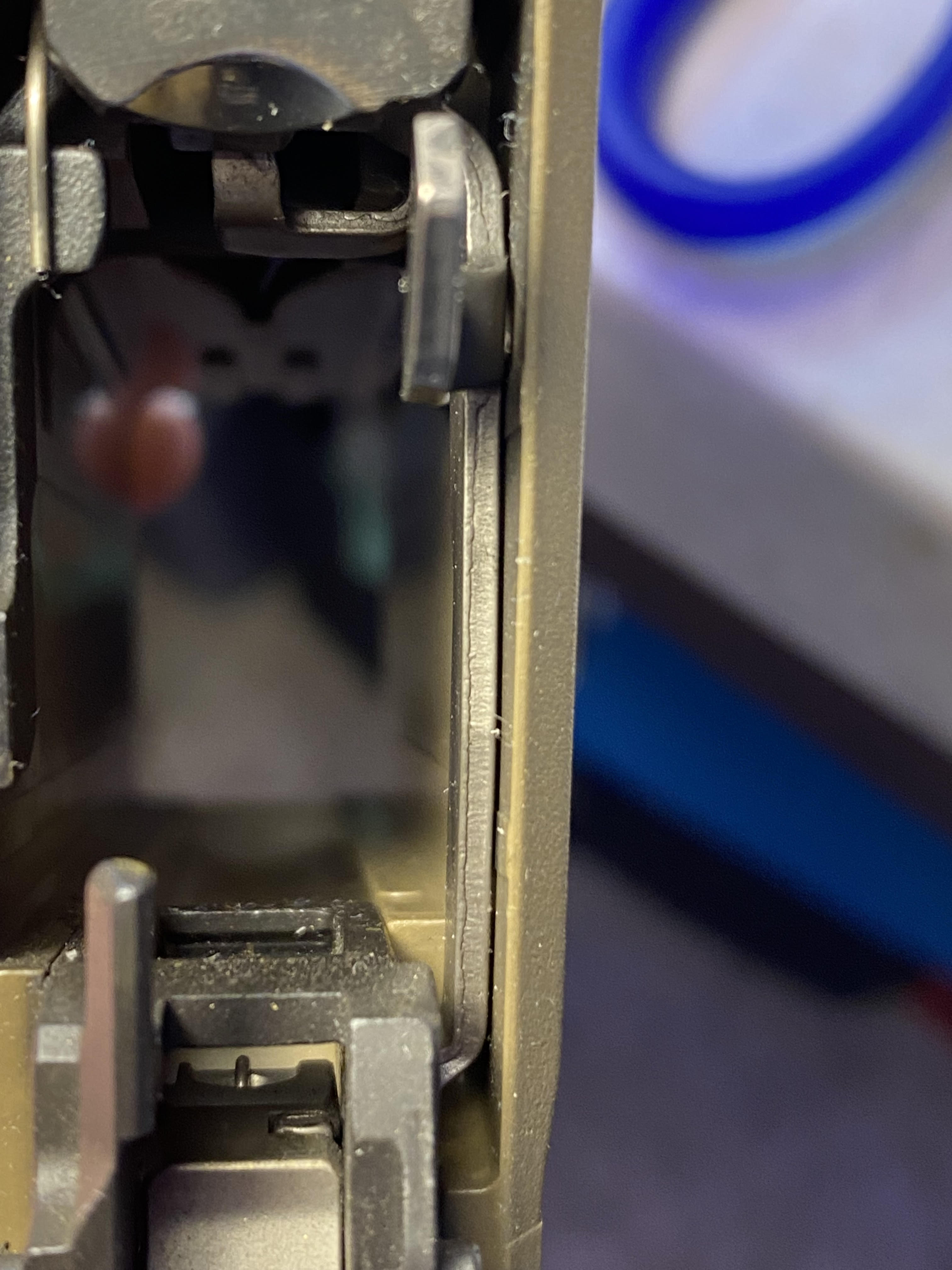

deff looks different, pushed out... bent?

I did call SA and they told me to send pics and what not but I get a little impatient and wanted it done quickly.
I went to a local gunsmith where I explained the problem and he said the issue was that magazine blocking lever was just sitting on the outside of the block. Don't know if that makes sense. He was able to remove the slide by taking off the back plate and doing something else which I can't explain. Magic?
Anyways its all fixed now. Only had to pay a whopping $25.
