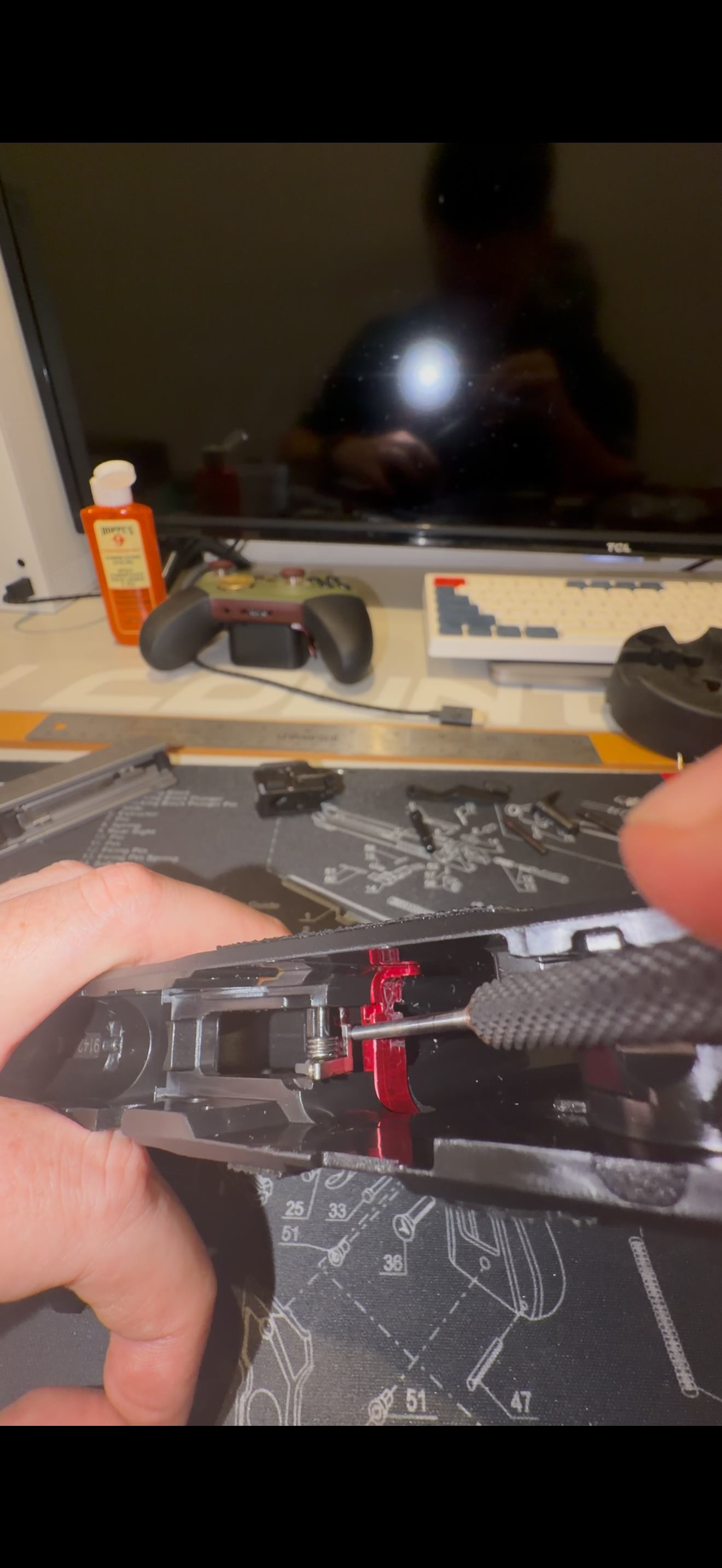

So I installed a Tyrant trigger on my hellcat pro. When I put everything back together I think i overlooked the "Magazine Blocking Lever" It wasn't seated in the right position. All the pins were put back and went to put the slide back on.
Now I can't dry fire or even take the slide off anymore.
Need help! How Can I remove the slide a different way than the normal. so I can reposition the blocking lever

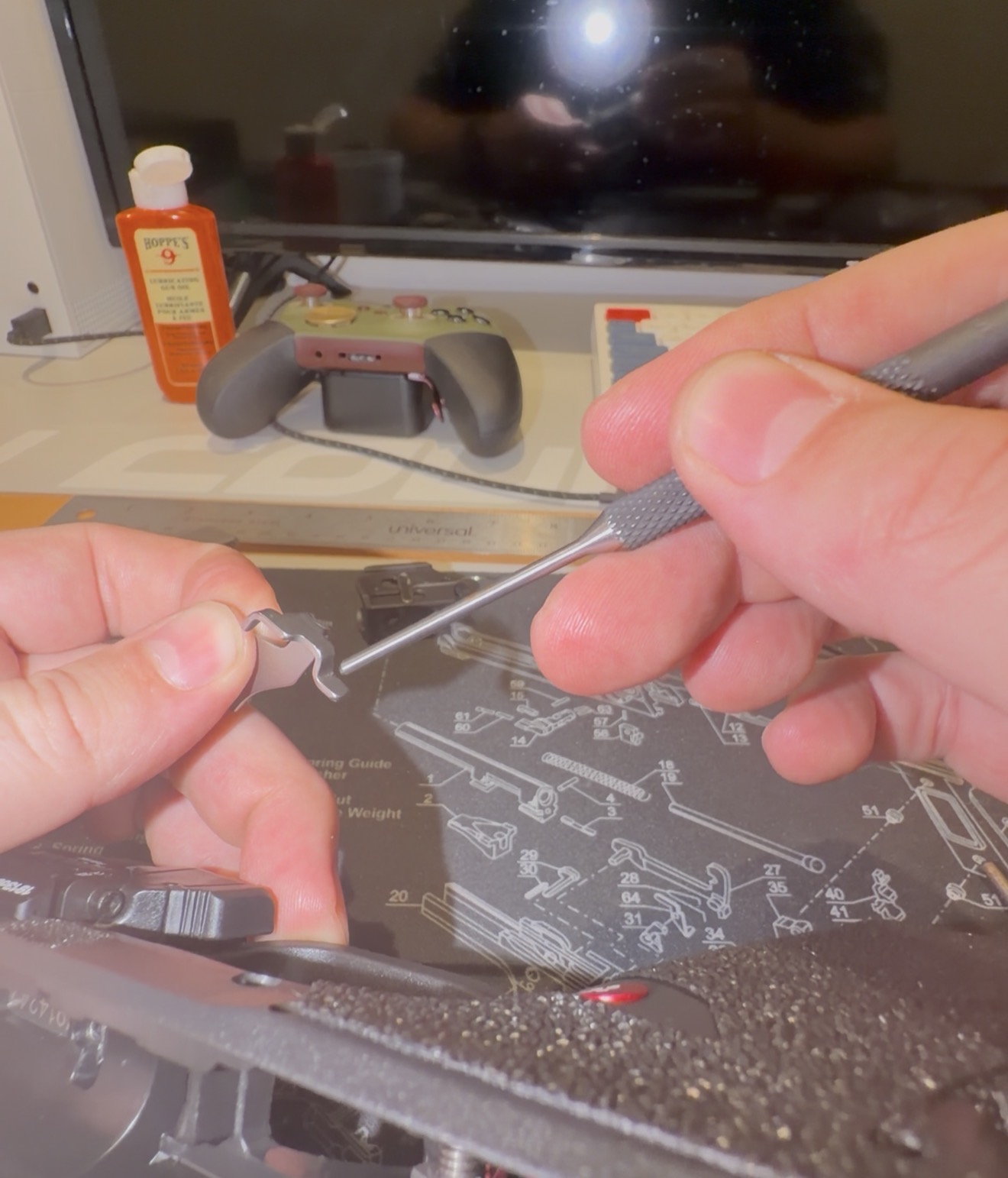

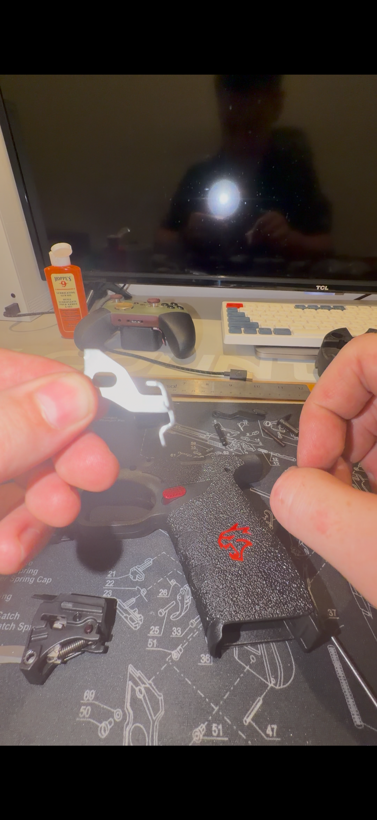

I installed the Hyde monarch trigger and slide wouldn’t rack and trigger wouldn’t fire. It’s because of this piece(first pic)….the tab(2nd pic) needs to sit under the bar(third pic) and then into the groove. I struggled for like an hour taking it apart and putting it back together 3 times because the trigger wouldn’t pull and the slide wouldn’t rack. Gotta love CA, all the install videos that piece shown is different because they aren’t from CA. Figured it out the hard way. Hope this helps any other people in CA struggling to reassemble.
