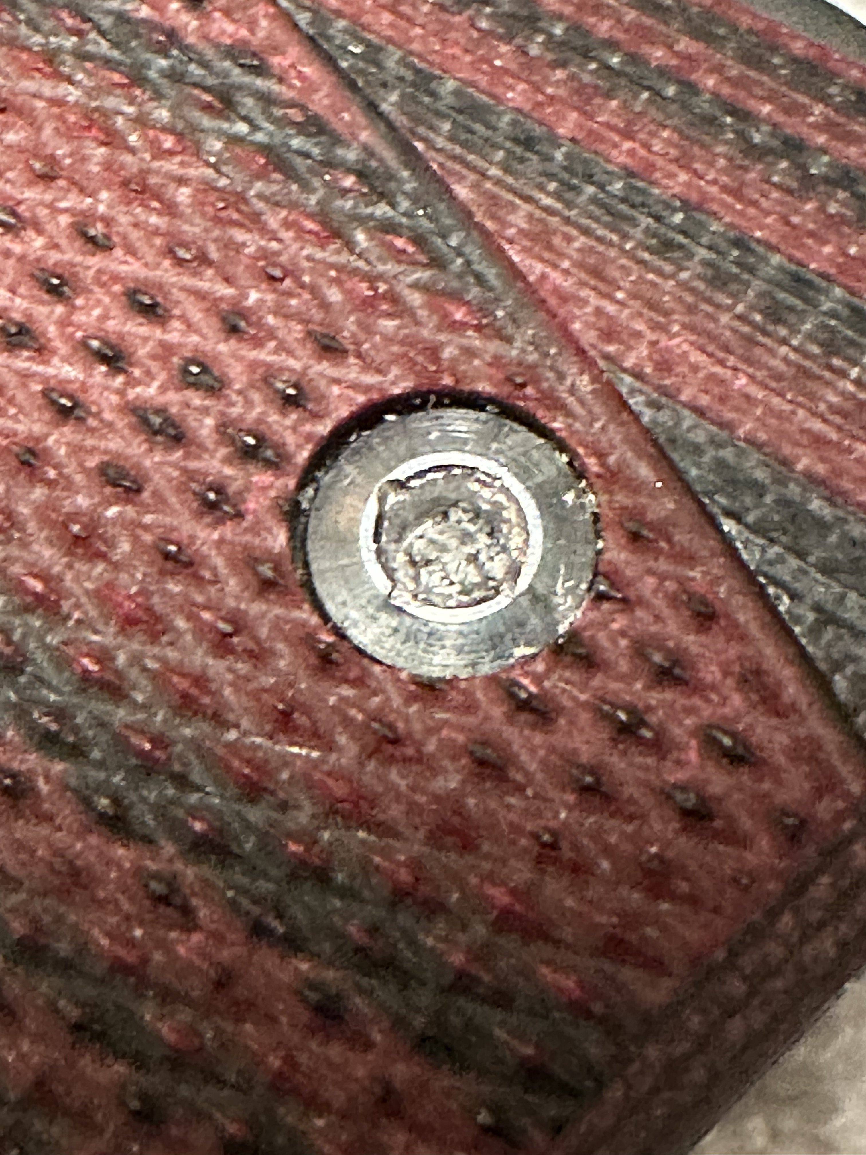

I’m seeking help for someone (at work) with a stripped Hex head 1911 grip screw…
No Loctite involved (evidently the others came of easily) but this one maybe had a gnarly socket hole to start with…
He has a Dremel with a cutting wheel and is willing to have a cut grip panel (to make a slot for a regular screwdriver) or replace his grips but I thought I’d ask here first.
Any other ideas? I thought about expoxy the allen wrench, but that things pretty rounded out now…

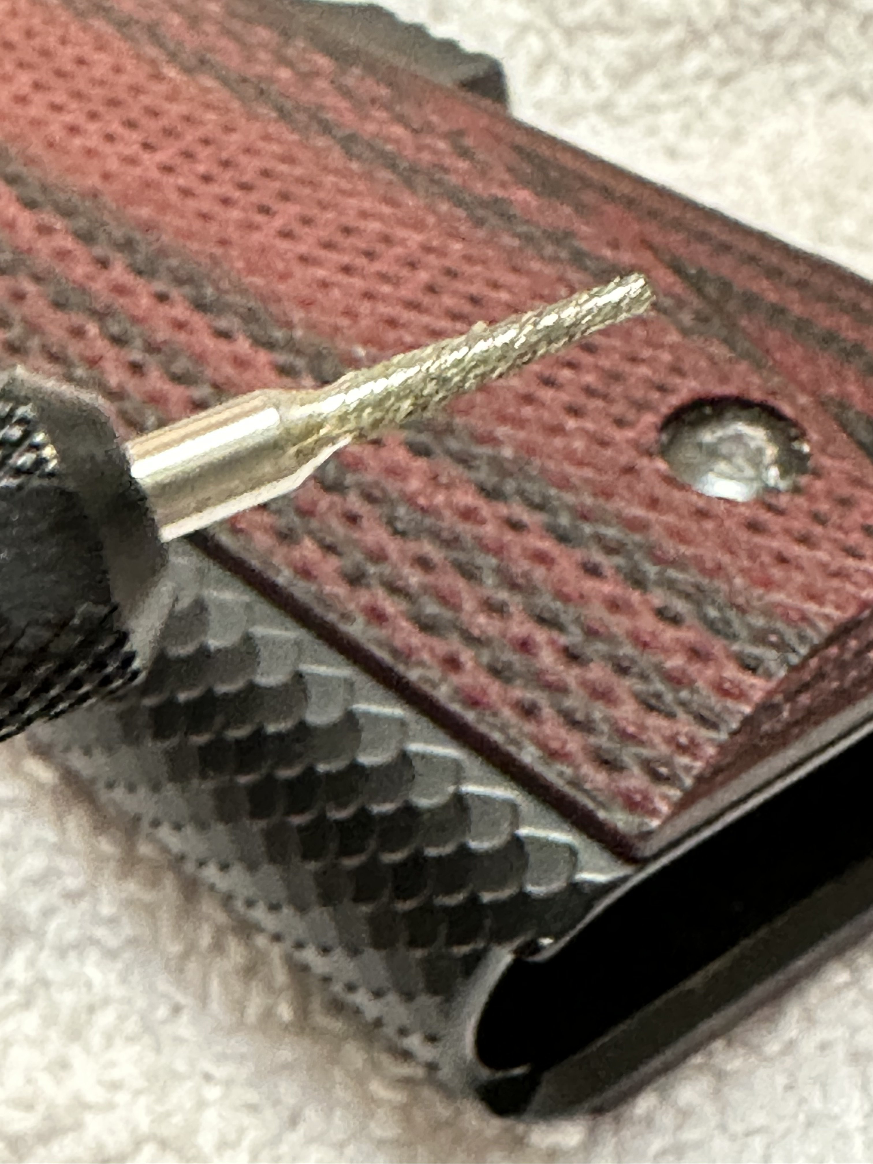

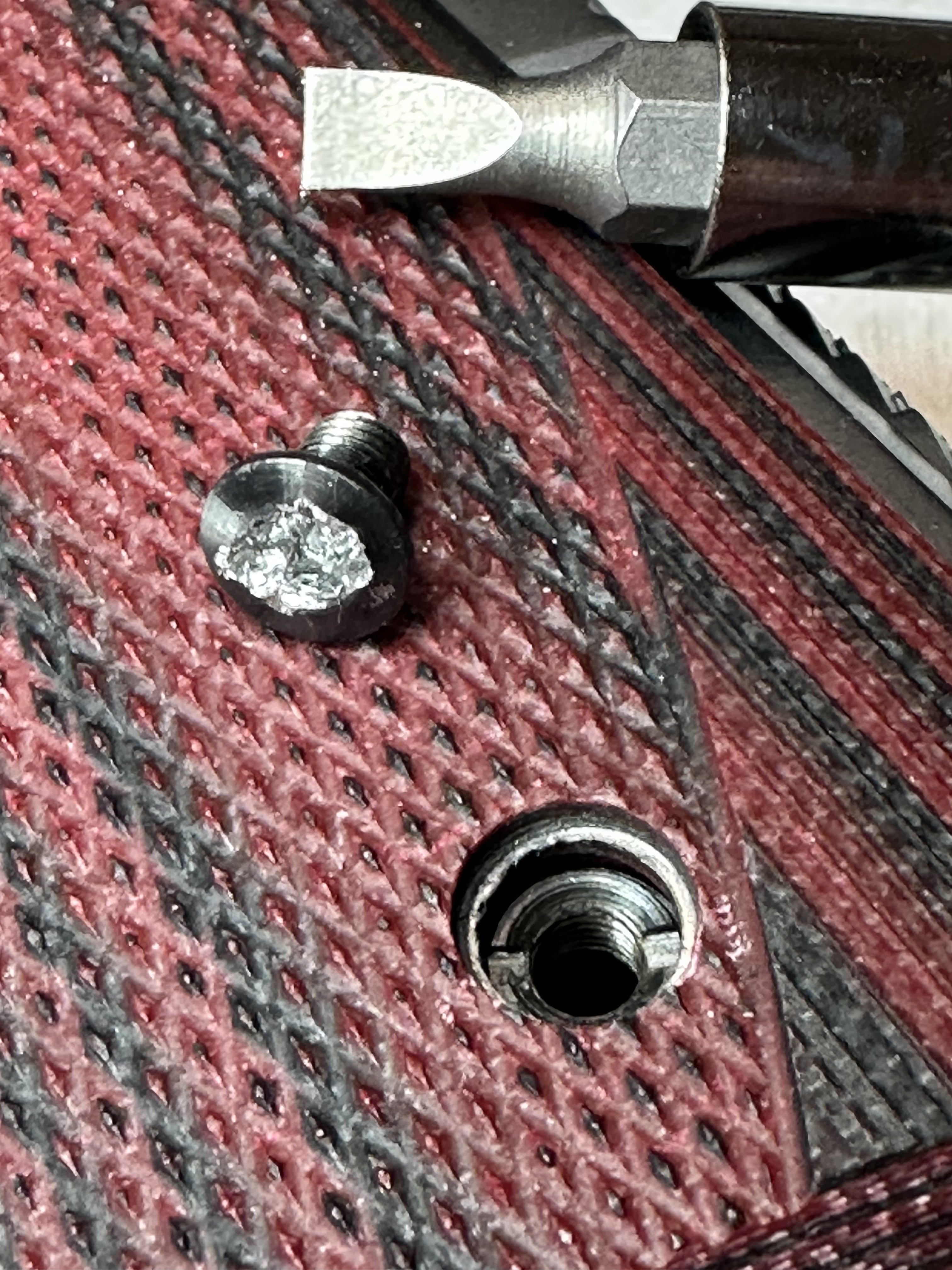

Dremel’d a slot on opposite sides of what was left of the hex/torx hole in the screw head. Turned out to be enough for a flathead screwdriver to fit a little ways down.
Didn’t think it was gonna give at first- screwdriver wanted to slide - then I beared down while turning and….felt it kinda ‘break’ loose. After that, she backed out with no pressure a’tall… so that’s one way that works.
See pics.
But, I need practice with that Dremel. I think thats some kinda engraving bit (Dremel brand) but was the smallest thing I could find to rout with. Thankfully I have that magnifying LED lamp that pivots all around.
