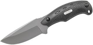

A.G. Russell knives HQ is about 15 minutes north from my house. Went up there this weekend, they've just now opened the store back up for shopping. They had some pretty good deals going this weekend. I could have easily spent several thousand dollars on their inventory..lol, however, I did find a couple of nice knives for better prices than I could find them online. I picked these two up.
First one is a Old Timer "Copperhead". I was very surprised to get this knife for $15.00. It has a really nice grip and a high quality sheath. I was even more surprised with how sharp it was out of the box, no need to sharpen it, which to be honest, I was a bit disappointed...lol, but pleasantly so.
