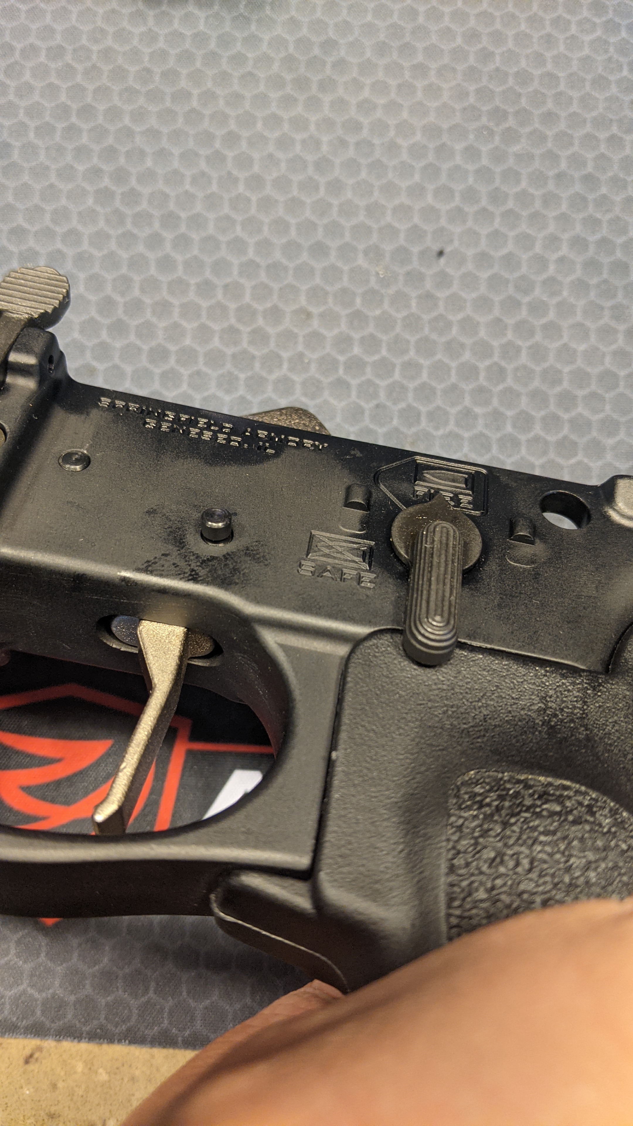

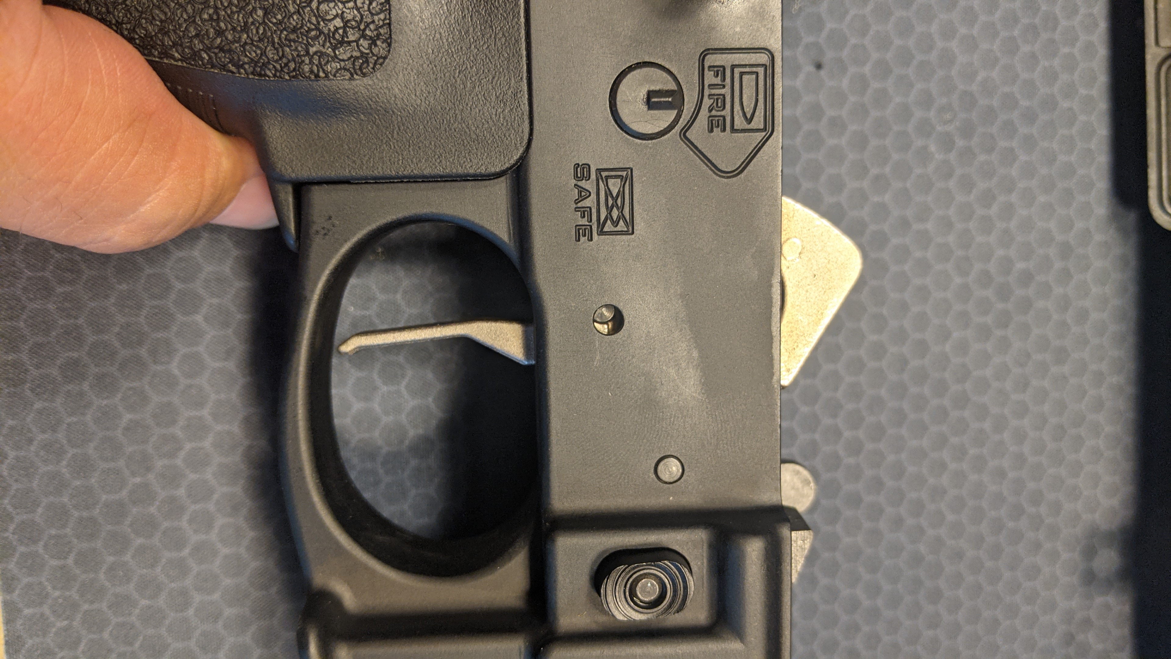

thats the video i was watching along with reading the manual.
Buy a pair of anti walk pins like the ones that come with one piece trigger assemblies.Yes, the safety is not engaged lol. I can definitely see an issue with the lower after taking a closer look.
Not sure how that happened, but would explain why it wouldn't fire at the range.

Actually had a buddy of mine look at it before I sent it off to springfield at his request and he made me buy some anti walk pins and put them in for me. Working like a charm. Thank you!!Buy a pair of anti walk pins like the ones that come with one piece trigger assemblies.
