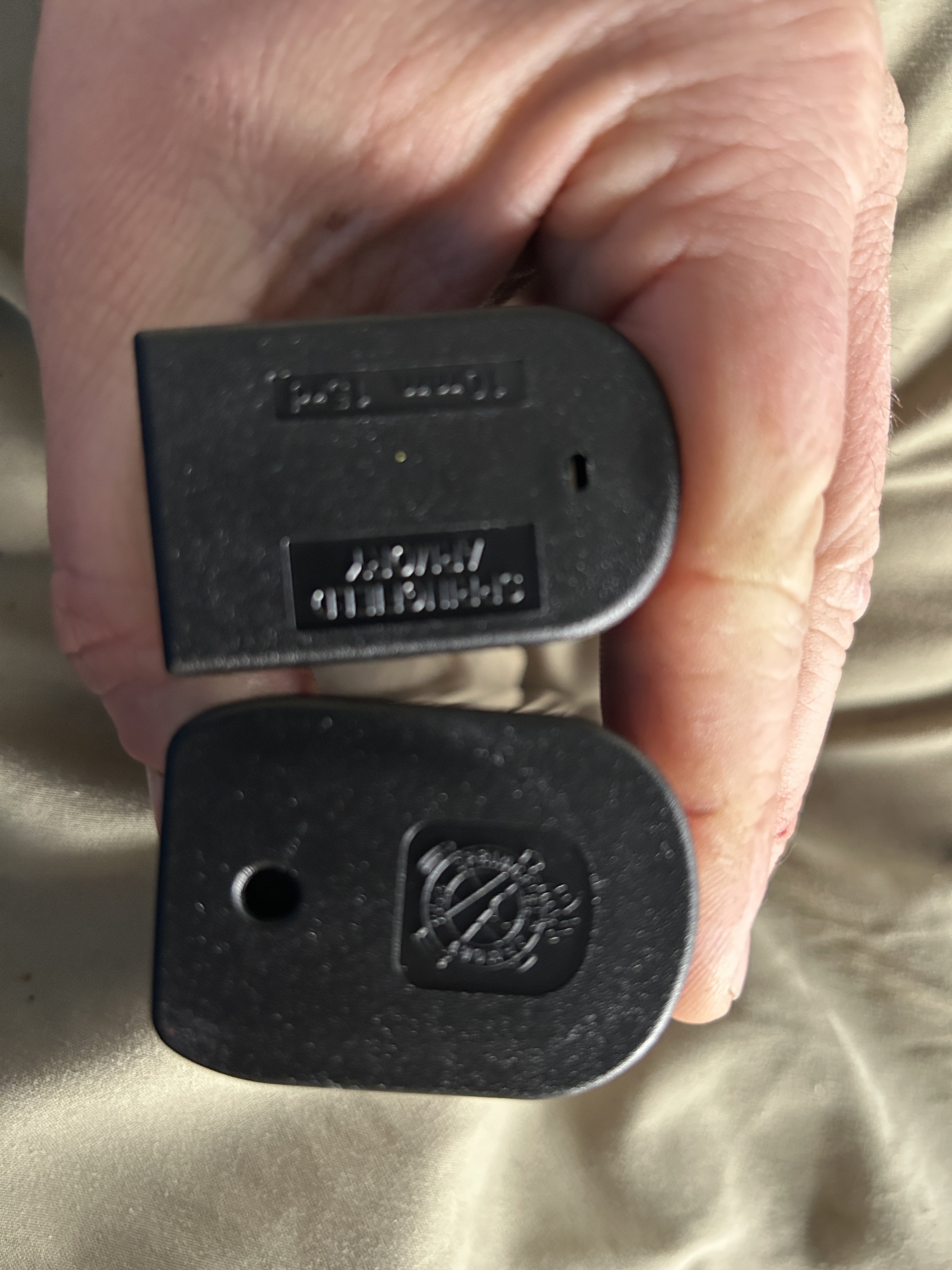

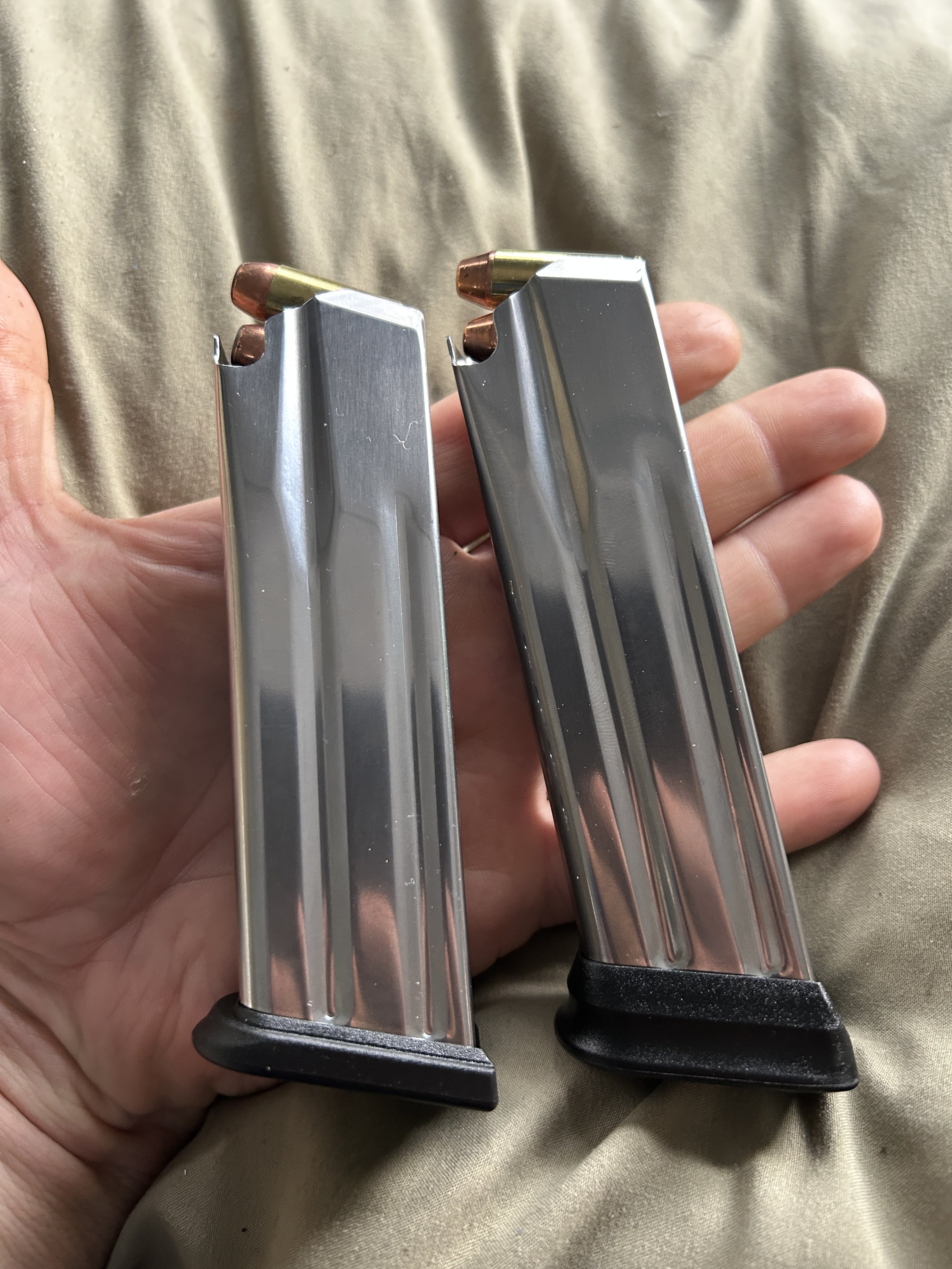

Here are some pics, one of left is the kind not working. Both marked 10mm.
The one on the right matches my XDm Elite mags.
While the metal part of the mag looks the same, the base plate is totally different
As to my knowledge SA only made one other 10mm and that was a single ramp 8 shot Ronin.
I am thinking those are after market mags and the base plate is wrong?
Maybe you can order just the correct base plates?
I'm betting both fit your pistol. The mag on the right has an extended baseplate it also should hold one more round than the mag on the left. If you want to keep the mag well then you're going to need to use your thumb to seat the mag.
My 3.8" compact came with two short mags just like that. The +1 extended mag I could seat with my palm like normal the short base plate I needed to give it some ummph with my thumb.
