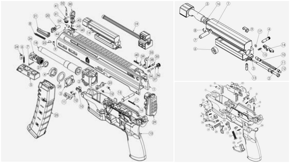

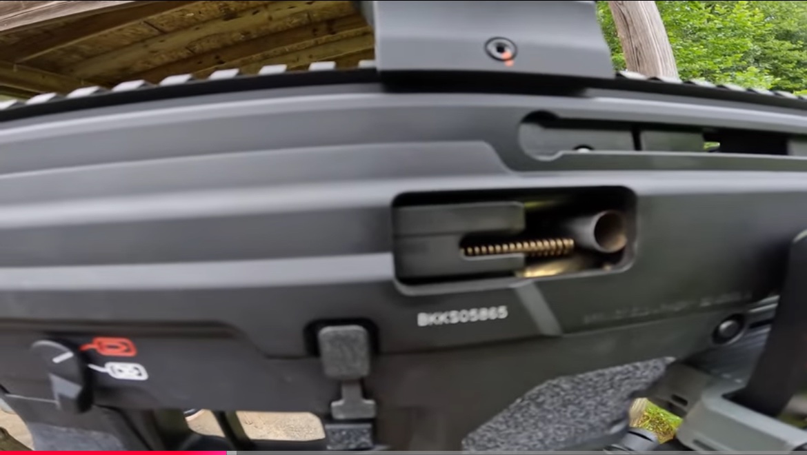

Well, just in case you don’t believe it here’s a picture! I’ll also put a diagram of the bolt. There’s no pin that holds in the extractor. The extractor has to break for the spring to come out. in order for the extractor to break the metal has to be inferior.
Not saying I don't believe it. Just saying I didn't see some of the parts while just examining the bolt. If you're saying the extractor has to break for the spring to come out and a pin to drop, that makes sense that I couldn't see it.
Sorry if I sounded rude. I also had a hard time figuring out what was happening. I had to dig to find a pictures of the bolt diagram to understand how the extractor was contained. Just sad that I had high hopes for this product and got one of the bad apples. Will update after I shoot it.
Makes me hopeful they will figure this out. I work in the industrial field and have seen bad batches of metal before. Hope that’s all it was!

Your picture above has your serial number in the 5000’s. Mine is 2000’s.
