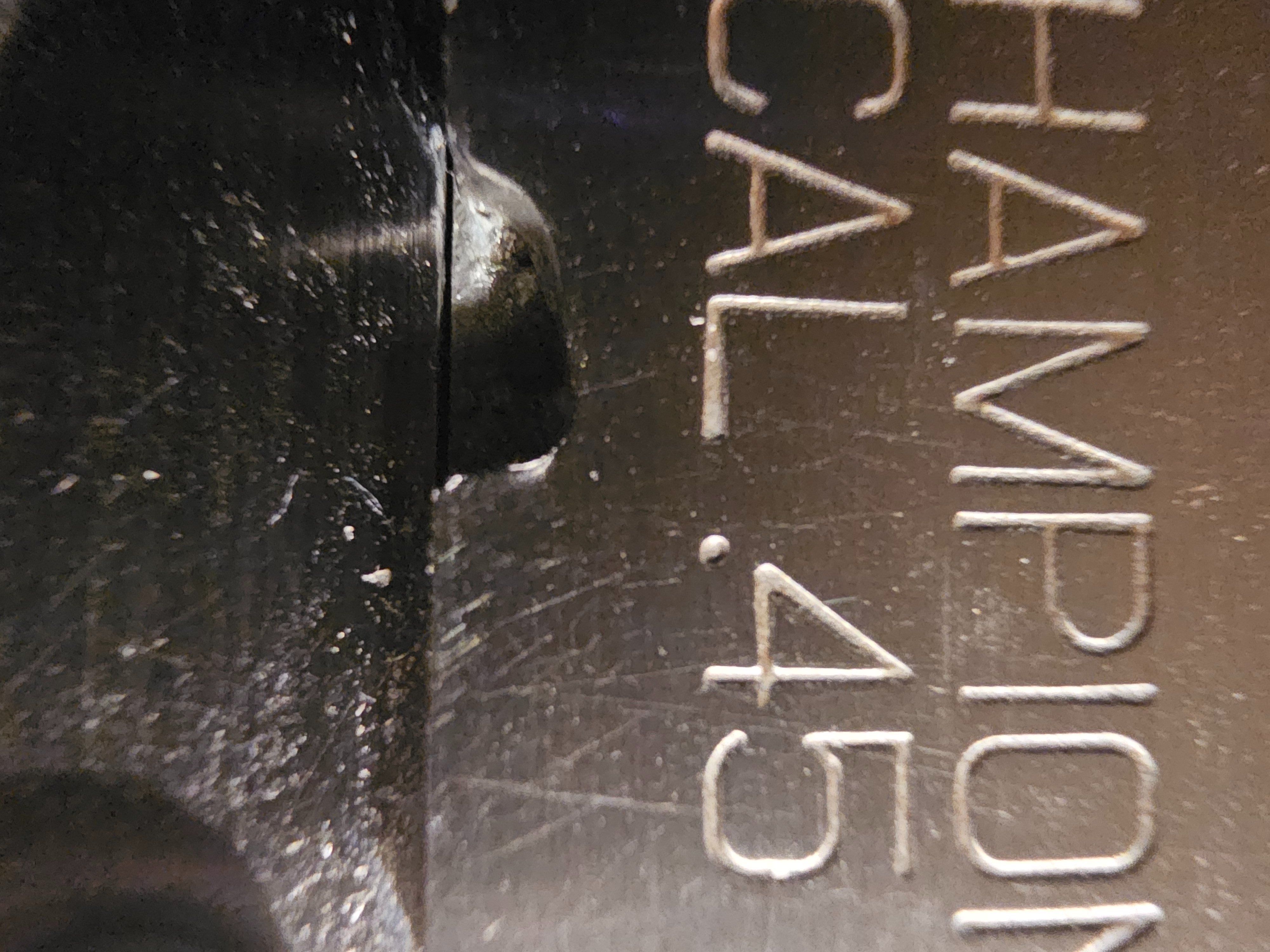

My Ronin (9mm 5") shows some light peening on the slide stop notch. Very slight but it can be felt.
Questions: Is this common? Causes? Is it self limiting? Leave it alone or address? Lightly tap raised material back flat or stone and touch up?
I have had one range session with this one but it was purchased used and it may have been there although I don't think so.
I put a 12# Recoil spring in it: Too much spring causing it to hit the stop too hard on last shot?
It had a few failures to lock on the lighter loads.
I was using the slide stop to release the slide on a new loaded magazine. I know better now and will pull back the slide and release (slingshot?) in the future.
Loads ranged from mils Blaser Brass 124 grain to +P 124 grain Gold dots. All factory loads
Observations / advice pleaseView attachment 52306
Same with my SA Champion. Original slidestop didn't lock back half the time. Replaced it with Wilson Bullet proof. Locked back 100 percent, but it was also peening the notch. Someone suggested light stoning on end of slidestop so it would mate flat when locking back. It helped but I didn't want to overdo it. It's been absolutely reliable ever since.
