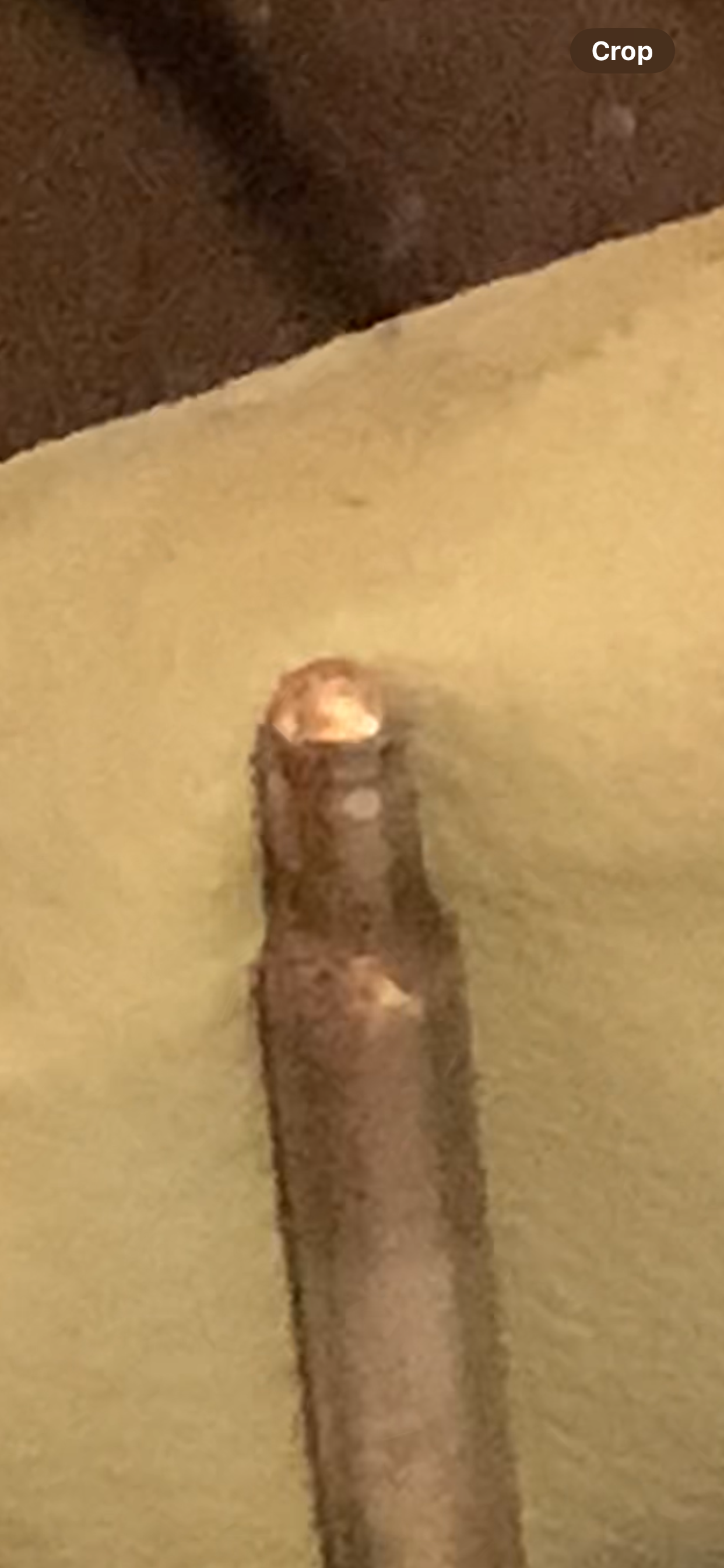

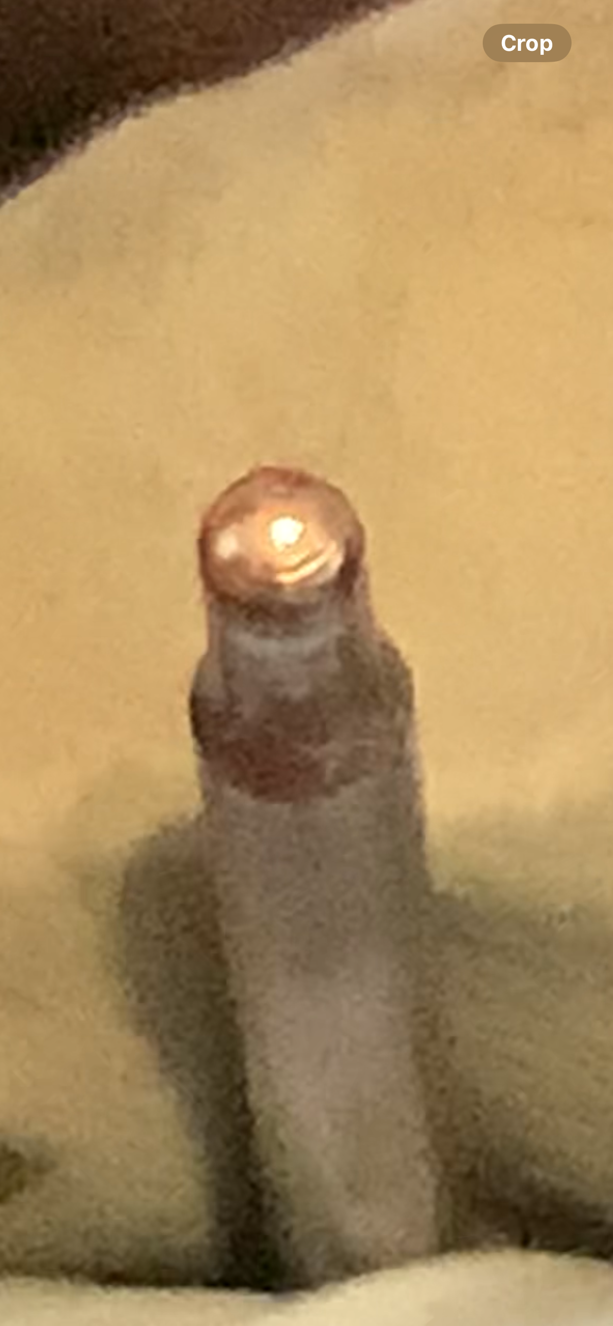

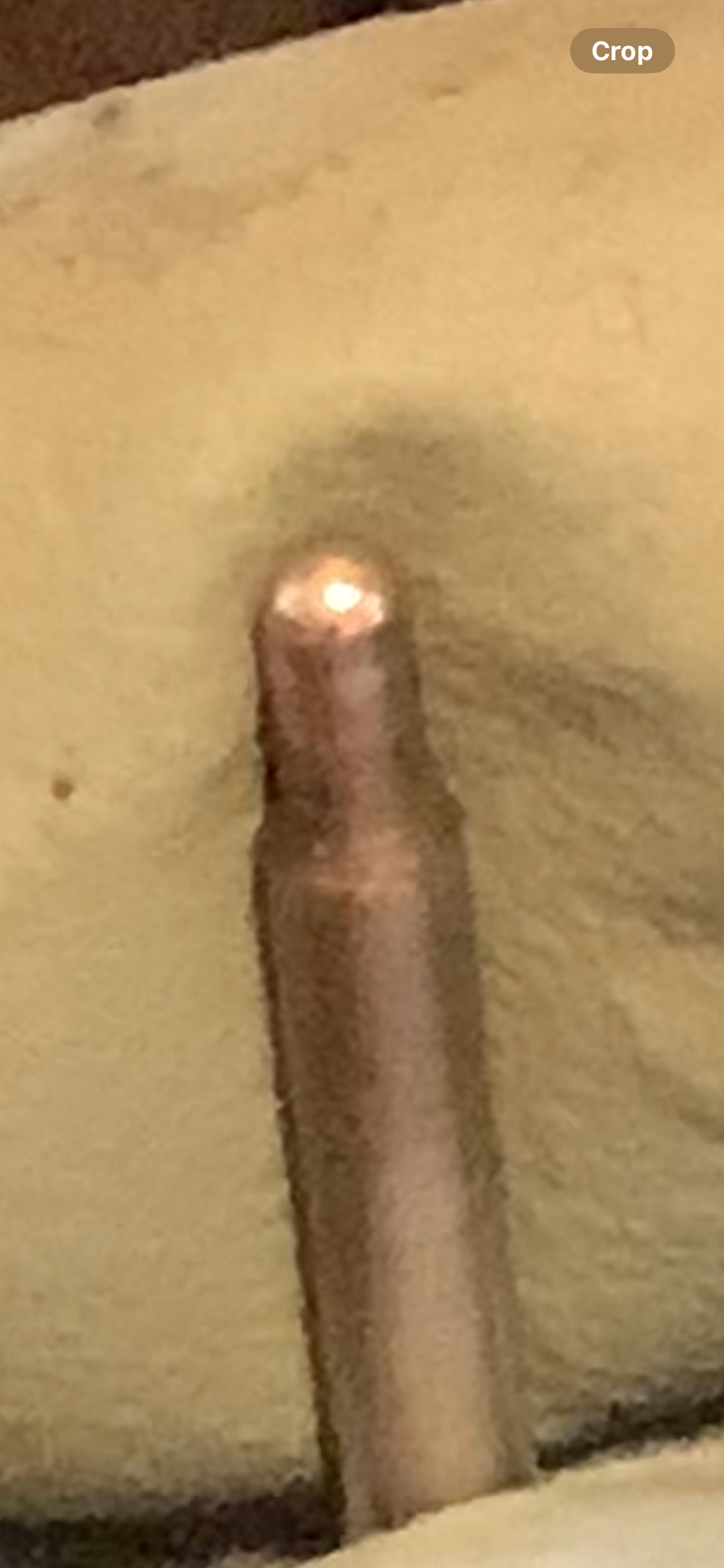

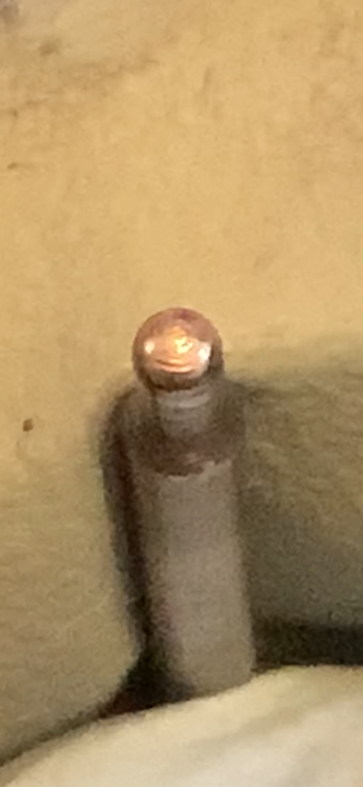

So i have been taking my .308 out to shoot finally, and after sending a lot of rounds through I decided to clean it and remembered what was happening.
I am using a 7.62 Ventum for a suppressor and i did adjust the gas block.
Anyways, I took apart the BCG and remembered that it did blow some primers and had a few jams because of it. So i took a close look at firing pin and it seems to have a small gash on top of it.
I was using cheaper ammo some Igman 7.62x51 and other stuff. Oh and PMC bronze .308 all in 147g manufactured ammo
I also shot PMC X-tac and Federal Premium Gold Medal both 168g they shot cleaner and tighter as expected and i didn’t seem to have any issues that i can recall with that stuff
I will attach pictures to this so somebody with better knowledge can chime in, if they so kindly will do.
I can see like a small gash on the top of the firing pin and it looks maybe mushroomed a or warped a small bit?
Sorry the point of this post is that am i ok to continue using this pin or should look for a new one? I will inspect the bolt face and firing pin hole as well.
Firing pins are inexpensive
Buy a new one

Quick question, I don’t know much about the parts for the AR10 and or DPMS .308 gas rifles. I believe I read that Springfield doesn’t sell spare parts for these rifles specifically the BCG parts.
So my question Is, what kind of firing pin should I buy? Just look for a DPMS pattern firing pin or are they specific to the rifles?
I guess I will just use a caliper on my firing pin and go from there but I appreciate the reply.

Any standard dpms compatible Ar-10 pin should work. Prob like $15-20
Shipping may be more than the part
