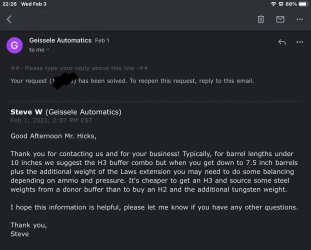

6. Geissele Super 42 H-2 buffer/braided spring combo with additional titanium weight. I have an email from Geissele saying to go with the H-3 out of the gate for my set-up. Reference attachment

With the added back pressure from the suppressor you would be wise to take Geissele's advice and go with the H3 to slow the reciprocating mass down for less felt recoil and a more reliable cycling of the bolt.
