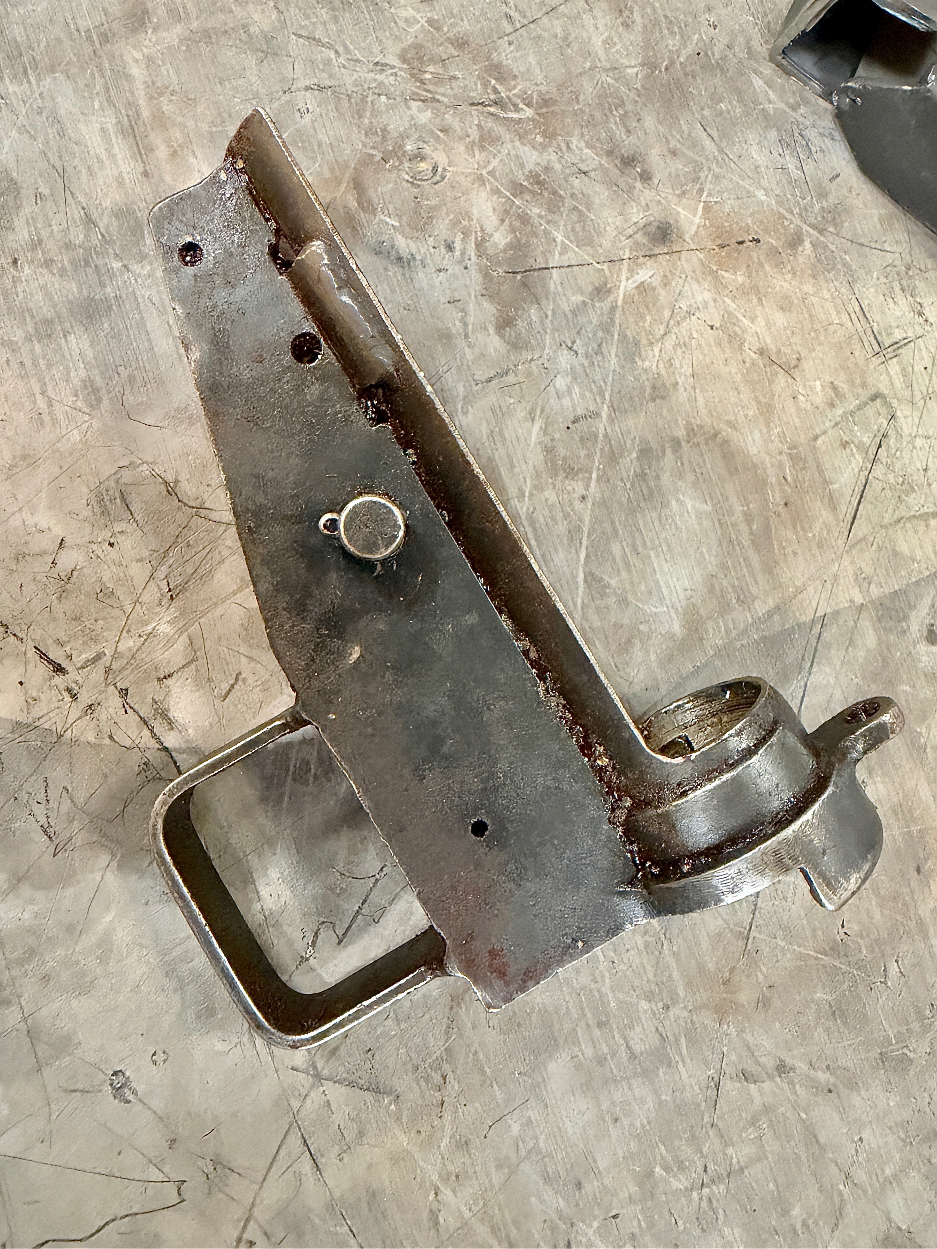

Ok, here we have the lower receiver which is in great condition considering this is from World War II.

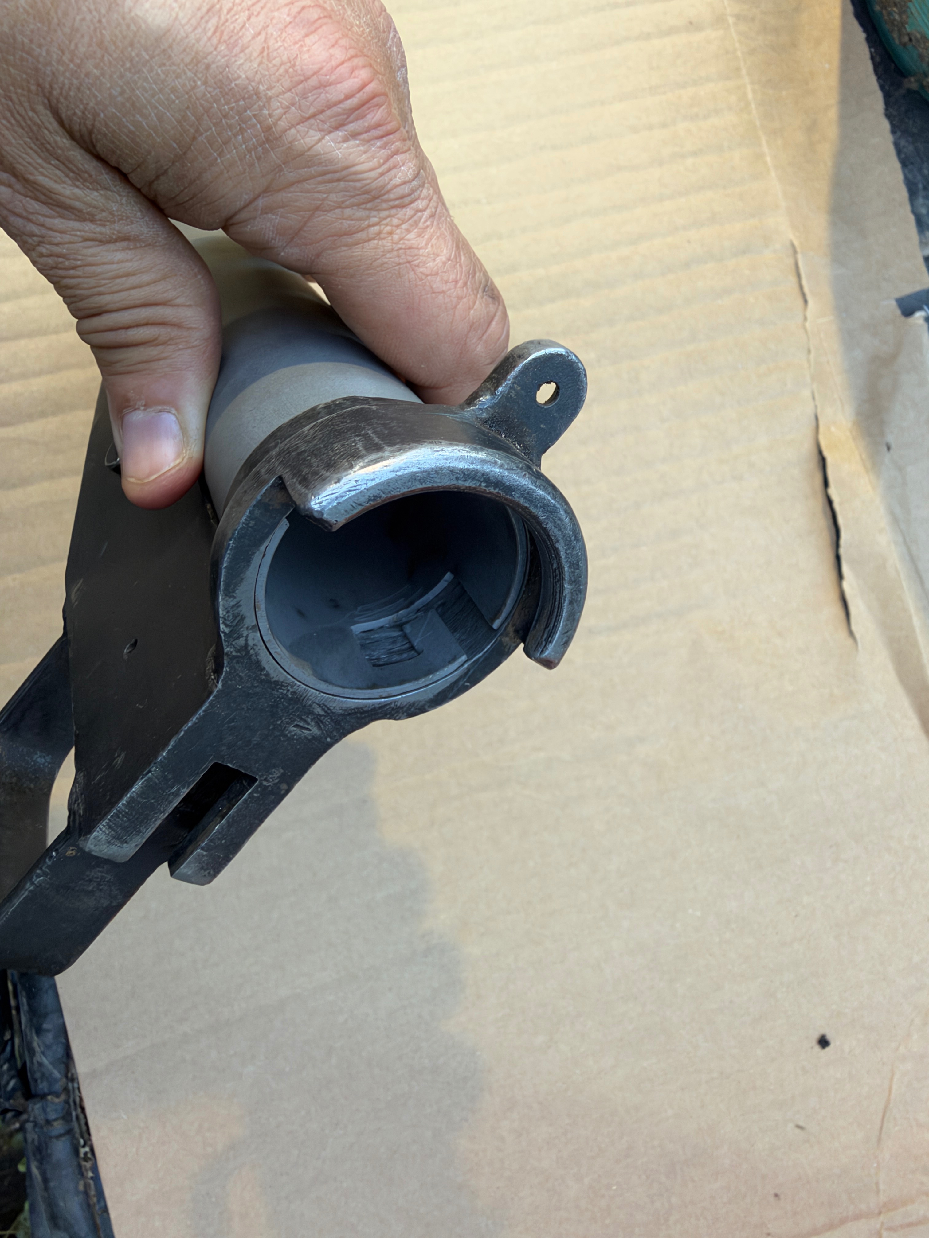

My problem is that part of the original receiver tube that has been de-milled is still welded to the lower/trigger housing. I need to figure out how to take them apart.
Well, it looks like the proper tool for this job is gonna be a Dremel or I like to call it the Drem-all because it’s usually the solution for everything gunsmithing wise.

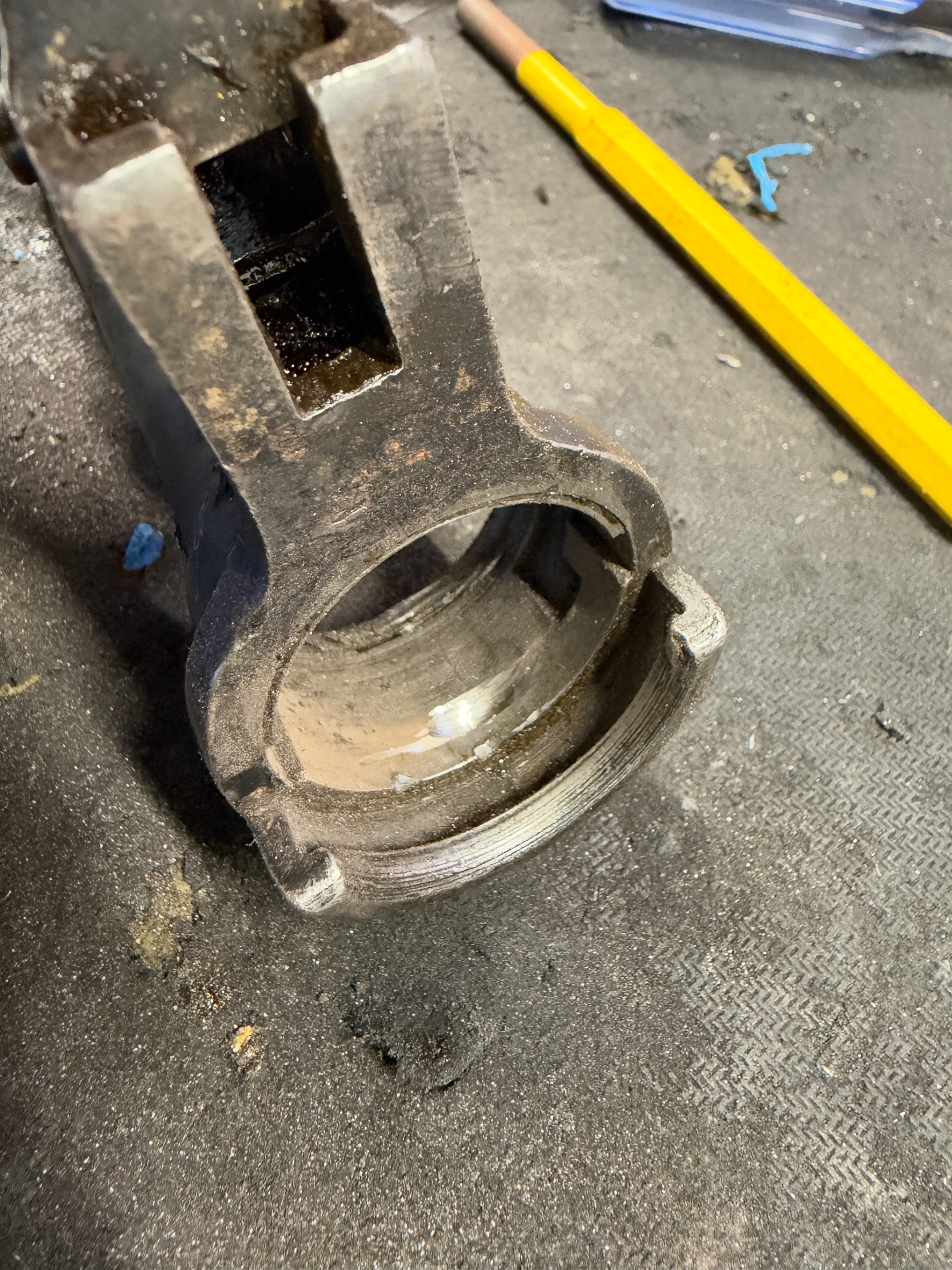

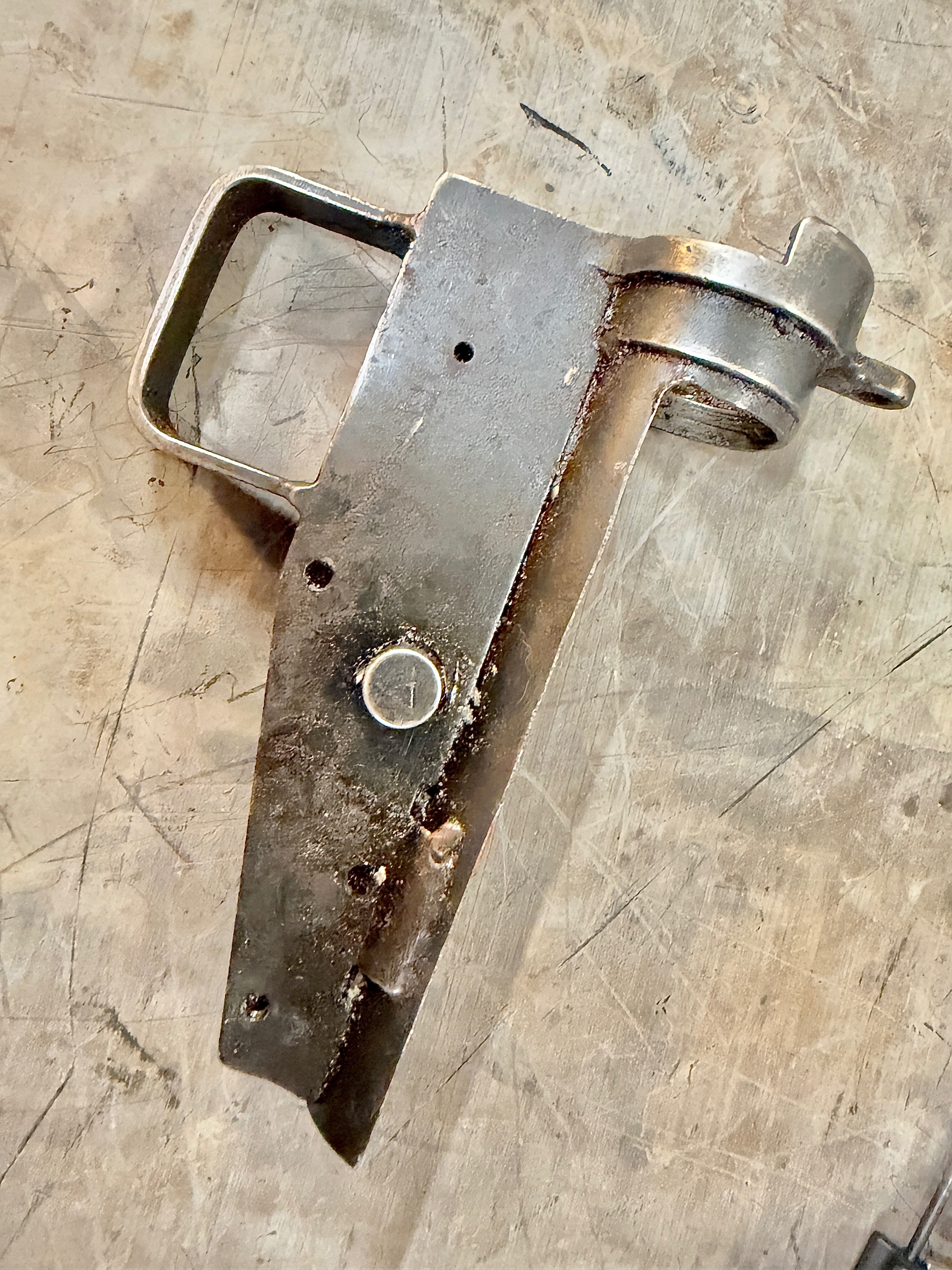

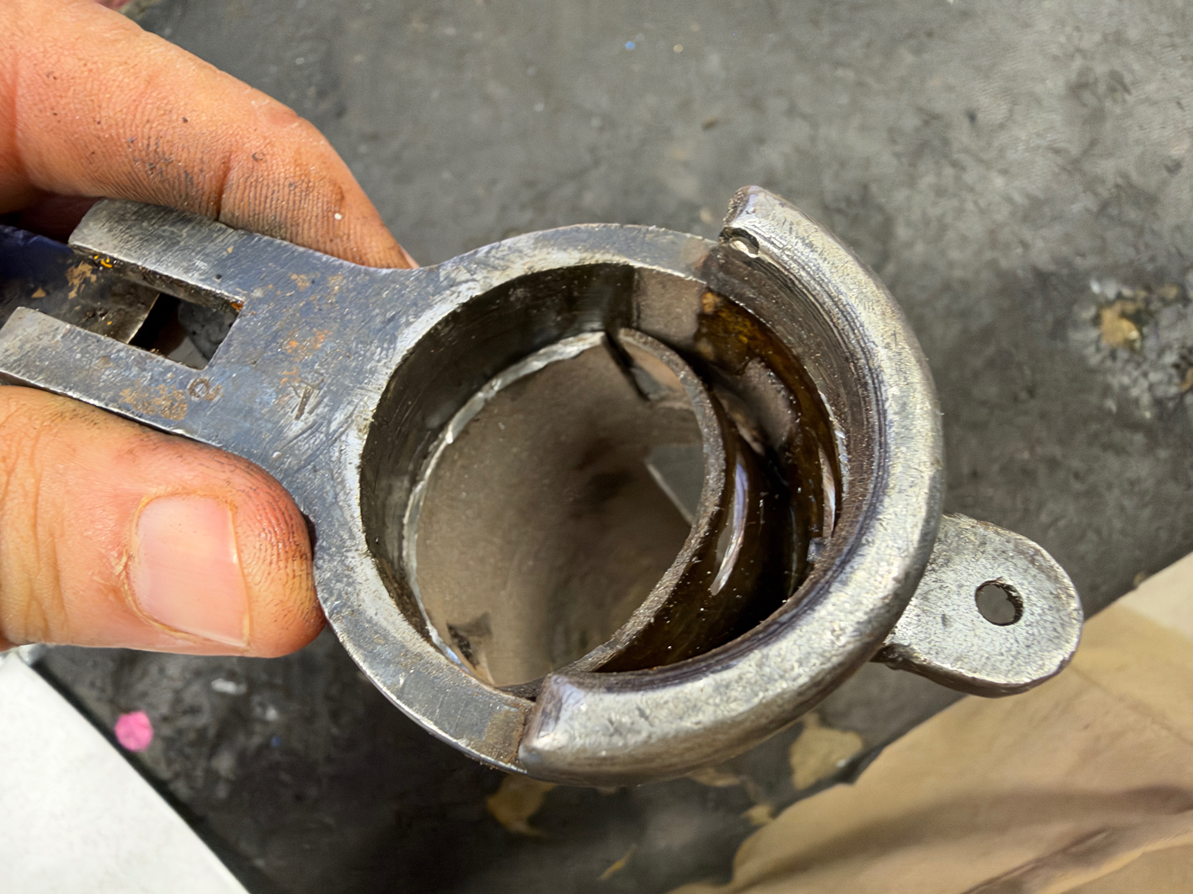

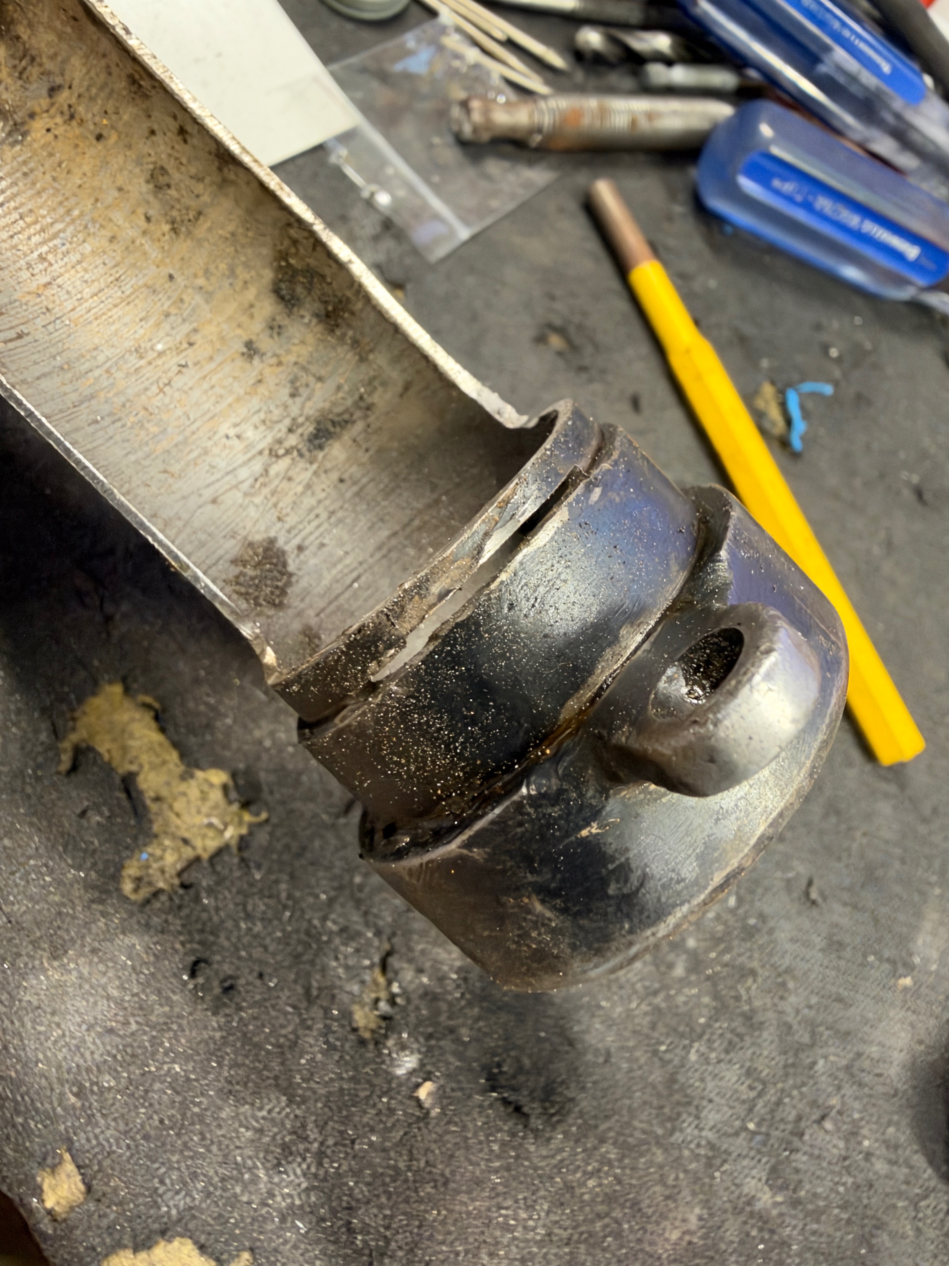

Ahhh I see you hidden weld. Unfortunately, I couldn’t get at it from the outside, so I had to get creative and grind it out from the inside

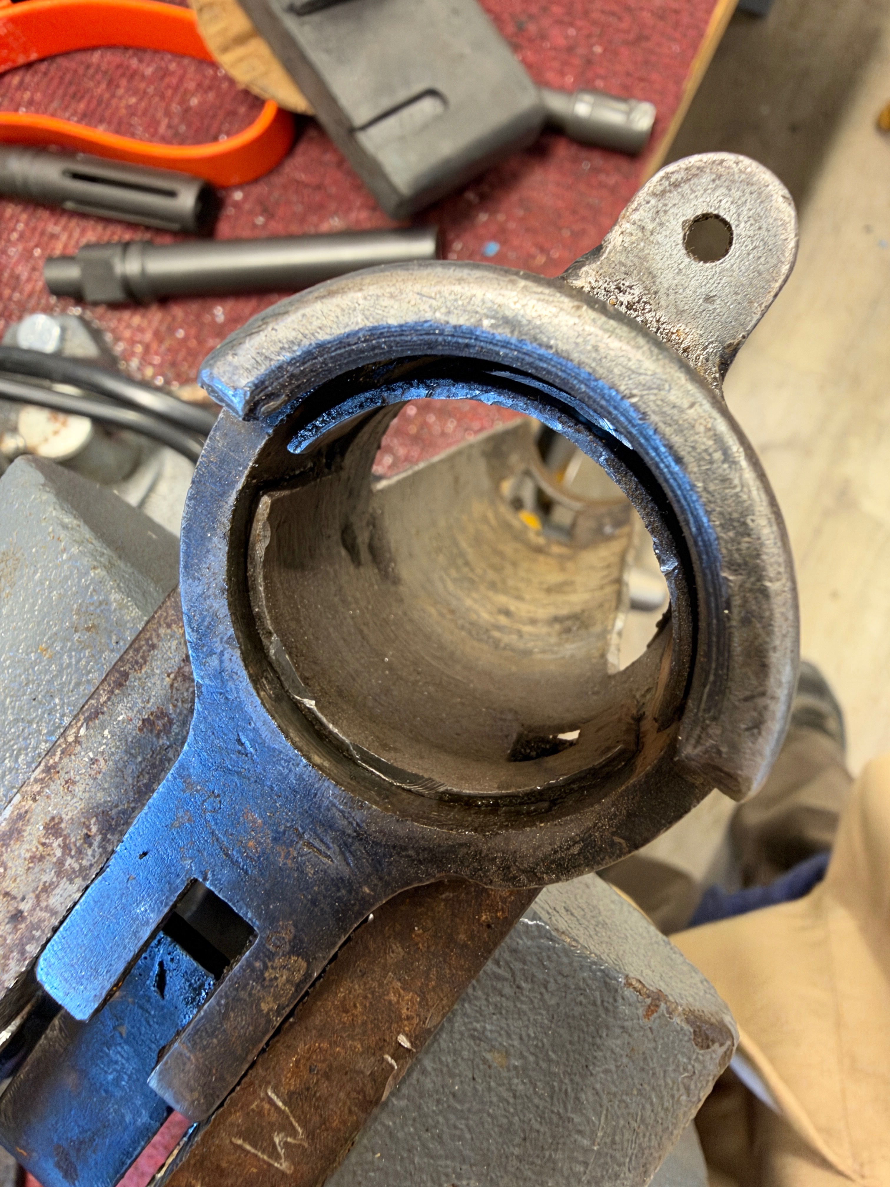

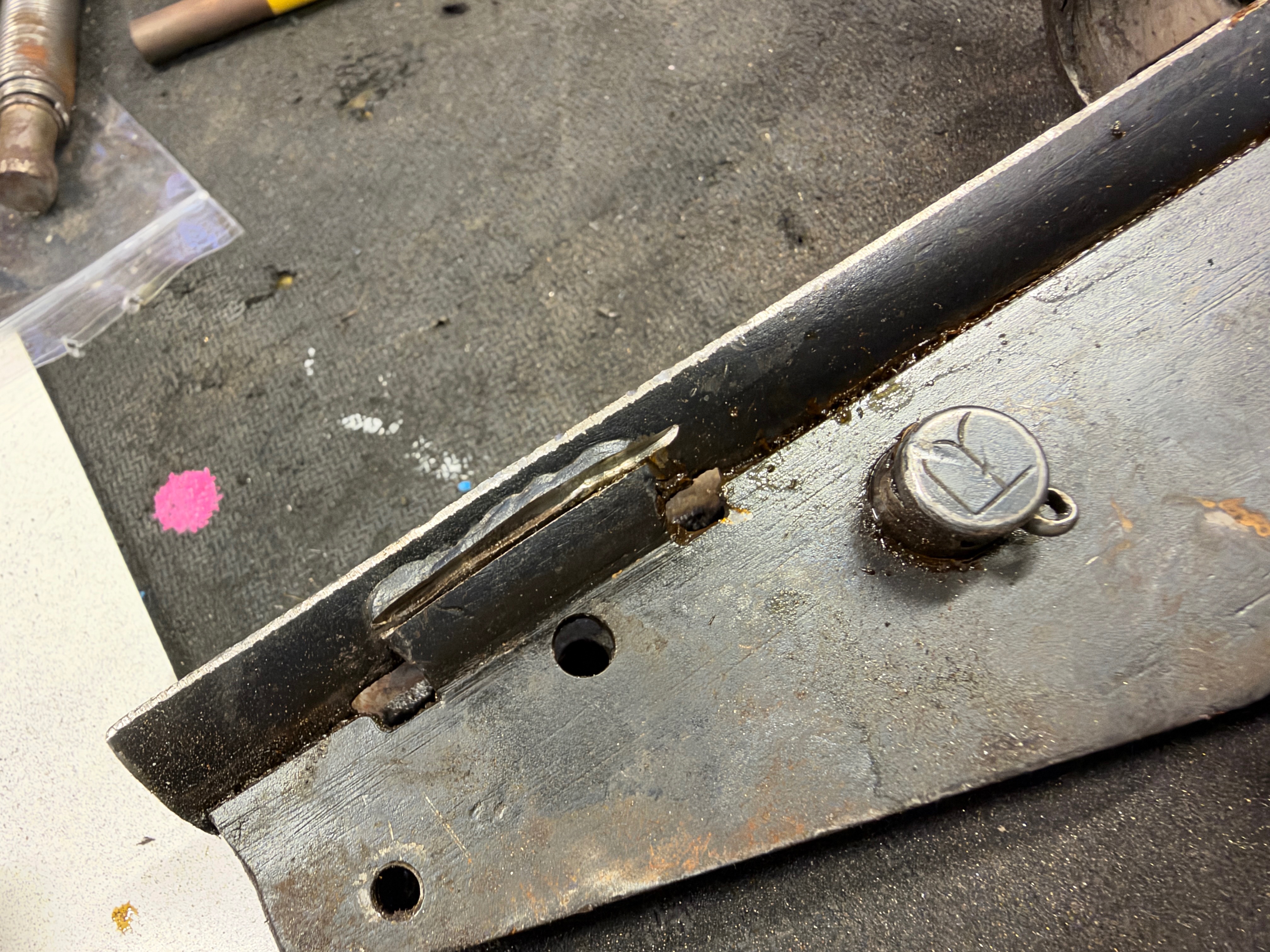

The next issue is, I have to remove the welds from the lower receiver tabs. Now here’s where you kind of gotta be careful because I need to reuse those tabs and then put another weld bead where the originals are to attach my new receiver tube to the lower, just like it was done in World War II
Then I’ve gotta remove the welds on the back end of the tube. So let’s just grind/cut those out.

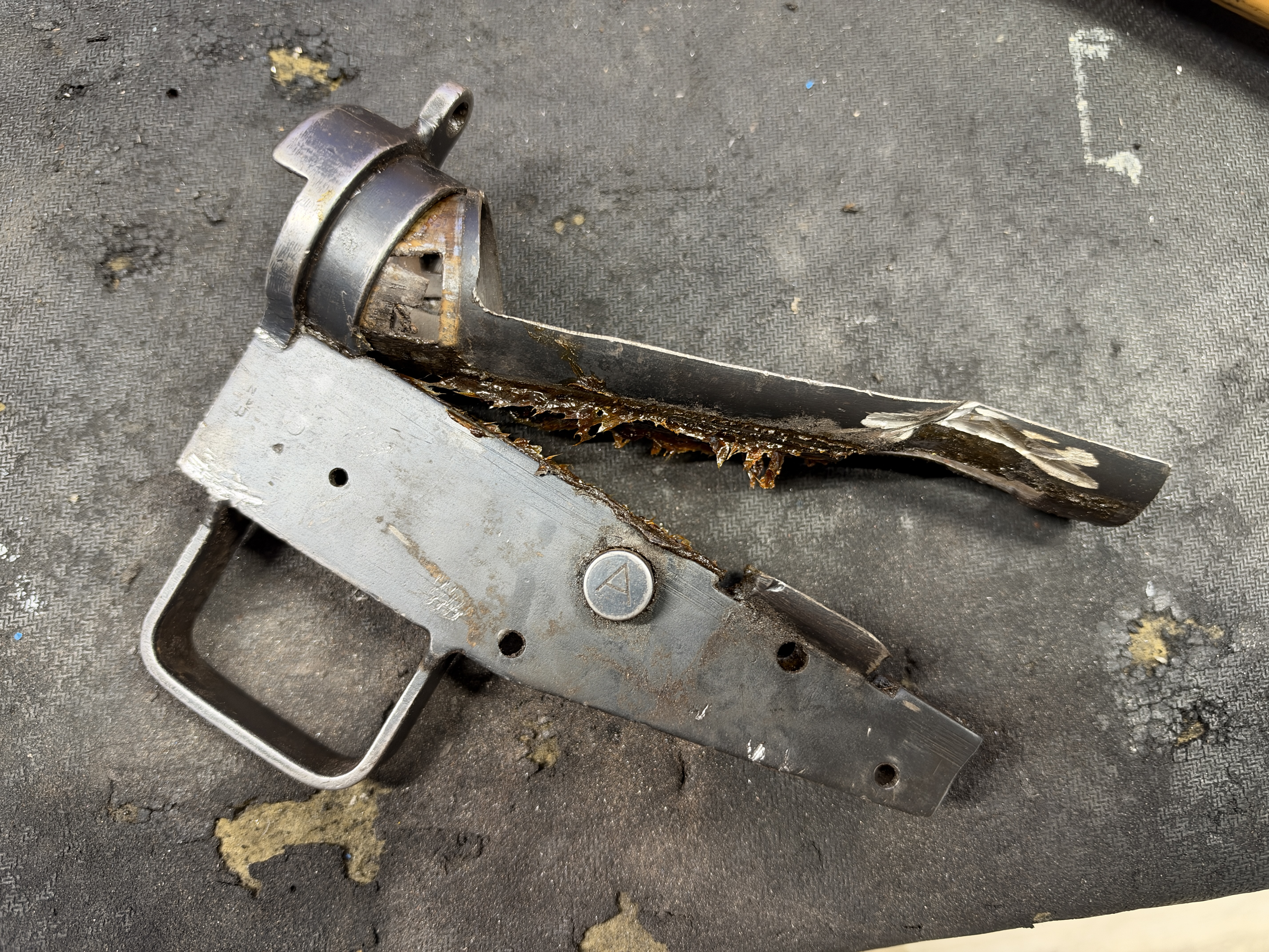

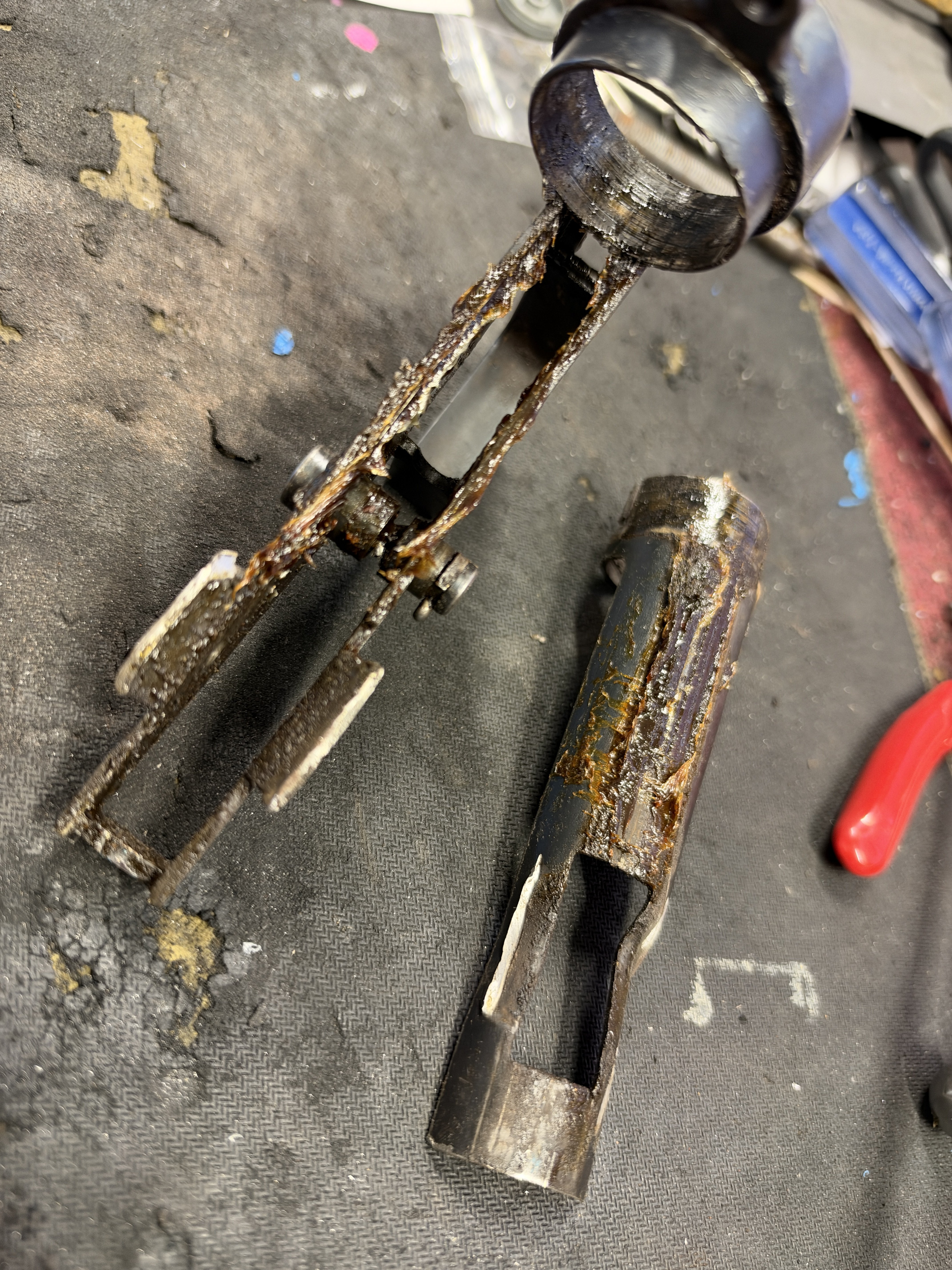

All right, I’m making progress and all the welds are broke, but it is stubbornly stuck in place
There we go, a little brute strength and ignorance. the ball peen hammer like the dreml overcomes everything

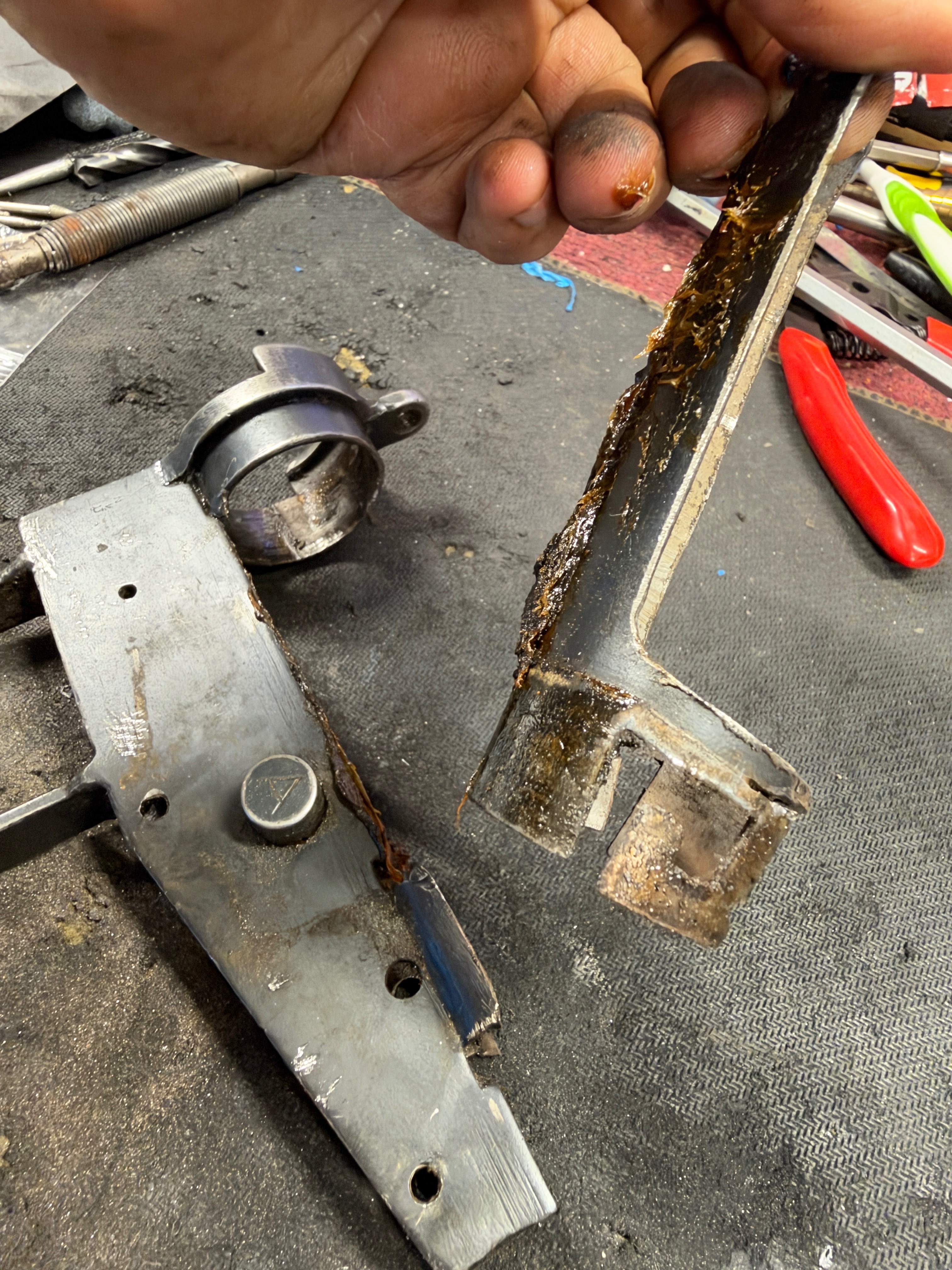

Oh, here’s the part where we discovered there was another secret weld on the bottom of the tube that we couldn’t get to but since it was a small tack spot weld it eventually broke as well
There you go. I am the master of everything. This STEN receiver finally tapped out and she gave up her secrets.
Now, while this looks bad, it actually isn’t. The Cosmoline protected all the metal really well. And other than being really dirty, she is in fantastic condition considering her age and use.

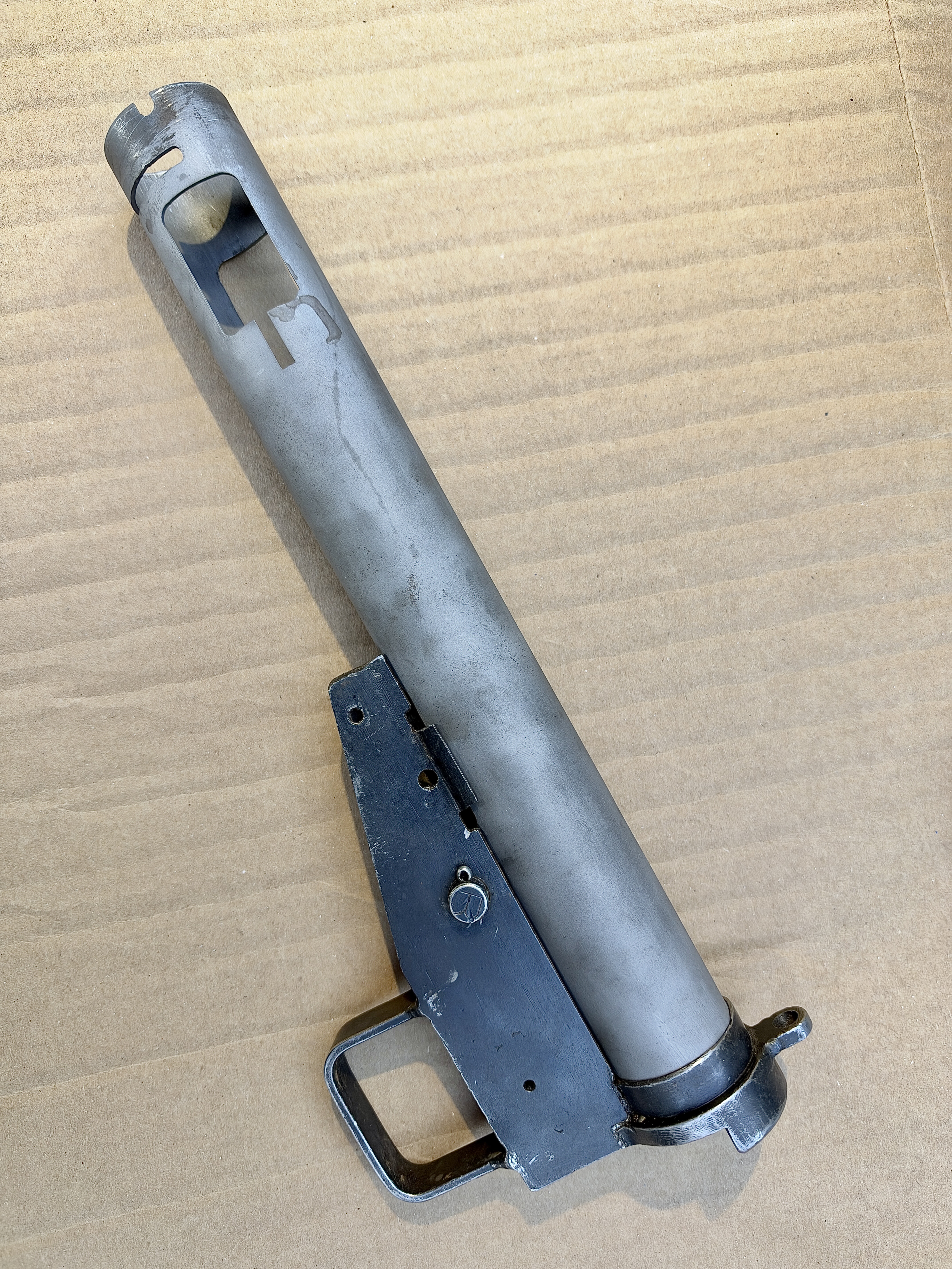

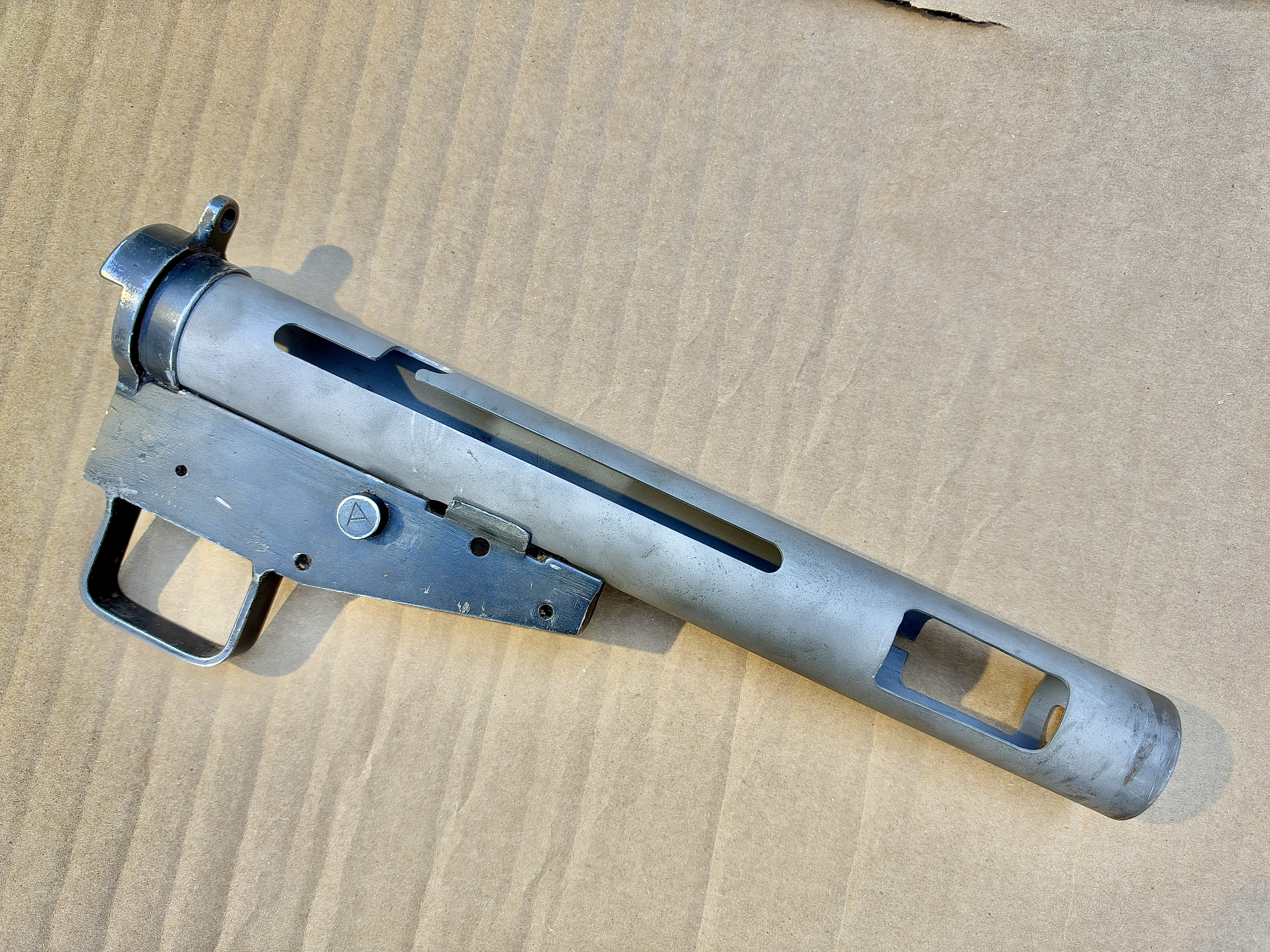

Now I take my receiver tube that I machined, and I must shove it in the lower receiver/trigger housing and see how she fits.
Wow, it’s amazing how quickly it almost looks like a STEN again. And see here, you kind of see why I am talking about that the trigger housing, the texture of the metal doesn’t really match the texture of the receiver tube. So after I fit everything, I might as well just blast everything and make everything match and look like it came out of the factory that way.
