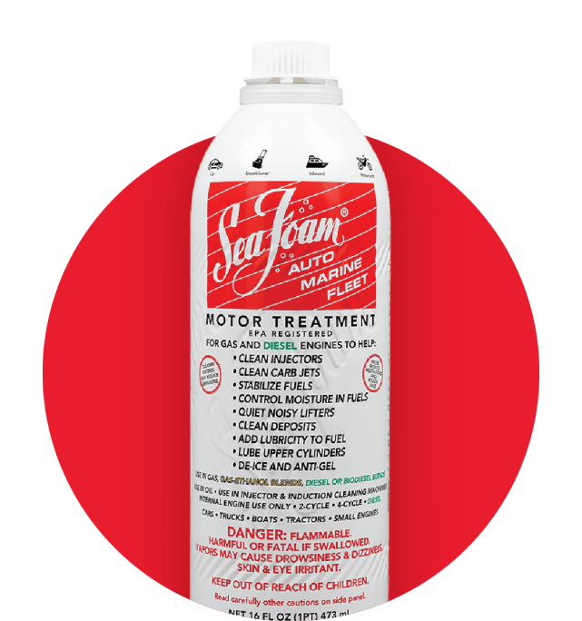

Suggestion: Seafoam I add a cup to two gallons of unleaded gas, NO Alcohol. My chainsaws can sit for 2 years and still start. Another hint: Fogging oil. Pull spark plugs and spray into the cylinder. It limits ring and cylinder wear on startup after storage.
