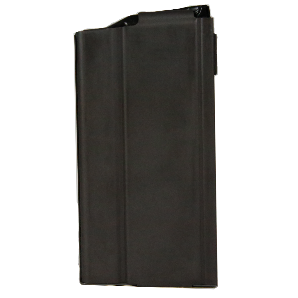

I would get some extra mags to test the issue with another mag and to have enough spares for your usage needs.
Are you limited to a certain mag capacity where you live?
