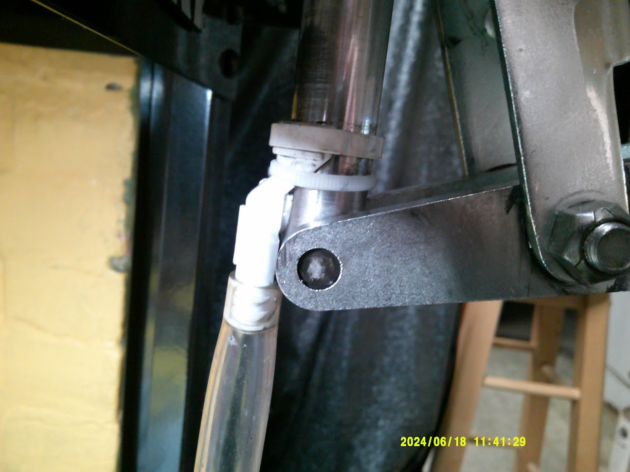

my Lee Pro-4000 was spitting out old primers from the press, onto the floor, rather than sending them down the catch tube.
you Lee guys know this happens, i wasn't knowing why, till i took off the catch tube...
what i found was that when attached to the ram, it is loose, and the spent primers get free.
so, i used Brakleen to clean out the inside of the ram, then i used a nylon tie to ensure the collet of the catch tubing, is tight to the ram.
in the picture, you see the Lee plastic collet "lock", and below that, the nylon tie.
the ram/handle bracketry slightly touches the nylon tie, but not enough to interfere with the operation.
like many have said, "when you own a Lee press, you gotta be a "tinkerer".......

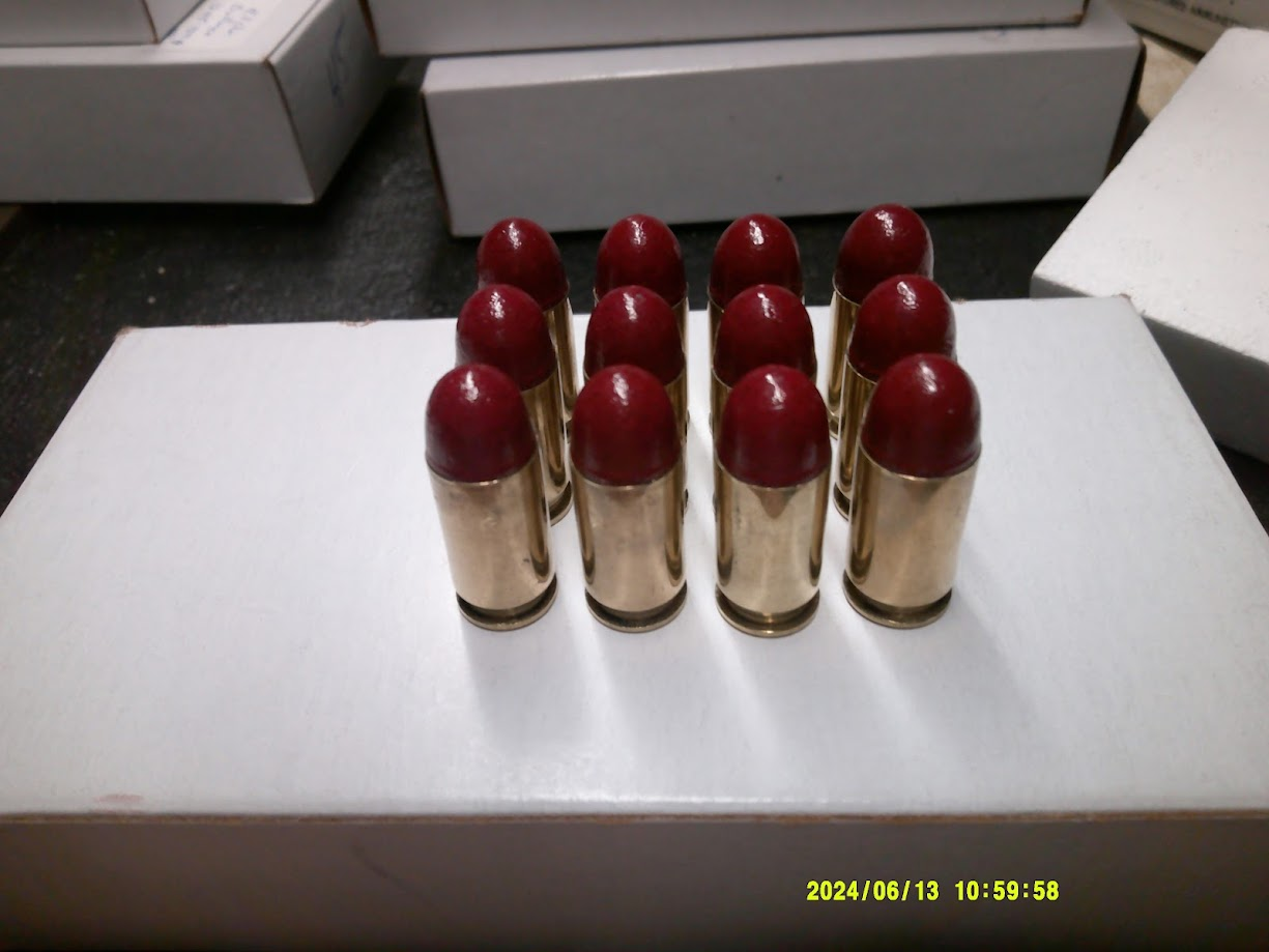

i also took 17 "Test rounds" of the new Badman Bullets poly coated, 230 grain, @ near max charge of 5.0 gr. of TightGroup.
i gotta say, it IS true, that cast lead bullets do add to the smoke of shooting (many articles on this)
the poly coated bullets...??? i had a hard time seeing smoke.
there was "some" but, geez, hardly all that noticeable.
i like this....i am liking the poly coated bullets.
now, the powder charge might have helped cut down on the smoke as well.
i still noticed "some" particles on the shooting bench, but much less than with the all cast lead bullets.
of course with the higher powder charge, you guys know, the velocity was much better.
here is a pic, of the 17 "test rounds", with the obligatory "flier"
and once again, a pic of the test rounds. (i had made a few extra since this picture was taken)

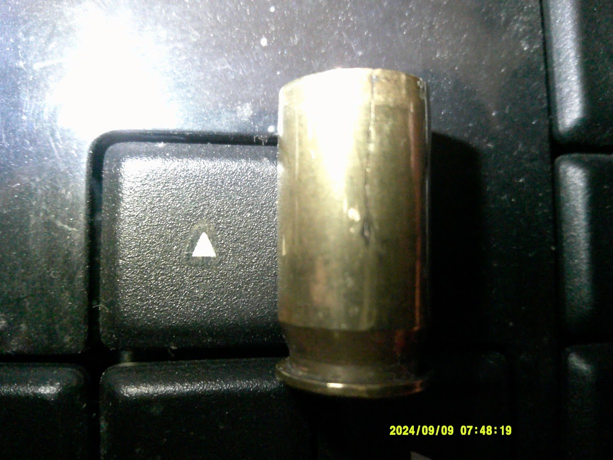

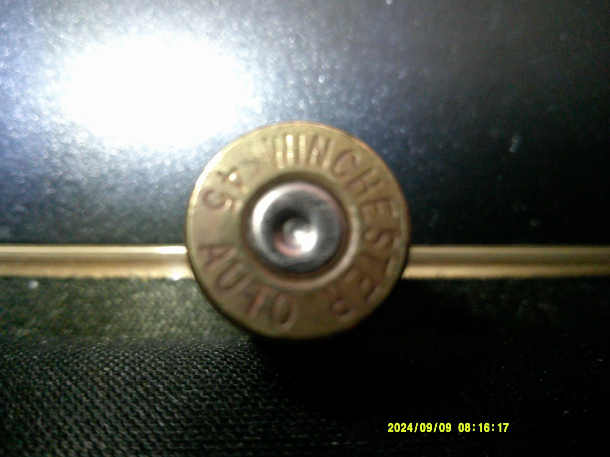

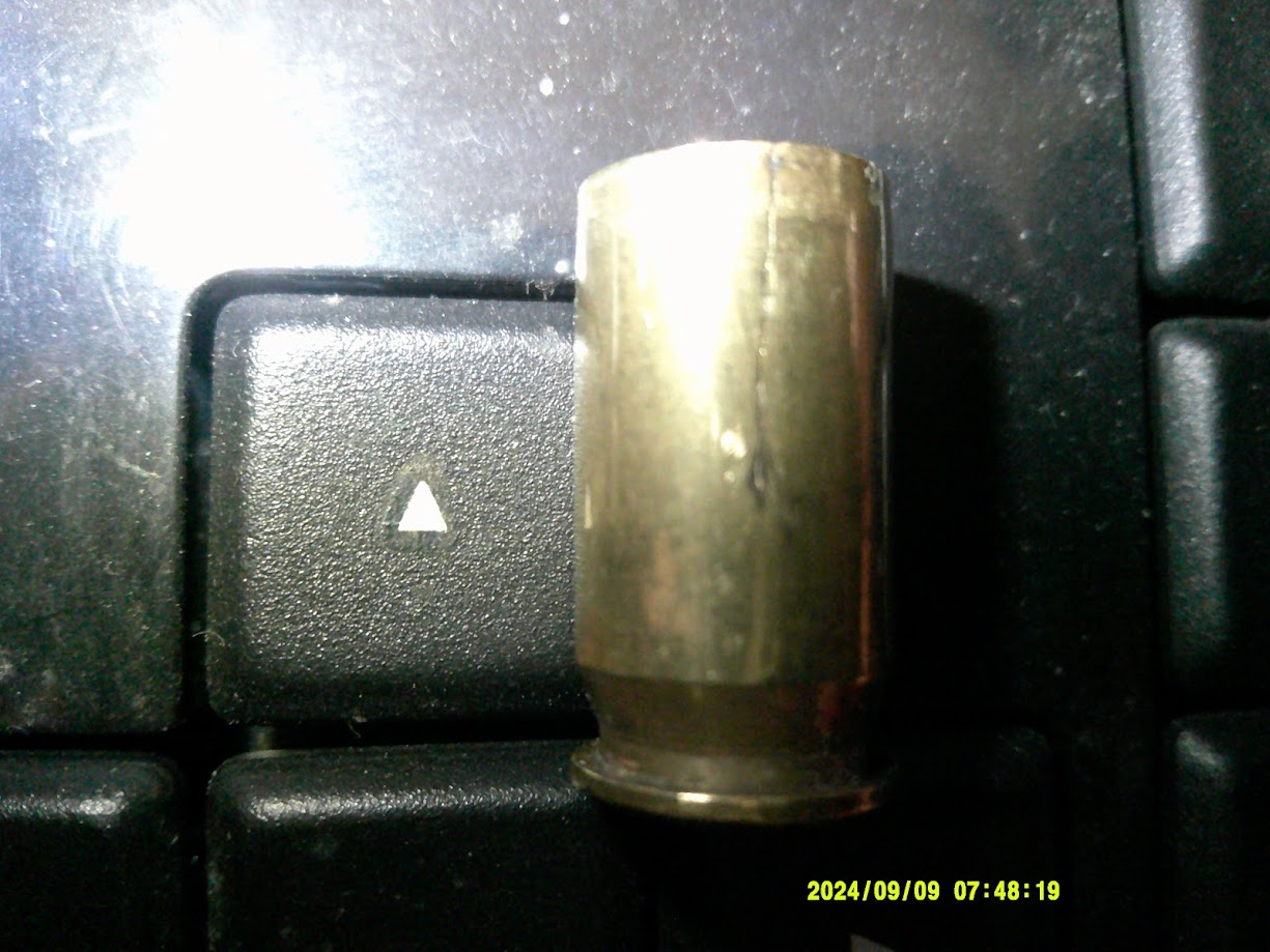

took my Colt Competition to the club earlier.....100 rounds of my reloads from Aug of 2023......4.5 grains, TiteGroup, 230 gr. lead.
i had 1 cracked shell casing, if i can recall, it makes now at least 4 total since i started reloading coming up on 2 years ago.. this Oct/Nov.
it is a Winchester, i do not know if it was a range pick up, or my own pick up.
other than being dirty? the headstamp "looks" brand new....so it "could be" a first fired shell casing. then at least this one time reload.
we spoke of this in another thread, many said..."stuff just happens with new", so i ain't about to worry over this.
especially with the starting charge load.
all newly done reloads for 45ACP, are now at least at the 5.0 charge, still slightly below max charge.

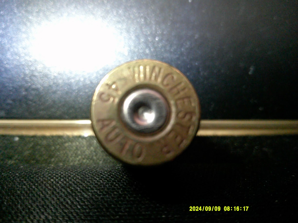

A long time ago I often got 3-4 loadings from range and new brass. Although a low pressure round there is still stretching was each firing. Of course the brass thins as it stretches. Brass splitting was fairly rare as I often measured overall length on brass that had been reloaded multiple times. If the brass stretches too much it can cause excessive headspace that could even result in a ruptured case as well as just being split.
yeah, i have new Starline brass, right now, i cannot recall how many i have in use, and how many in the cabinet. in time, and when i can, i will buy more new brass from them.
not that it is an absolute guarantee they will last longer, it's just that even with first fired brass, like anything else these days, materials from the new factory ammo can be less in quality as it once was....
i'd have to "surmise"...never assume, that Starline Brass is produced with higher standards all the time, over new factory ammo brass is these days.
this is yet another reason why i will dump brass from Mexican made ammo, like Aguila...to me, when i handled it..??
it just "felt" lighter in weight than say S&B, or Winchester, Federal, and a few others that i reload.

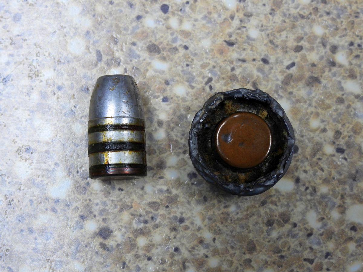

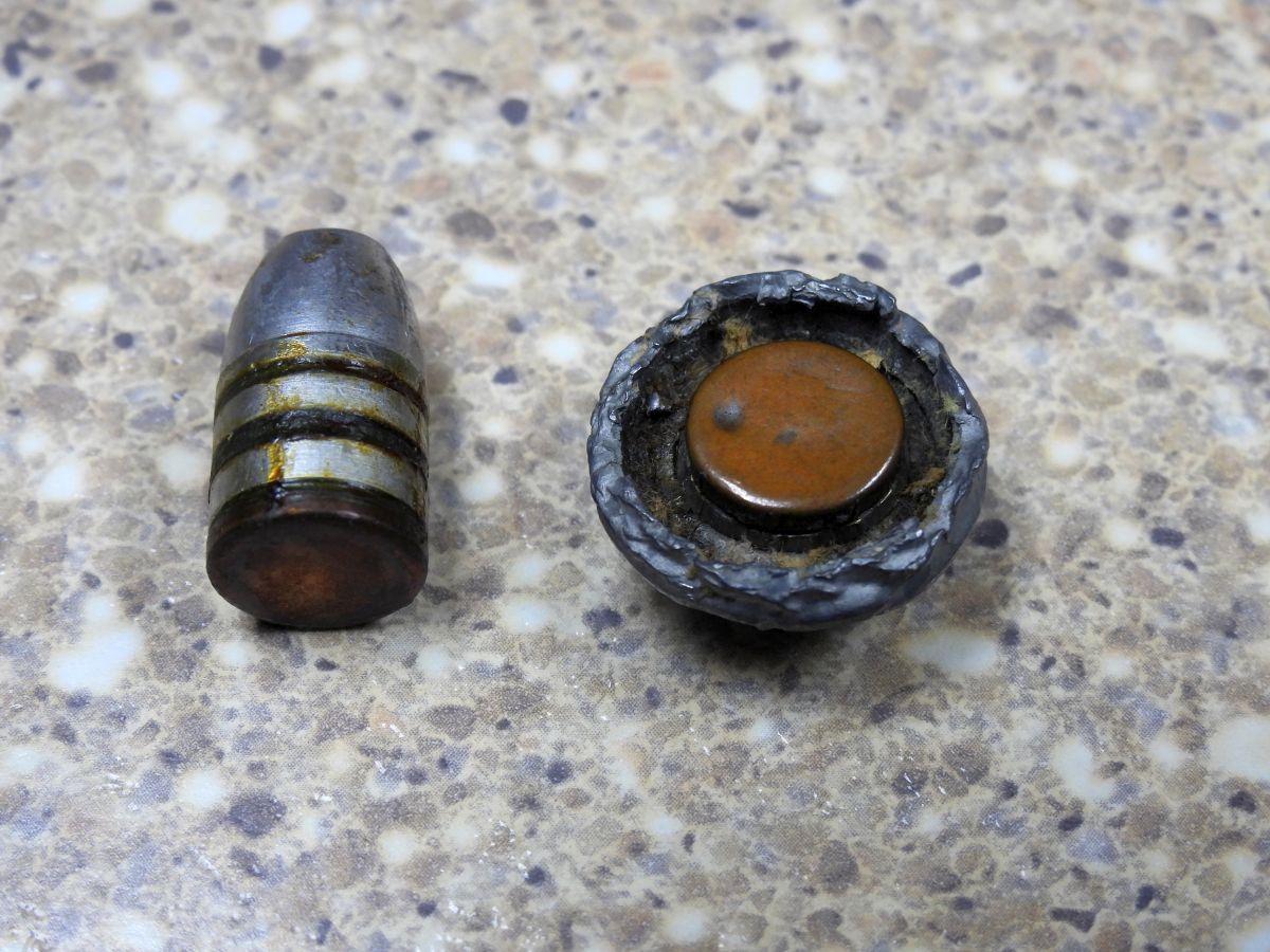

When I first started reloading... many years ago when smokeless powder sold for $3.40 per pound, I used Bullseye for target pistol loads and 2400 for magnum pistol loads. My experience was that Bullseye burned about as clean as coal, and 2400 burned clean with maximum loads. At below maximum loads, 2400 left a yellowish residue with some unburned powder.
I made a change to Unique for target loads and Blue Dot for magnum loads, which performed well and burned clean. I started casting bullets, and bought a 150gr gas check 357 mold, a 250gr gas check 44 mold, and a 215gr bevel base 45 mold. I always removed lube from the bevel, because I thought it may contaminate the powder if the cartridges got warm enough to melt the grease.
When sizing and lubricating the bevel base bullets, if I cranked up the pressure too much, lube forced into the bevel would push the bullet up out of the die and fill the die cavity with grease. I took the mold block to a very talented machinist friend who modified the mold to remove the bevel. Knowing that removing the bevel would slightly increase the bullet weight, I had 0.010-inch removed from the bottom of the mold, which slightly shortened the bullet. It was a guess, but the bullet weight seemed exactly the same.
The bullet mold was a Lyman 45266, which I think is no longer made. The picture shows an original bullet with bevel base on the left and a modified bullet on the right. The red color near the bullet base is residual from Alox bullet lube. I changed to a different black lube but didn't clean out the die.
Some published reloading data showed 7.3gr to 7.5gr of Unique as maximum for the 45266 in 45ACP, but I found 6gr to 6.5gr performed well with good accuracy.

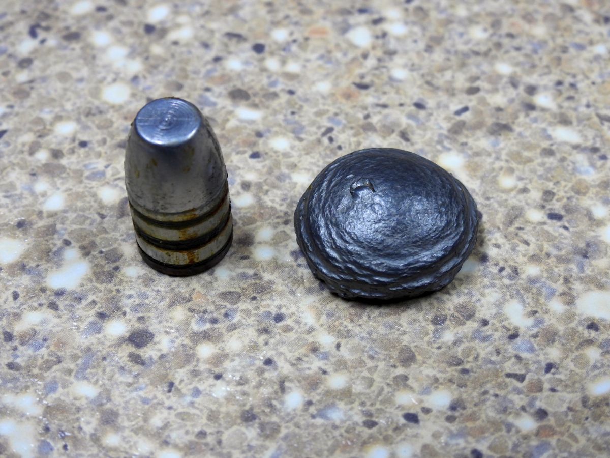

I shot one load that resulted in very short case life. The rifle was a Ruger No. 3 in 45-70. As it was a modern strong design, there was published reloading data that significantly increased performance. However, these loads were unsafe in older weaker guns and even in modern lever actions. Velocity was within a couple of hundred feet-per-second of the 458 Winchester.
Although chamber pressure was significantly higher, there were no signs of excessive pressure. Primers were not flattened. Empty cases were easily ejected by the Ruger No. 3 spring-loaded ejector.
The cases did take a beating and needed trimming after every firing. After firing 5 times I noticed a bright ring around some of the cases. A machinist friend sectioned a case for me, and there was a groove just inside behind the bright ring on the outside. I'm certain that the case would snap in two if fired again. I started with new unfired cases and discarded after 3 firings.
Another friend was a phone company employee for the telephone company in a large city. There were separate white page and yellow page directories--both about 3-inches thick. When new directories came out, the old ones were discarded. He brought a lot of them home, and we soaked them in a tub of water before standing on end in a large box.
I tried my 45-70 load on the wet phone books and was surprised to see my 300gr Lyman "No. 2 Alloy" hard cast bullet had expanded from 45-caliber to about 69-caliber. The gas check remained attached. The bullet left a 3-inch diameter hole about 18-inches deep into the wet phone books. Pictures below...
I found a formula--don't remember it or where I found it--to calculate recoil. The Ruger No. 3 was a light weight rifle, and the recoil was about 3-1/2 times the recoil of a 180gr bullet fired from a 30-06. The most I ever shot it in one day was 16 times. Many friends would only shoot it once.

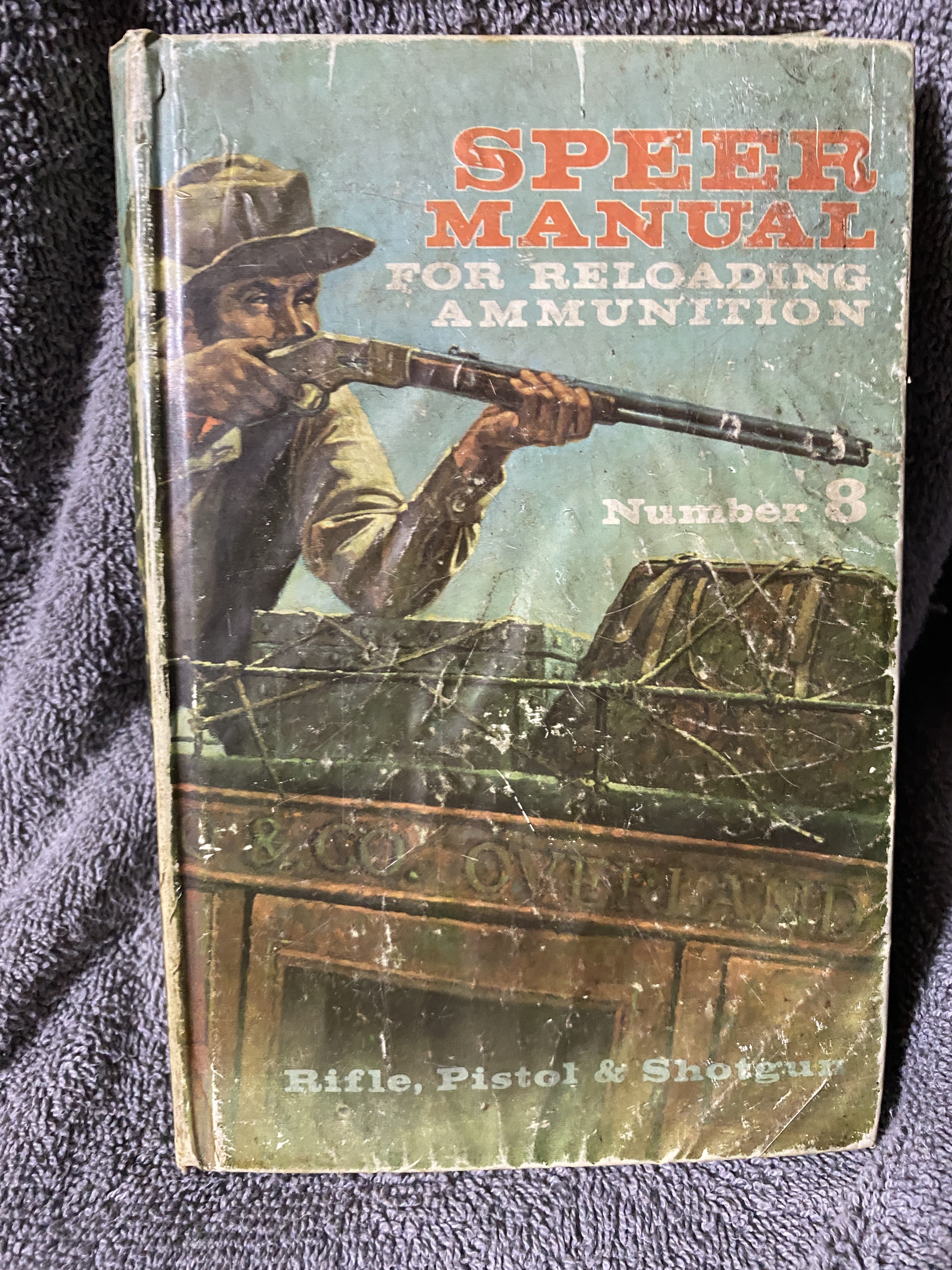

Some of the Loads in the Speer number 8 were noticeably higher than the later revisions.
I had that one when I was loading 220 swift and 6mm Remington for varmints.
