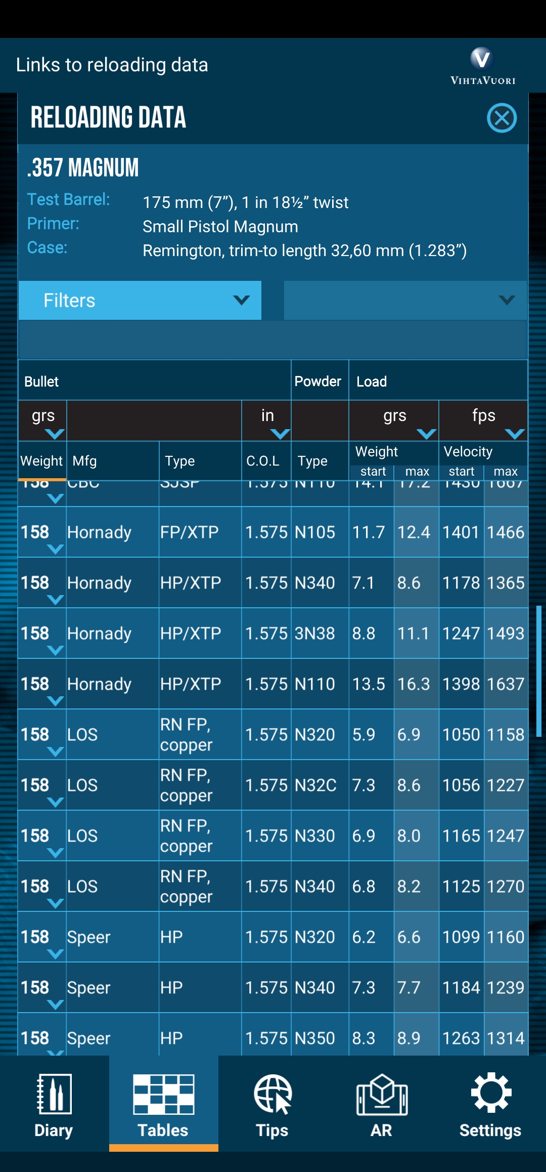

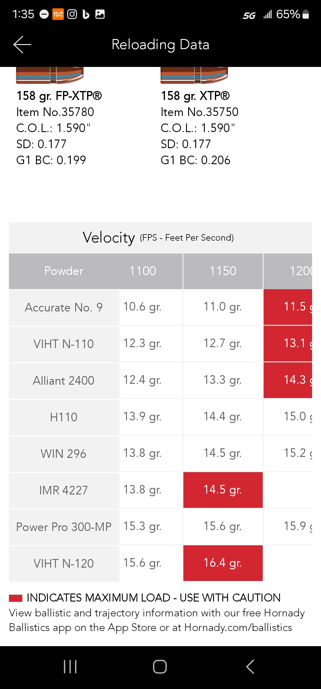

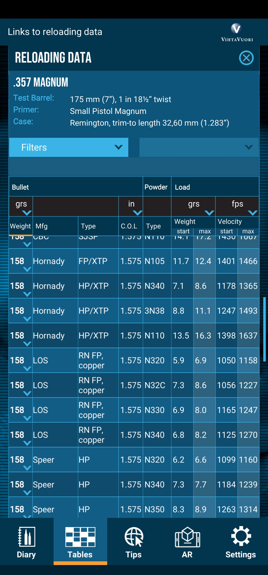

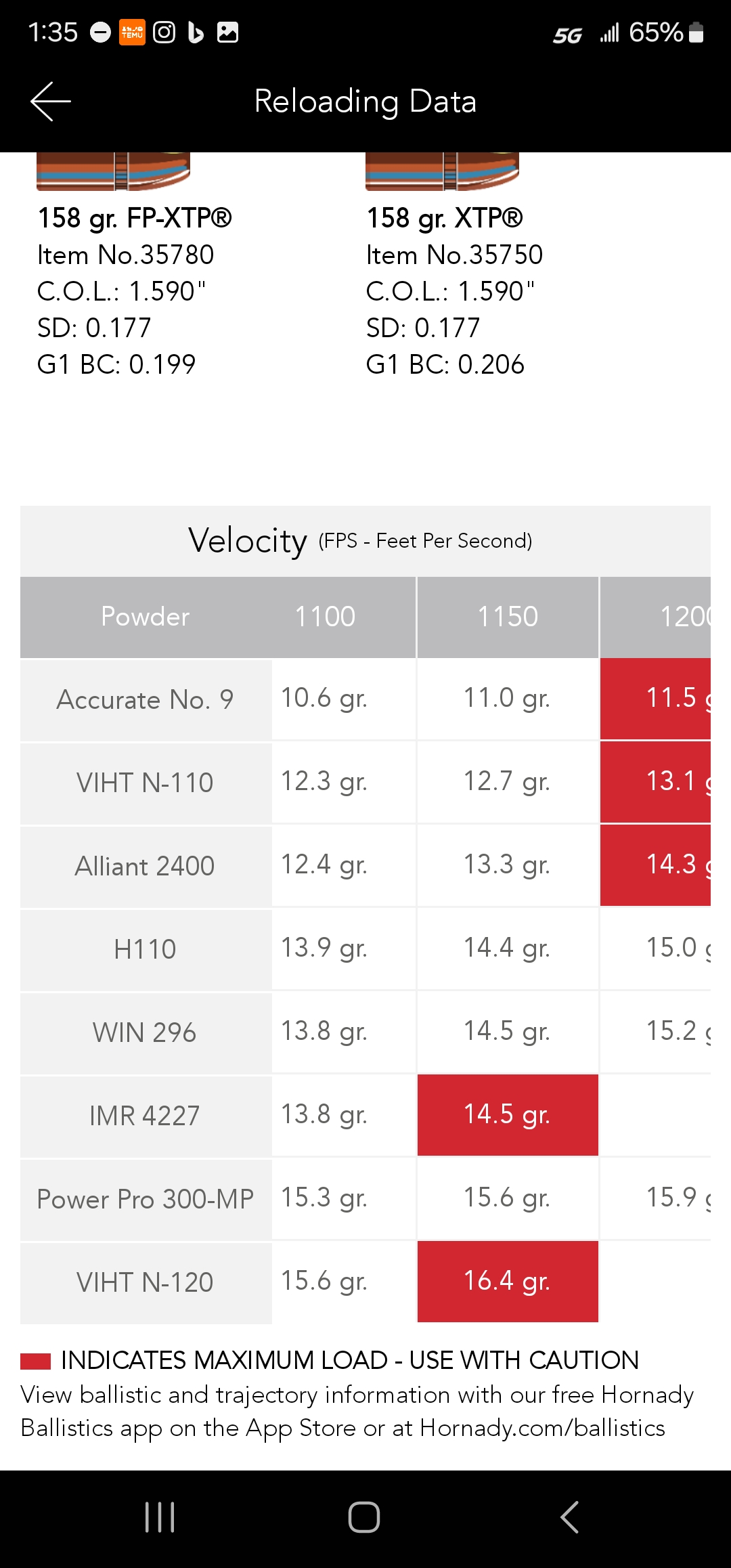

I got one for you....357 magnum using VV N110 and 158gr XTPs
Hornady data maxs out at 13.1 grView attachment 81629
VV data starts at 13.5 and maxs out at 16.3View attachment 81630
Where would you start???
I would probably start at about 12.0 gr and not go over 14.0 gr.
I looked at my Lyman 50th manual, it does list pressures from a Universal receiver with a 4" barrel.
With Federal cases, CCI 550 primer and 1.590" OAL, it shows for the Hornady 158gr JHP #35750 bullet:
N110 STARTING 11.5 grains 851 fps 21,800 CUP pressure
N110 MAX 14.0 grains 1139 fps 38,200 CUP pressure.
The SAAMI specs for 357 Magnum pressure and a 158 gr bullet shows 45,000 max service CUP
