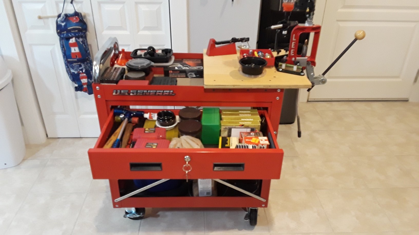

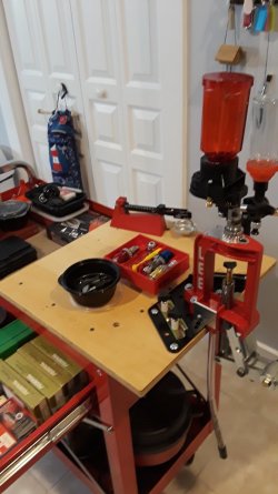

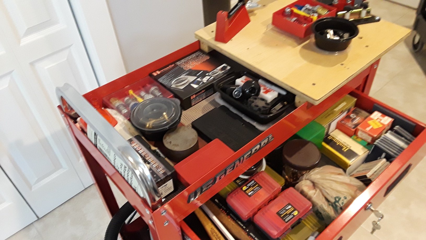

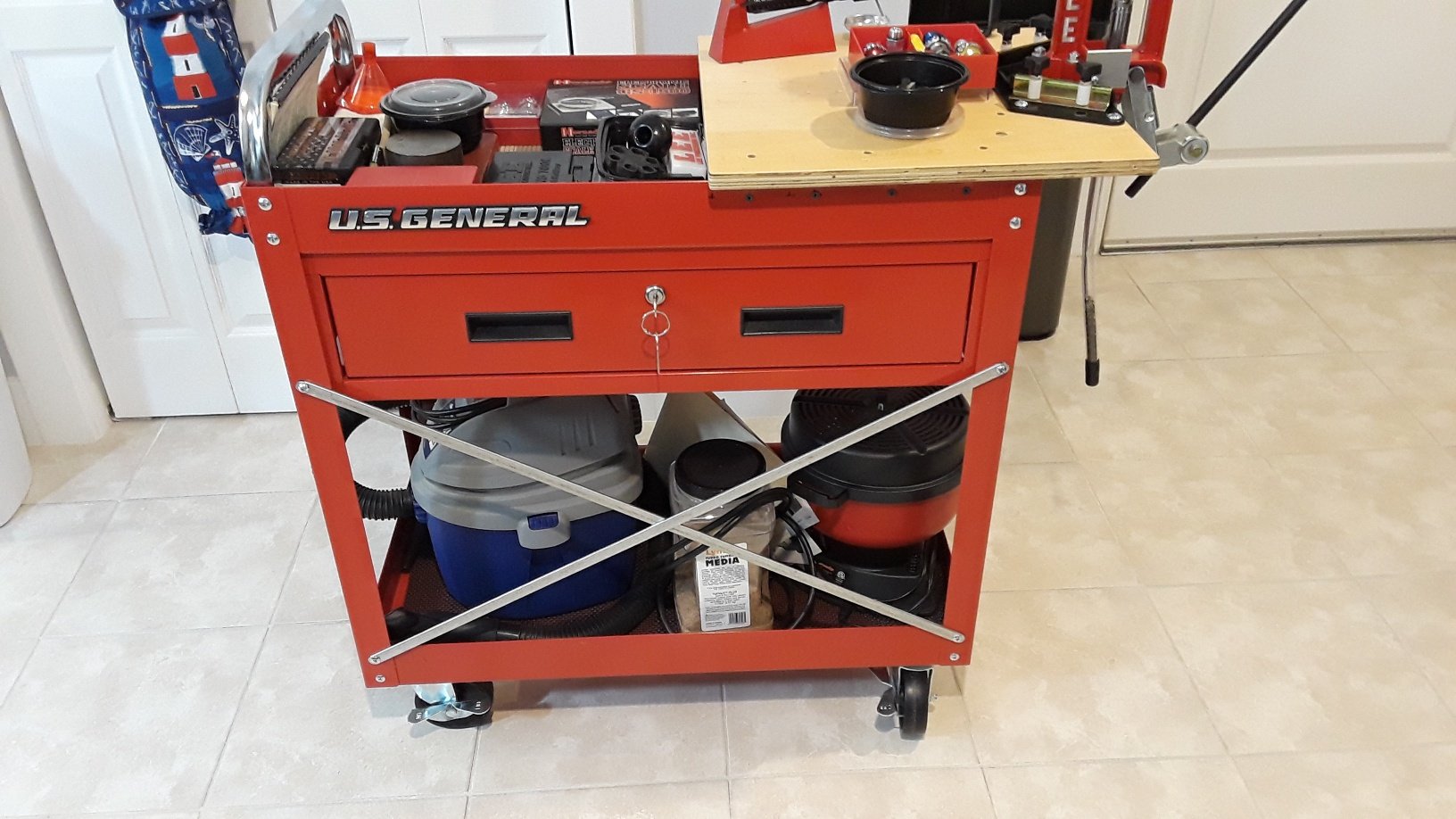

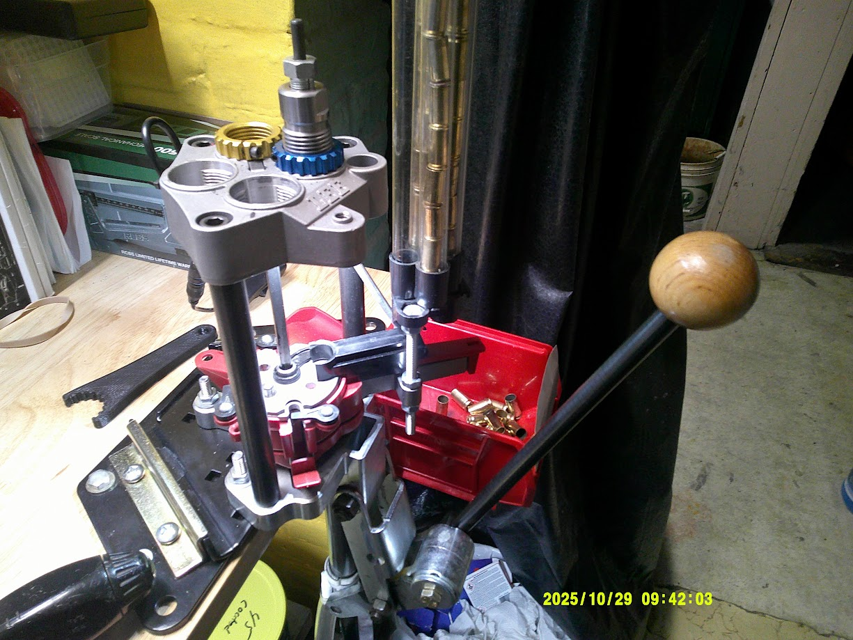

I'm always ready, willing and usually able to help anyone wanting to get into the reloading hobby. Please know that anyway I can help, don't hesitate to ask. I may not have the answer, but even if not I'll help get the answer for you. I'm going to include a couple pictures here for you to review that may/may not give you some ideas about getting set up. My wife and I sold out our home of almost 40 years and moved into a retirement community about 7 years ago. We came from a nearly 2,000 sq' home to an 1,100 sq' apartment so space was at a premium. Scaling down on everything was mandatory. At the old homestead I had a separate bedroom for my office, a very minor work shop for small projects, and my dedicated reloading room. I had a lot of storage in my 2 1/2 car garage, but did all my actual loading in my back room. So, I had a giant work table set up with several presses of various types and uses including shotgun loading. But when we got here to the community ( I prefer to call it the institution
) I no longer had the luxury of a dedicated room for my reloading and had to make some changes. In the process, I knew there would never be enough room for another giant work table as I had before, so with some thought I came up with the idea of a small, movable cart for my loading supplies and tools. I bought a small 18" x 30" roller cart from Harbor Freight, added some X bracing to the legs using galvanized tension bars used for chain link fencing, added a plywood work top to about 1/3 of the top, and loaded it up with presses, powder measures, scales, etc. Every tool has it's place on the work top and is easily removed/replaced either with a couple screws, and eventually bought and installed the "Lee" mounting plate to all my presses for extra quick move/remove. These pictures just happened to have been taken when the 'O' frame, Challenger press was in use. The set-up has almost unlimited potential, except for unlimited space. But I also stole a corner of my closet, installed a couple shelves and again have a little extra space for storage. With this set-up I can move my cart over to a corner of the den and out of the way, but then simply pull it out and roll it to wherever I want to sit down and start loading. I often move it to the living room to watch TV while de-capping, etc, but rarely if ever combine TV watching with loading. Just thought it might be a little food for thought in getting set-up for your new venture. Regards, jj
