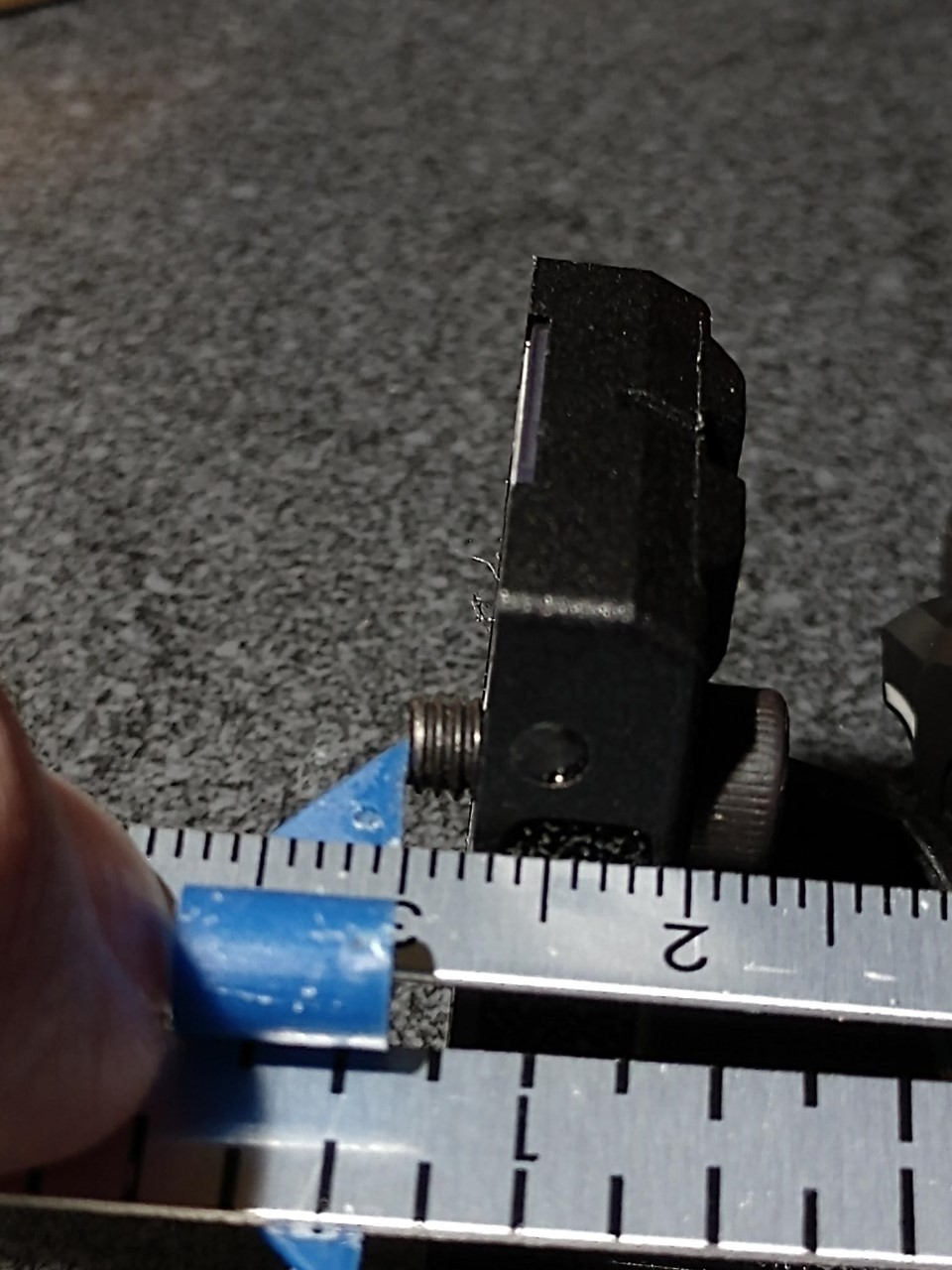

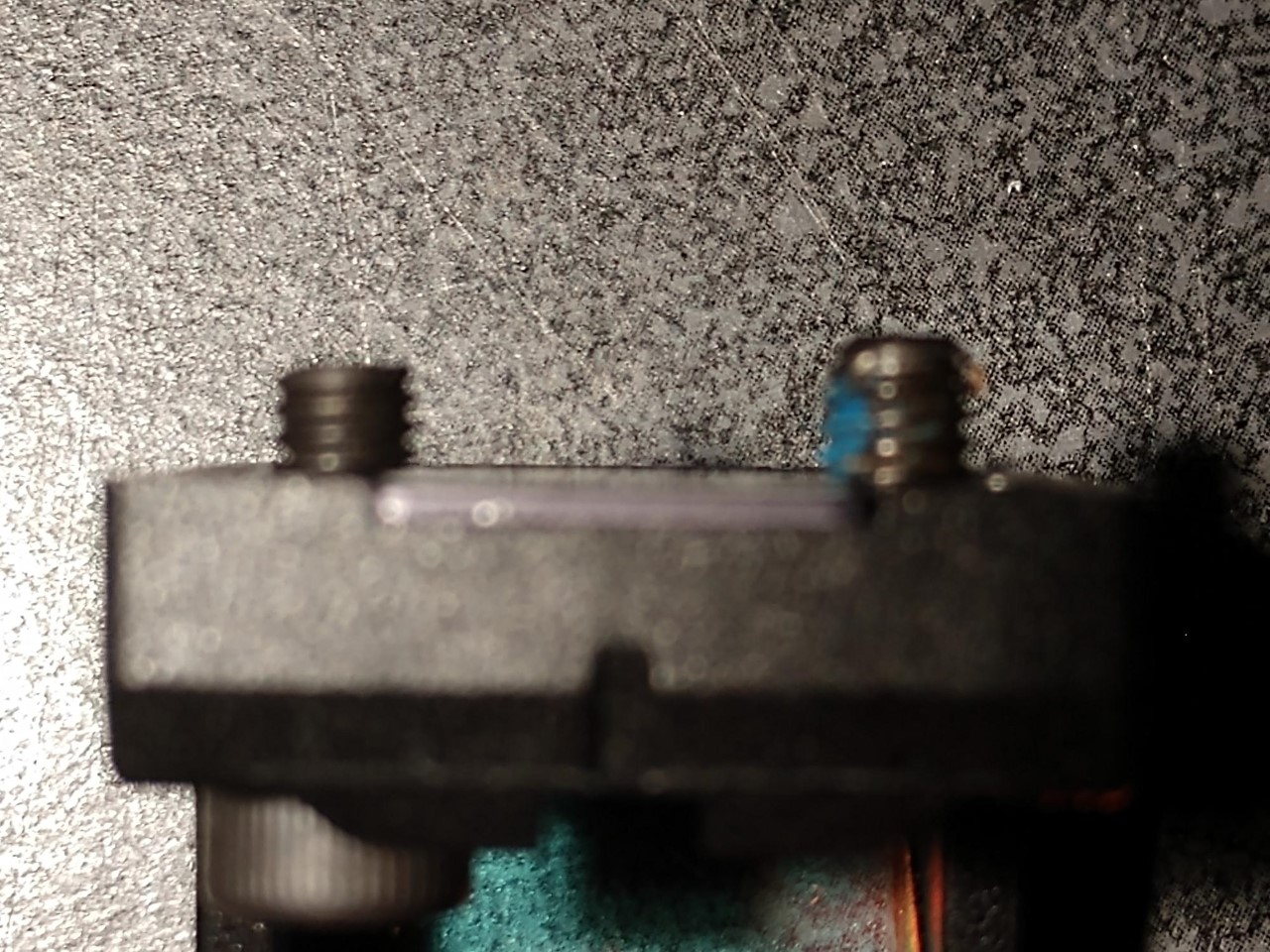

I'm attaching 2 photo's I took, to help out anyone else that needs a visual of how the supplied screws with the RomeoZero are a tad too long, and how they compare with the above mentioned hex-head screws.
The first image shows the hex-head screw on the lefthand side, and the supplied screw with the RomeoZero on the righthand side ...and you can see the hex-head screw is just a tad bit shorter ...
In the second image, I'm measuring how far the hex-head screw extends through the base of the RomeoZero ... and it is exactly 2.4 or 2.5 mm .... just what the Hellcat manual specifies.
The slider is not exactly at the number 3 ... and the screw is not 100% all the way through the base ... as I was holding the slider against the bottom of the screw ...it pushed through just a smidge ... but I had 1 hand holding the ruler and 1 had on the camera and didn't have another to hold the screw in tight ... but it sticks out exactly 2.4 mm ...
Thanks buddy. Finally, someone posting actual concrete info!

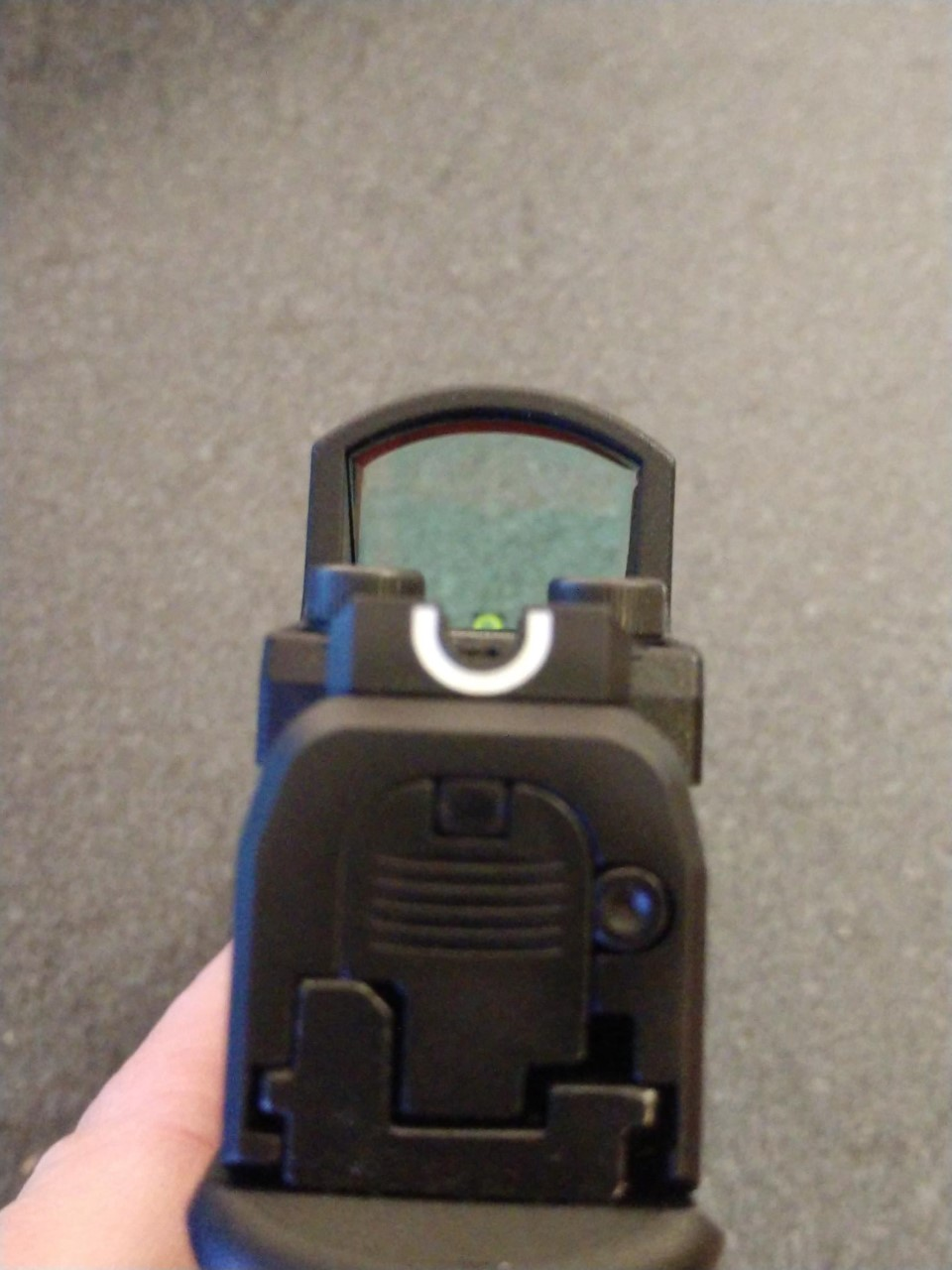

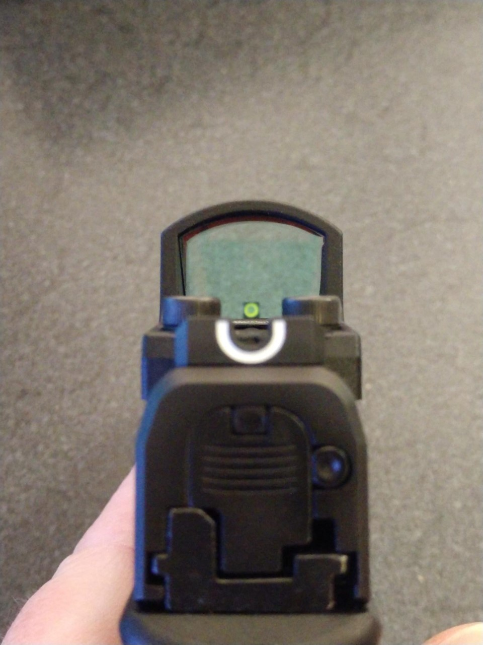

Here are 2 pics I took, the first showing to fully see the "ball" of the front sight, it is too high or above being centered into the "U" or the rear sight.
The 2nd photo shows where I would estimate the front sight should be within the "U" of the rear sight ...but can now only see about half of the front sight. Seems imperfect to me ... as I probably would need to only see the top third of the front sight to really have it centered perfectly in the rear sight.

Thanks! Those pictures are so helpful!
Antonio, be aware, at best the Romeo will only co-witness at about the 'lower third'. In other words it will never be as good at co-witness as the Shields or the newer one iirc the Wasp. There may be one other now but it ain't the Romeo.
there are a couple really good pictures here on some thread that truly shows the difference. (anyone remember where they are?) Maybe someone will know where they are.
The thing is, a 'lower third' will work OK on a rifle where you have a longer sight radius and a slight dip of your head will help in the sight alignment when using the 'lower third'. But I'm willing to bet you won't like it on a handgun. Most who have tried it don't.
So, if you want a true 100% co-witness you'll have to by-pass the Romeo. It's a good quality red dot, just not designed to 100% co-witness with the Hellcat. Once you see the real difference, you'll understand I'm pretty sure.

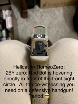

I don’t agree at all. Sorry. There’s a big difference in a rifle vs. a defensive handgun with a red dot. The RomeoZero on my Hellcat is perfect! Just my opinion😎. Oh, I love the Wasp on my other Hellcat (RDP) too!
MacGuyVR, I don't have any issue with what you have, and I'm happy you're satisfied, but it's not 100% or 'Absolute' co-witness on your Hellcat. Here's what "Google" has to say about 100% co-witness on the first hit when I went looking.
"With absolute co-witness, you are getting 100% of the iron sight present through your red dot. You are seeing it all. The red dot or reticle of whatever kind is going to sit on the tip of the front sight and generally be aligned with your iron sights."
Here's a link to where I got this: https://www.google.com/search?client=firefox-b-1-d&q=100%+co-witness+sights
But here's the reality of things ..... if you're happy with what you have, that's great, but it's not a 100% co-witness as I understand the term. With mine, as I indicated, I can see the red dot sitting directly on top of my front iron sight and I can see the entire iron sight picture in a normal hold ..... no head dipping, tilting, nor anything else.
It's as if the red dot is a small, red, round target and I'm holding my irons at a 6:oclock hold on that target at approx 27-30' With a chamber laser inserted in my gun and holding on a wall or other flat, vertical, surface at 30', the laser and red dot basically cover each other. In order to see the red dot, I have to hold my finger over the muzzle to block the laser.
I only reiterated to Antonio that he will not get 100% or 'Absolute' co-witness on a Hellcat with a Romeo red dot sight. I didn't want to steer him wrong with the advice he asked for and I offered. I also was careful to explain to him the significant difference between a long gun (rifle) and a handgun (pistol) in the first line of my second paragraph.
