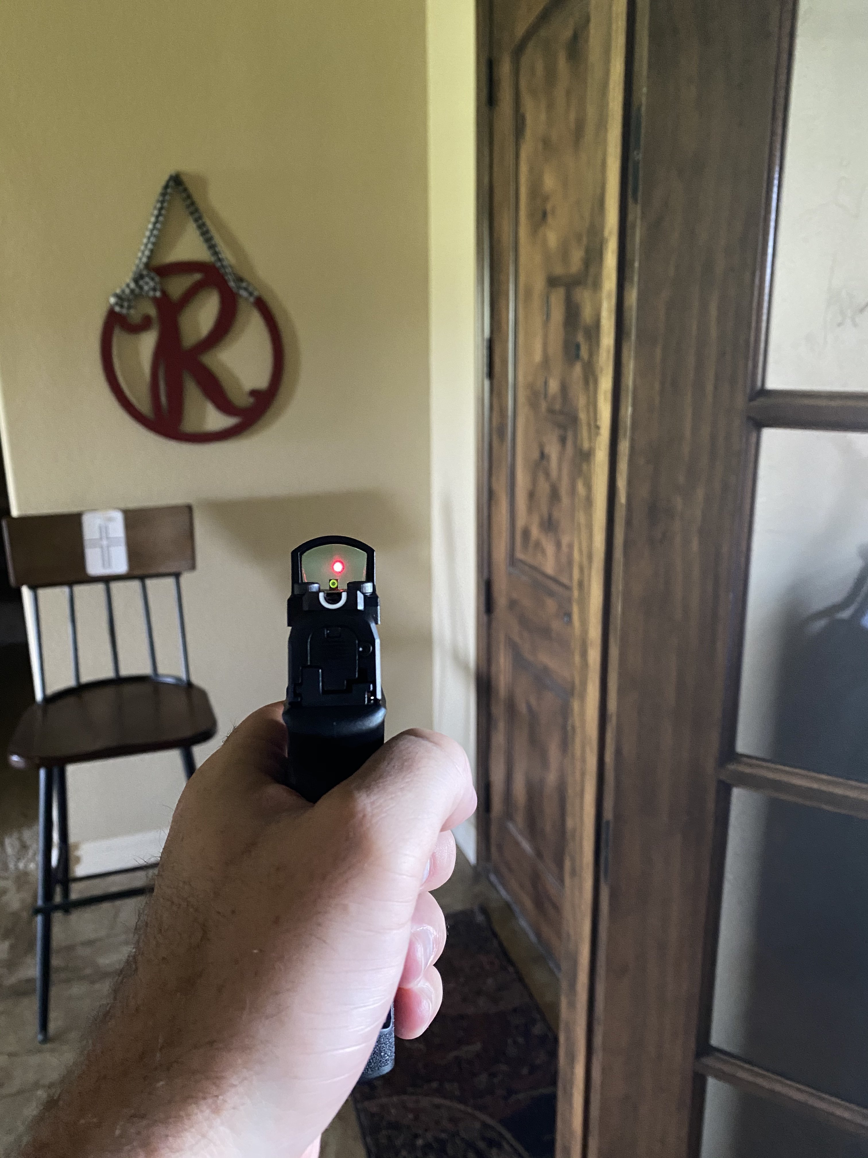

I used a bore site and was able to archive co witness with the hellcat iron sites and Romeo zero.
Glad that worked out for you and surprised. Every example I've seen with the Romeo and the Hellcat would not fully co-witness. Yeh, they'll get close, but as I understand the term 'Co-witness', it usually means you can see the whole 'ball in the bucket' and then the red dot. Simply being able to see the dot over the front sight (ball) doesn't qualify as I understand. But hey, I'm certainly more than willing to learn.

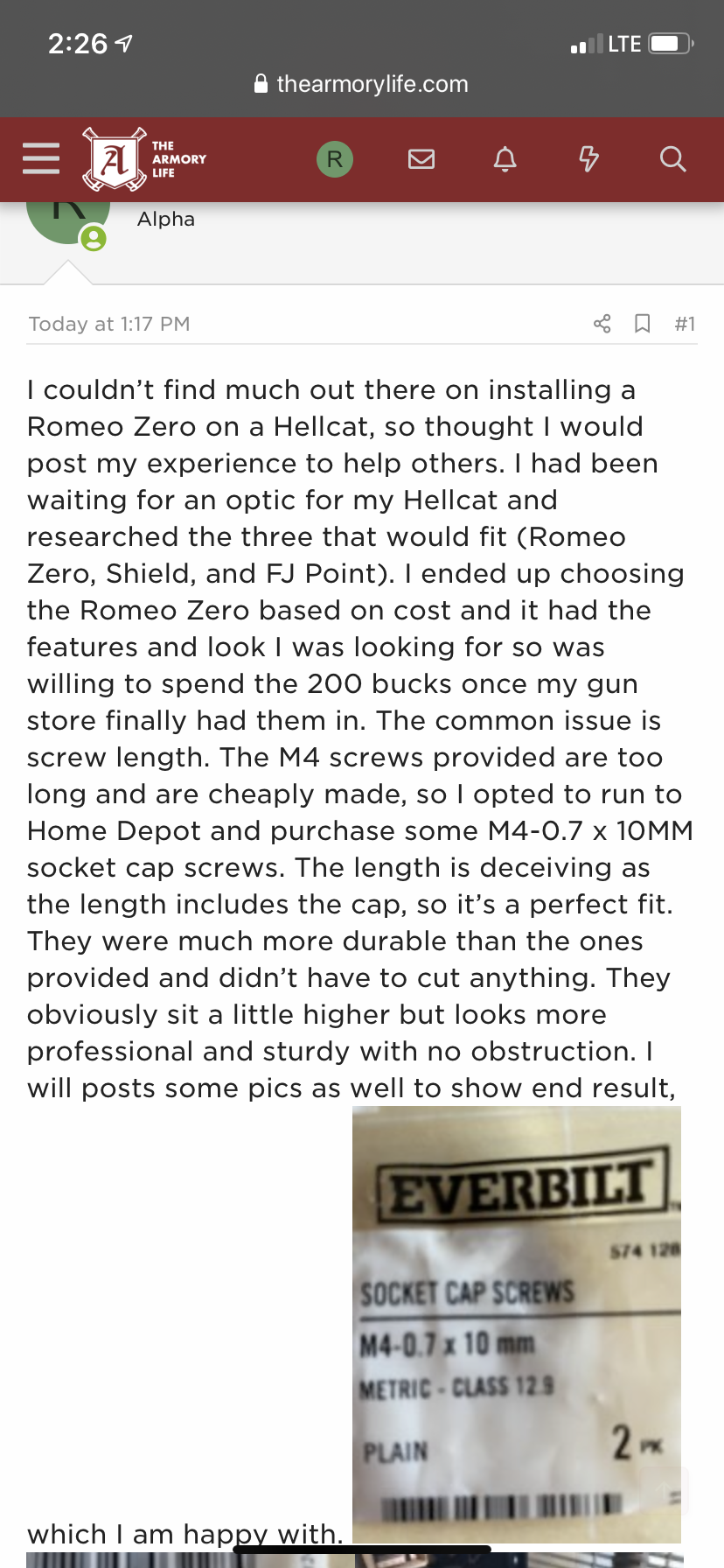

This little bit of info is invaluable RR!! Thanks loads, headed to local HWS today to look for the screws you recommend. Will look for the pics of your pistol everyday to see how it turned out!

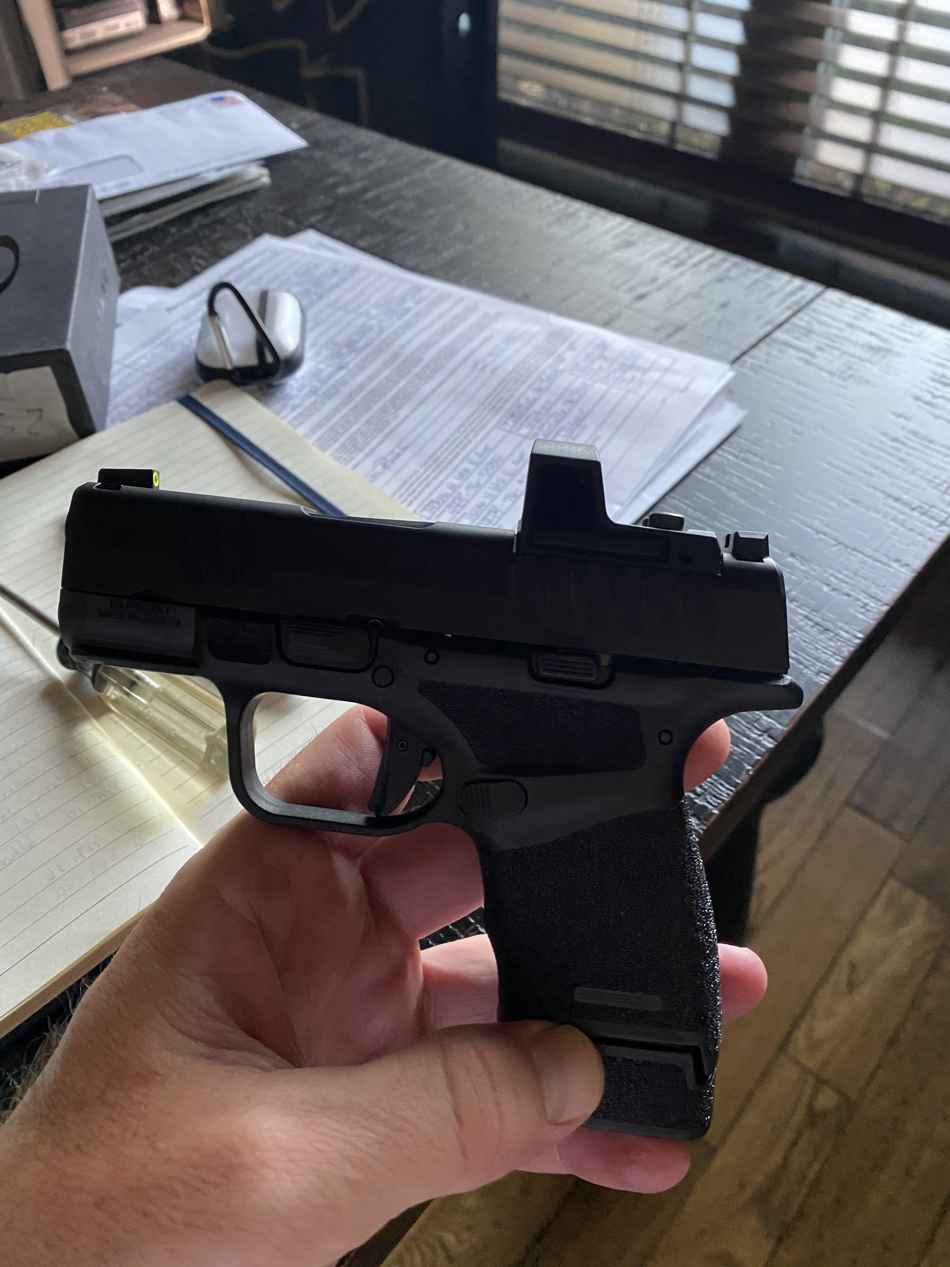

The screws you found are "healthy" enuff to do the job alright!! Doesn't look like they're so tall as to interfere with the off/on button, are they?
Nope, I can access the brightness button just fine. Doesn’t obstruct the view either. All about preference. If you were to go with these or a set that doesn’t protrude, I would recommend not using the supplied ones cut down either as the head is easily stripped. You will have to take off to replace batteries, so want something durable.
rushrush73 ..... in your post with the 3 pictures/attachments, how is it the tip of the trigger on your Hellcat in the first pic is so far towards the rear of the trigger guard- front to back? On mine, when viewed from the side exactly as yours in that picture, my trigger is almost directly in the center of the guard- front to back.

It’s not cocked.

RR, I thank you again for putting me on these compact socket head screws. I found some and torqued 'em down to 9 in lb and worked perfectly. I'm not gonna change screws even if somebody makes some that fit and countersink. These bad boys won't f up in a battery change ever!
