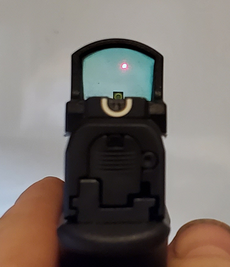

I bought 2 different calibers that night from the same seller (9mm & 30/06) and both seem to be 'dead on'. BTW, the picture in msg #19 of the Hellcat and Shield sight is exactly what my sight picture is except mine is directly over the front sight. The picture in the msg #19 shows the gun a little canted which is why I think the red dot looks to be a tad off to the right. I had no issue with alignment either up/down or left/right.

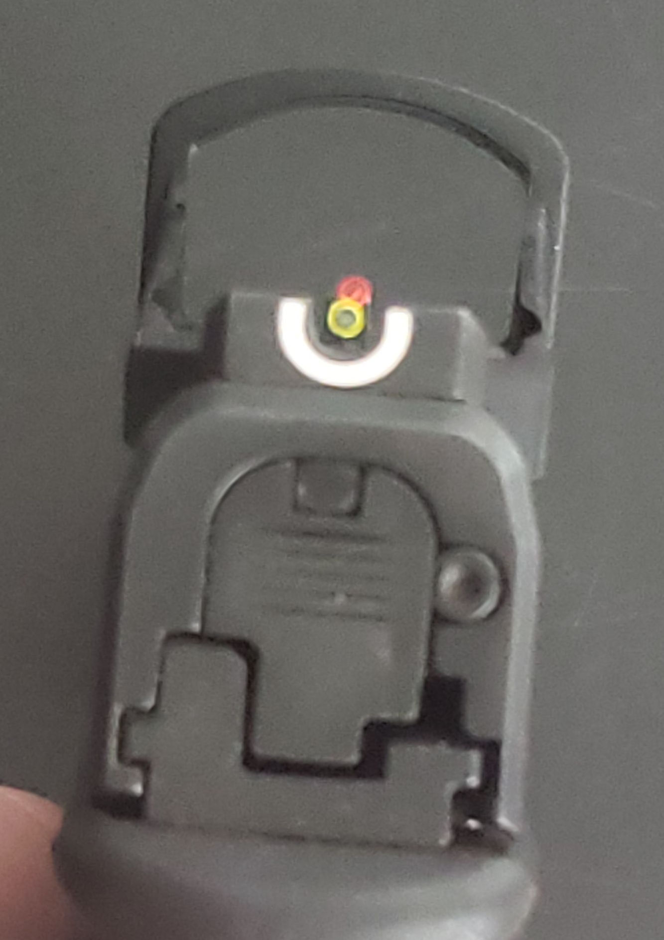

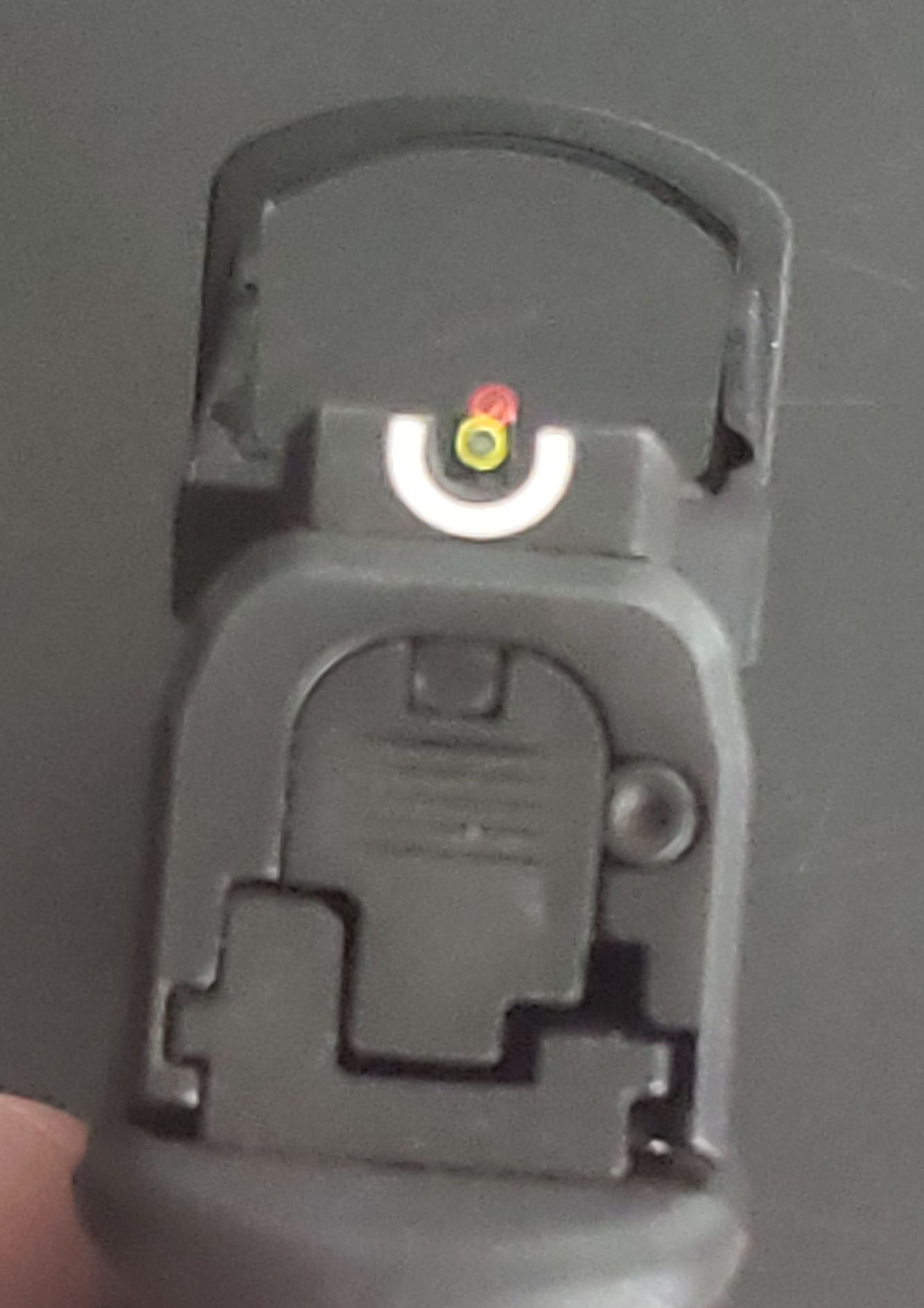

I had the same issue with the Romeo Zero on my Hellcat. I was probably 5" low at 20 ft and couldn't adjust it any further. Also, I was not crazy about the sight since it obscured the front sight about 60% when installed. I couldn't find any pictures of the Romeo Zero installed on a Hellcat and took a chance from the beginning that it would be close to the sight picture I have seen with the Shield sight. Not the case! I had to hold high to see the front sight with the Romeo Zero.

I mounted the Shield on the gun and it fit nearly perfectly aligned without touching it, and the best part, you can see the full sight picture with the SMSc sight just like they said it should be identical when the replied to the original email.

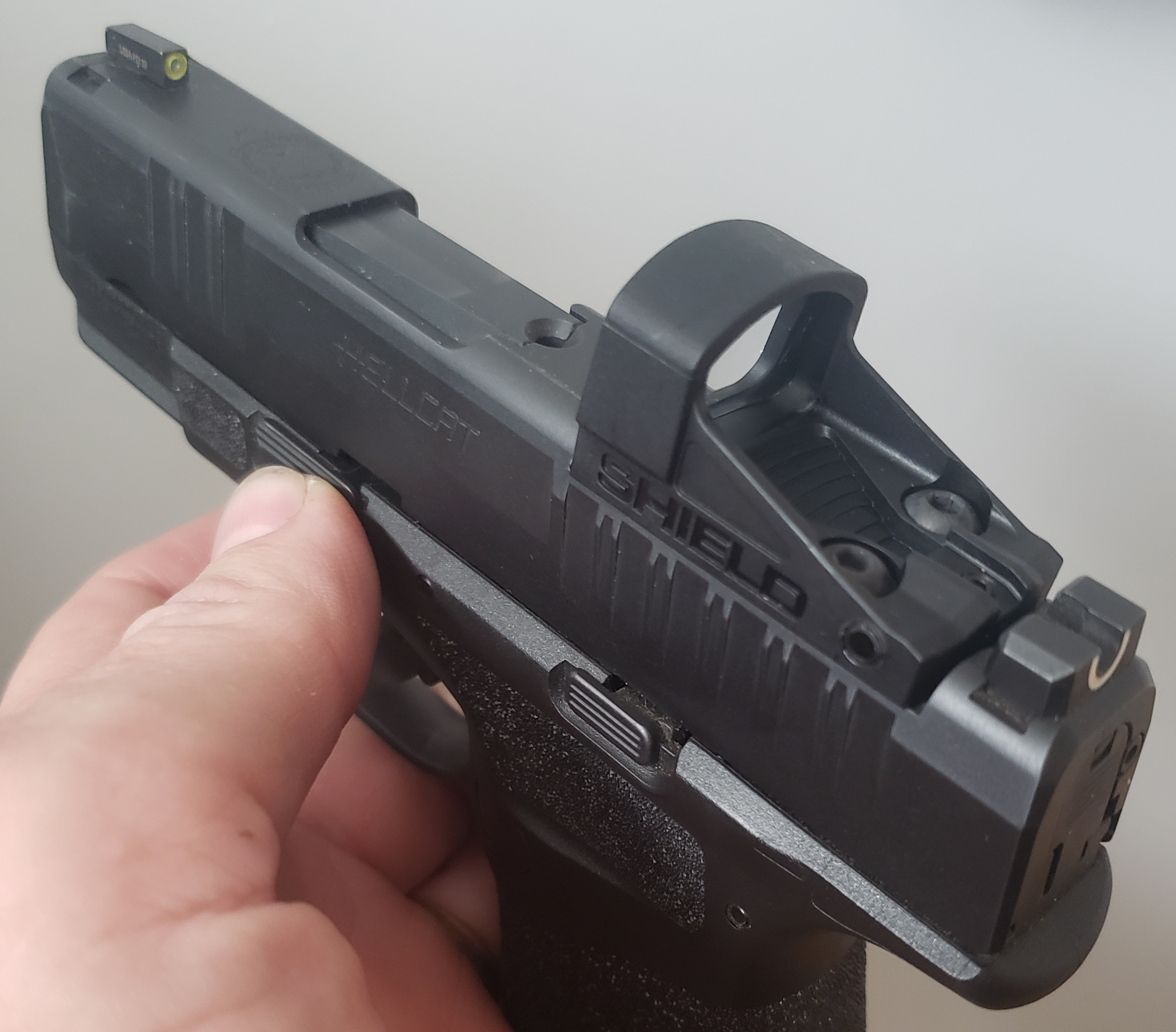

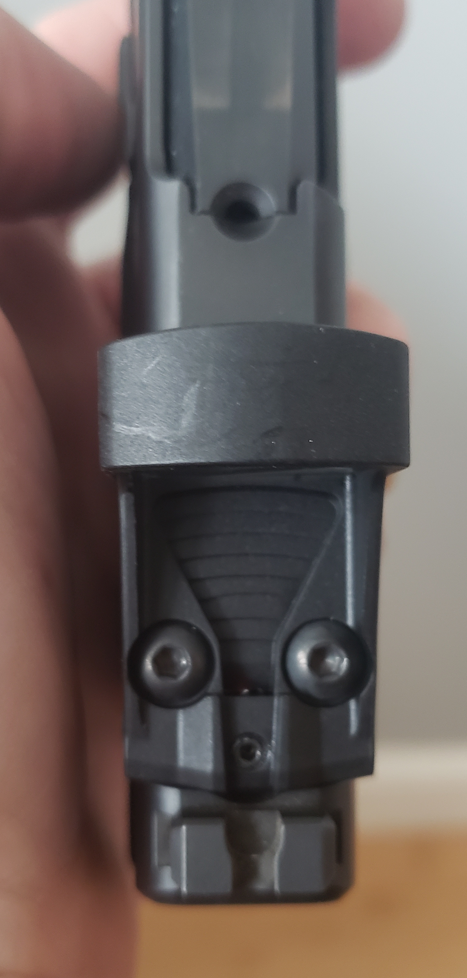

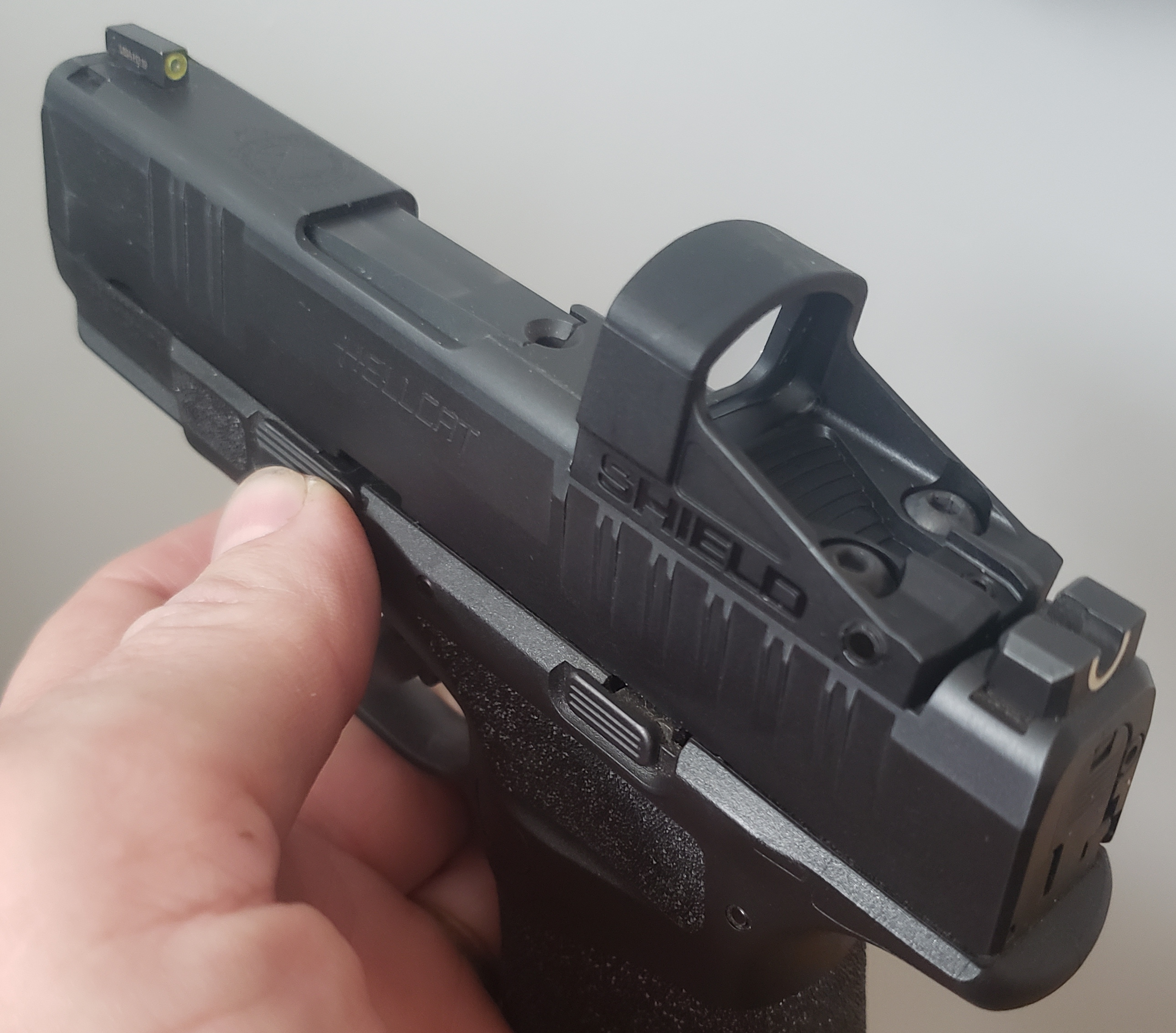

Here are a few pictures of the Shield SMSc.
View attachment 6640 View attachment 6641 View attachment 6642
Right away, I noticed a few things that were much better in my engineering opinion.
  1. The screws are nice large button head type screw to apply the pressure over a much larger area than the SIG flat head screw that is countersunk into the plastic body. (Don't over tighten, or you may break the plastic on the SIG)
