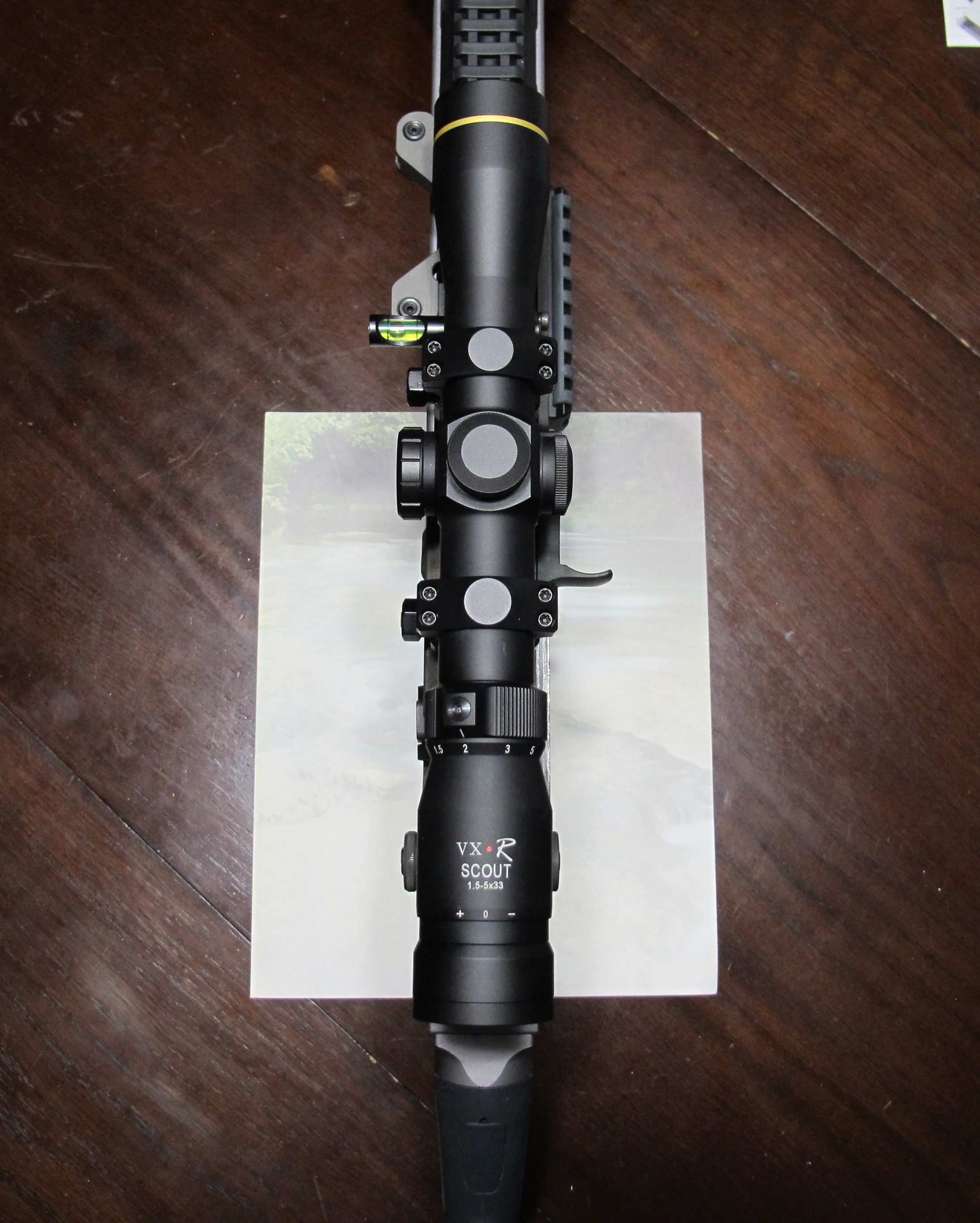

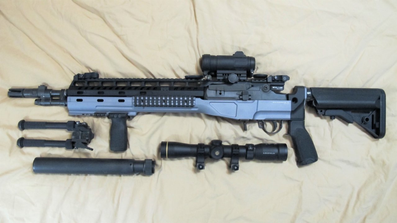

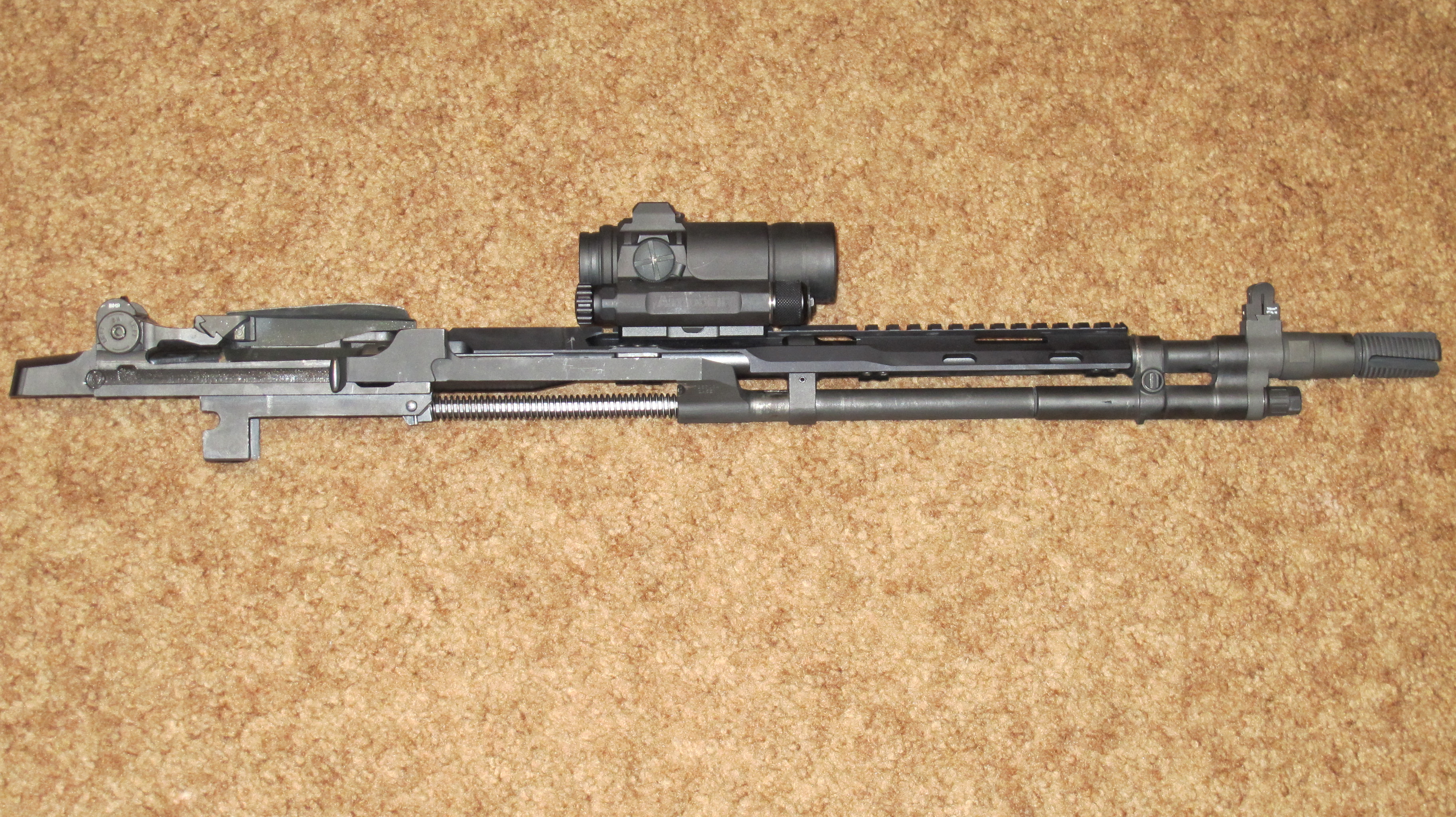

When it comes to optics on my M14s I prefer a red dot sight with a 2 MOA dot, or a Holographic sight with a 1 MOA dot. The "have your cake and eat it to" scope that I use on my 16.25" Socom length "Walter Mitty" M14 is an awesome Leupold 1.5-5x33 Scout scope with a 1 MOA Firedot. Unfortunately Leupold discontinued the scope, but you can still find them on the secondary market.

Consider replacing the factory M1A scout mount with an Ultimak or the lighter, cooler running scout hand guard from M14.ca. These rails allow you to position the optic lower than you can on the factory mount, and you can co-witness the iron sights through some low profile RDS.
No, you can't co-witness through the Comp M4 pictured here.

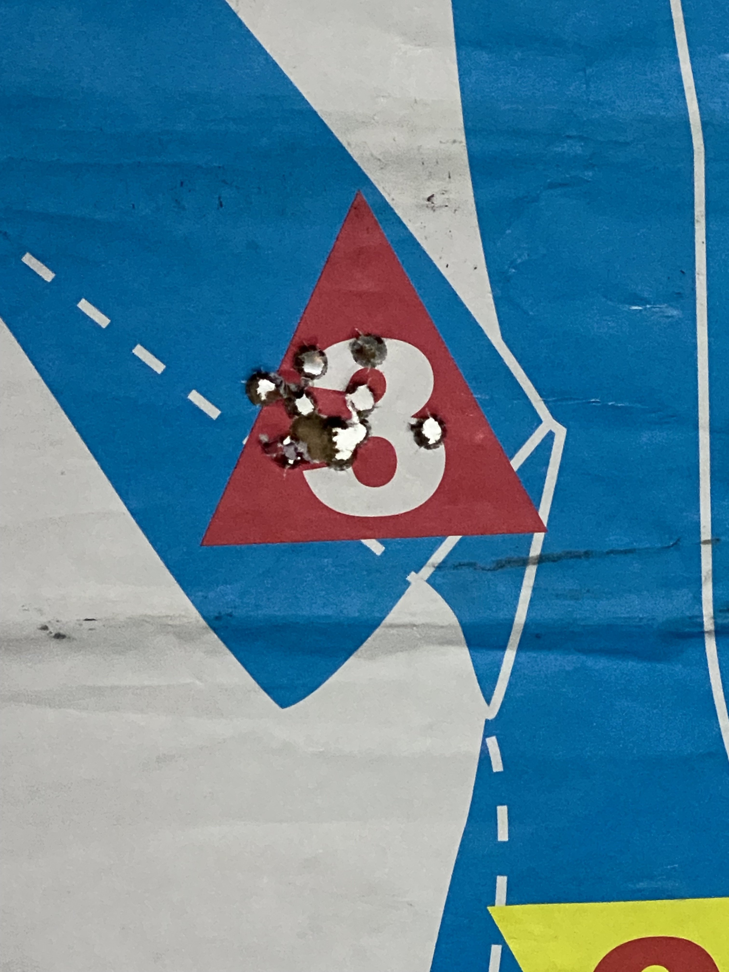

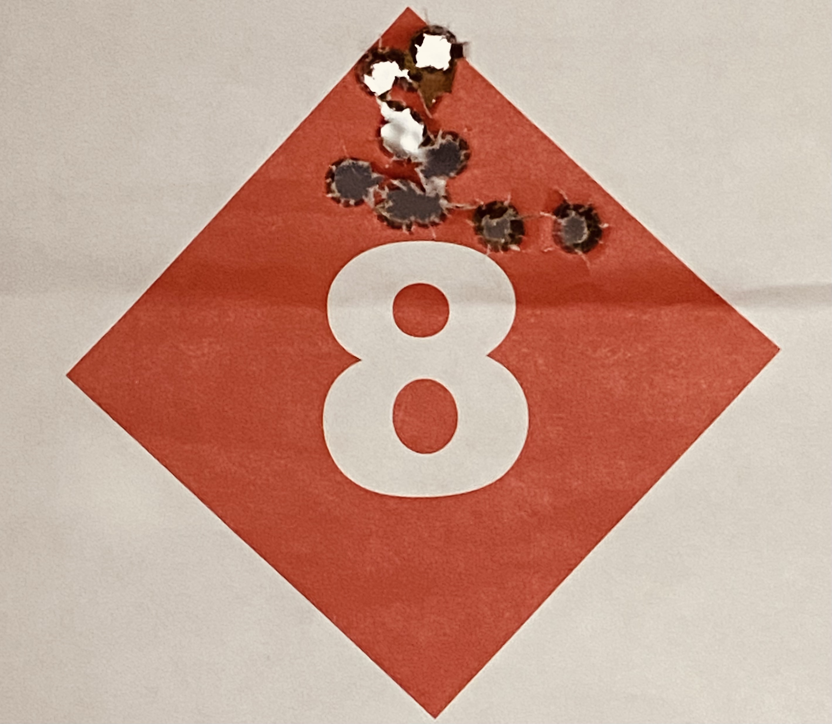

Certainly it could be the rifle rail, but did you make sure the rifle and scope were level, independently of each other during the mounting?
Just 2 days ago, I mounted a scope on my newly acquired Socom. Basic rings, nothing exceptional. Hi-Lux 2-7 LER scope. Had to move in to 40’ for paper hits and then moved out to 75’(range max unfortunately)
150g ball / elbow rest :
