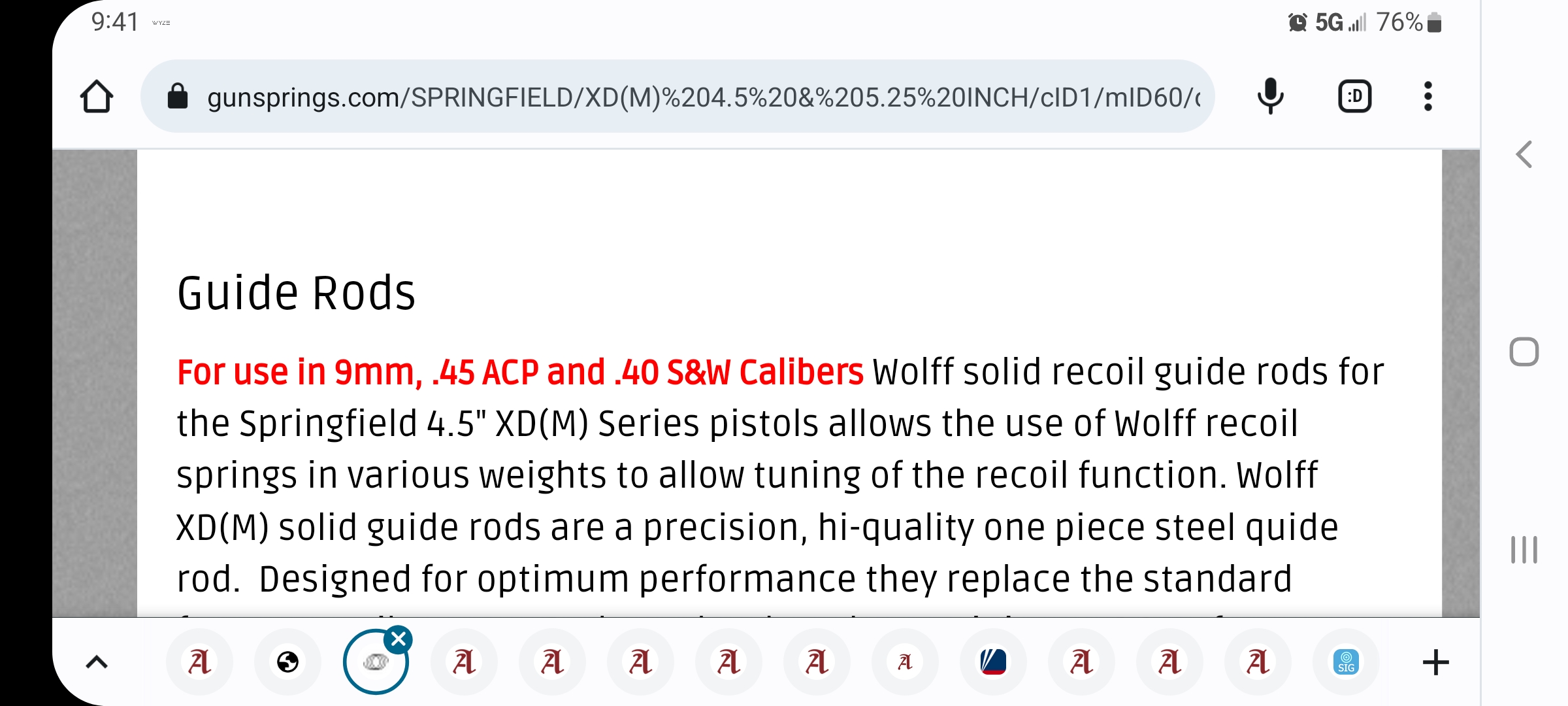

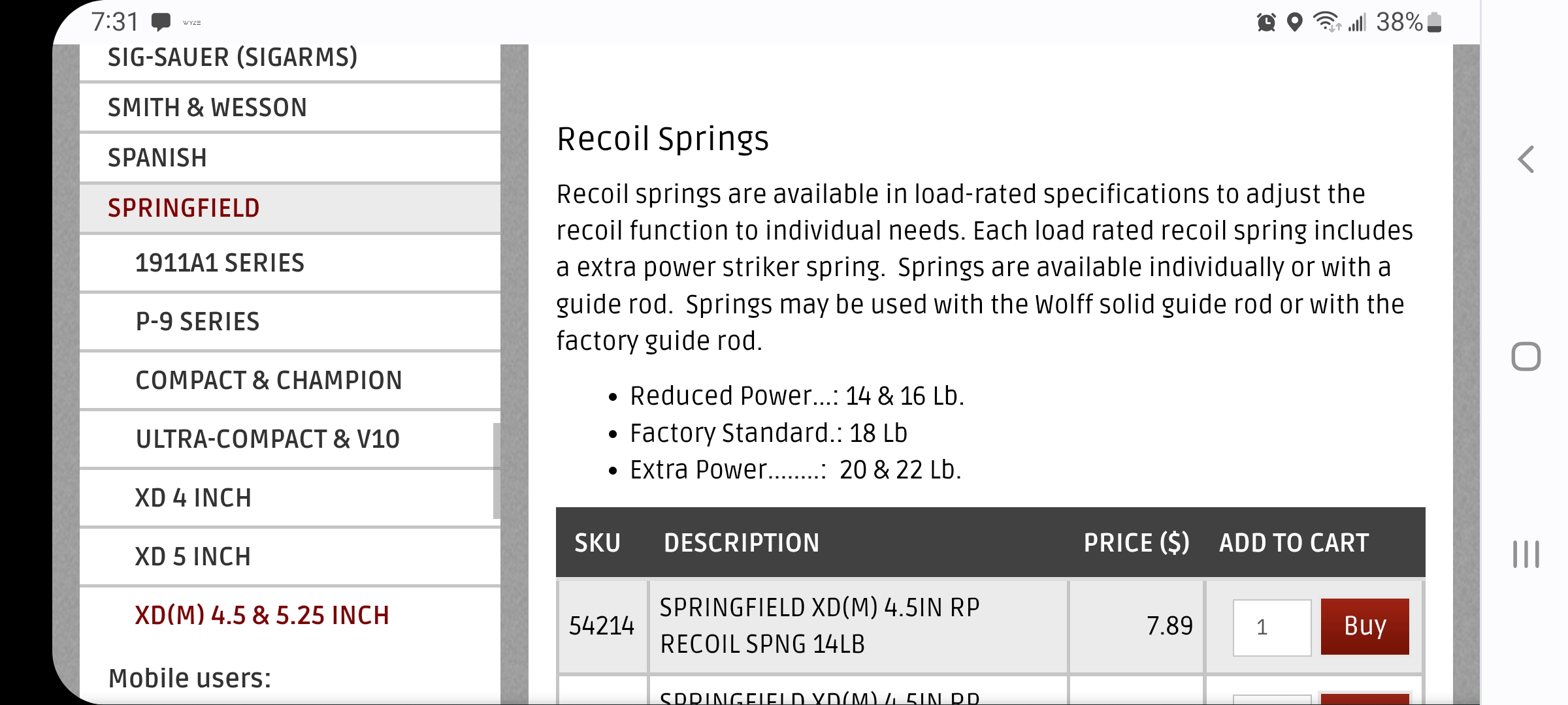

So Springer and Wolff are both wrong about using their springs on the factory XDM guide rod?
I hope it's not necessary, but I feel I should say that I am not trying to be argumentative, but I'm finding contradictory information and I'm just trying to figure it out.

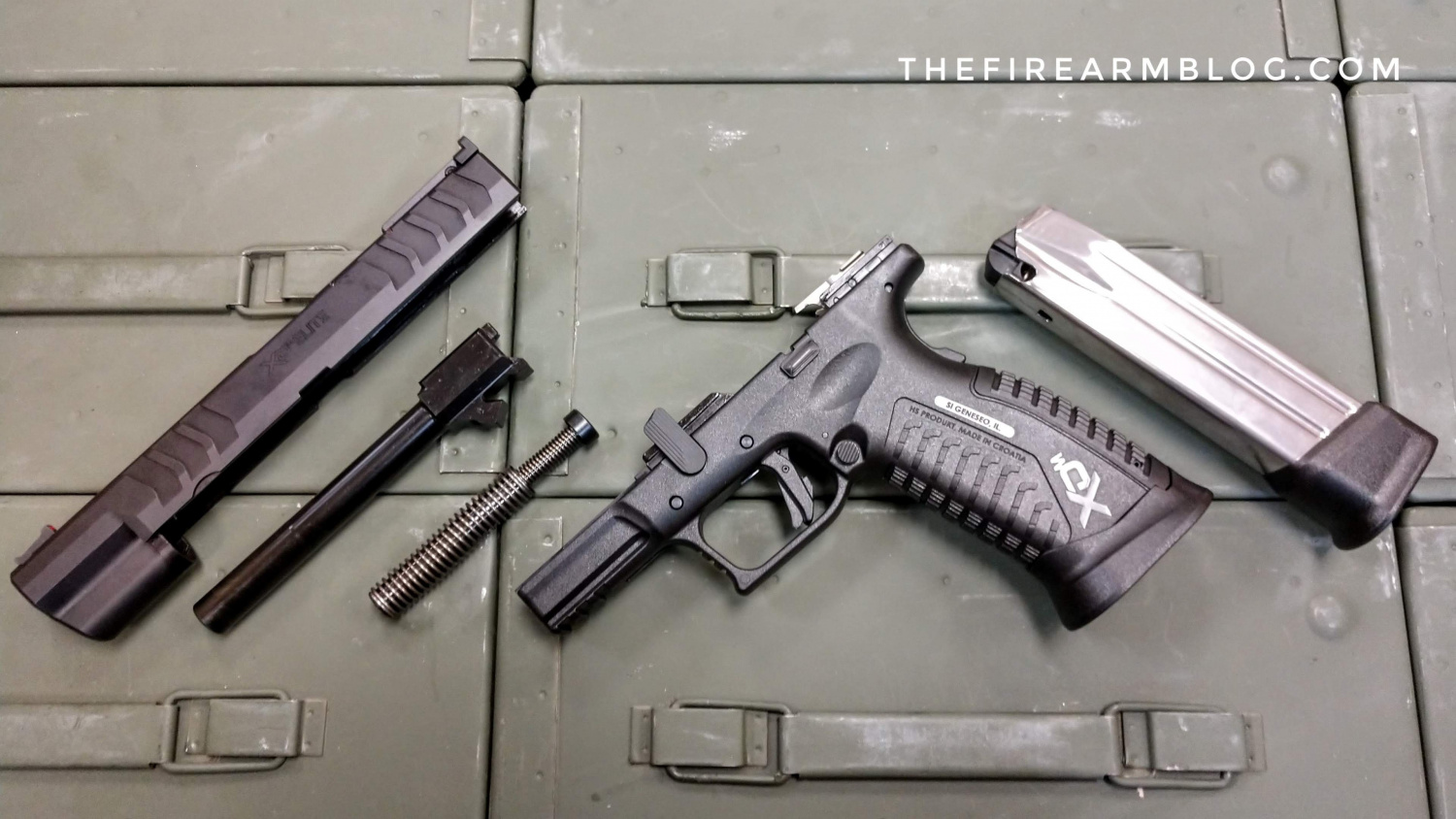

I need to make a correction & walk-things back.
My frame of reference is my XDm 5.25's in 9mm & 10mm (both have non-captive guide rods & springs as per TFLs post above), and my XDm-Elite 3.8 10mm, which has a captive & permanent guide rod/spring assembly.
So, my guesstimate is that the XDm-Elites 4.5 & 3.8 10mms have captive (double-spring at least for the 3.8) whereas the XDm 5.25 have single spring non-captive guide rods because the longer/heavier slides adequately soak up the 10mm recoil forces for proper function.
The shorter/lighter 4.5 & 3.8 need a different spring system to run properly so SA/HS Produkt went with that for those models.
Since there is a XDm-Elite 5.25 in 9mm I checked online to see if SA/HS Produkt went with a captive rod spring system for that larger/heavier model, and they did.
In this TFB review it shows the captive two-spring approach vs. the older/simpler non-captive XDm rod/spring system.
So I see why some aftermarket vendors stated that their guide rods weren't for the XDm-Elite vs. the older XDm.
I wonder why they changed from the older/simpler non-captive XDm rod/spring system for this larger/heavier model when it seemed to work just fine.
So I stand corrected & learned something in this thread.

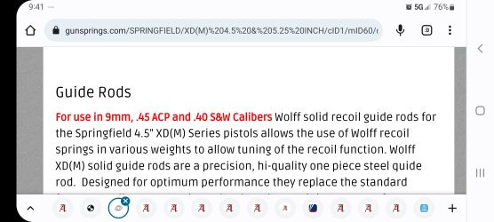

So, looks like I can use the Wolff spring kit I got if I get a Springer guide rod. Springer says it works with the Elite. Wolff has a guide rod, and while I'm sure it'd work, they don't mention Elite anywhere that I can tell, and their guide rod is listed as working with XDM in 9, 40, and 45. No mention of 10mm. Since in my limited experience, Wolff doesn't respond to tech questions, I'm thinking I'll be picking up the Springer rod, unless I learn of a reason not to.

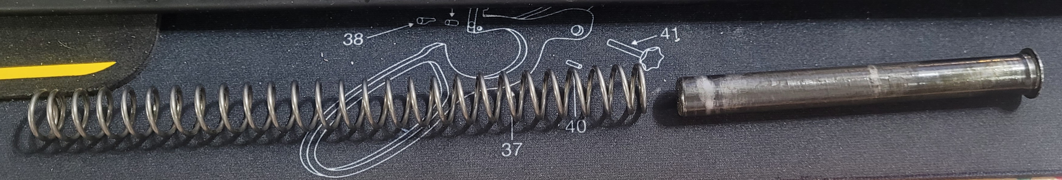

Got the Springer rod, which allows me to use the XDM Wolff springs. Can definitely tell a difference racking it with the 22 lbs spring. Haven't fired it yet. Still have to take the dremel to the ends of the springs.
