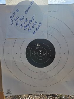

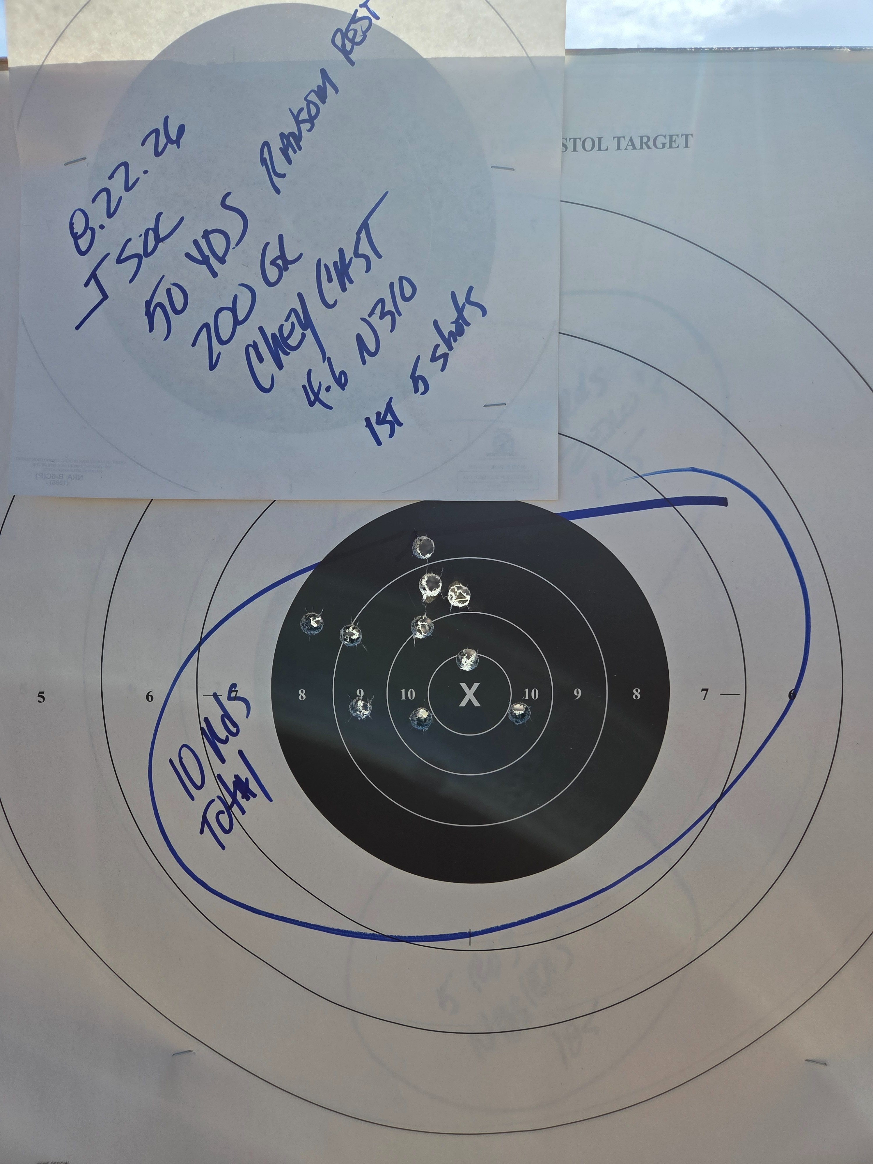

I bought a couple Tisas guns a while back one was a meusoc and the other a jsoc i turned the meusoc into a clone and one of the steps is putting a Barsto barrel in it well the jsoc barrel fit like crap way too loose in the hood and lower lugs and you could push the barrel down out of lock up so I tried the meusoc barrel in it and it fit perfect with real tight lock up with a new 10-8 performance slide stop.

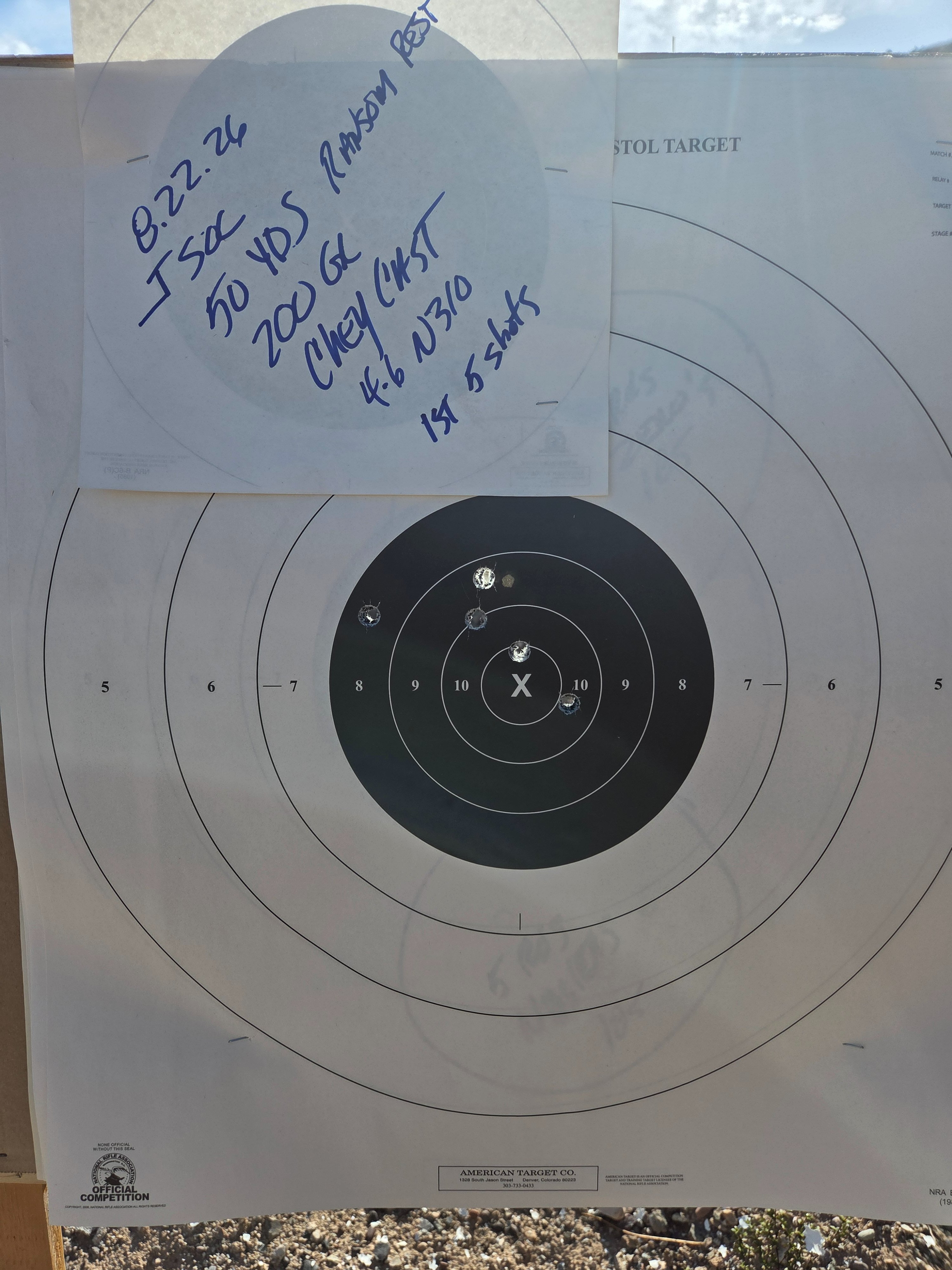

I shot it prior at 25 yards a couple times to test it and it shot really good since I was ransom rest testing yesterday I figured I'd throw it in there and test at 50 it did much better that expected.
Not that it matters on accuracy but I did a complete action job on it might just keep this one around instead of selling it.
