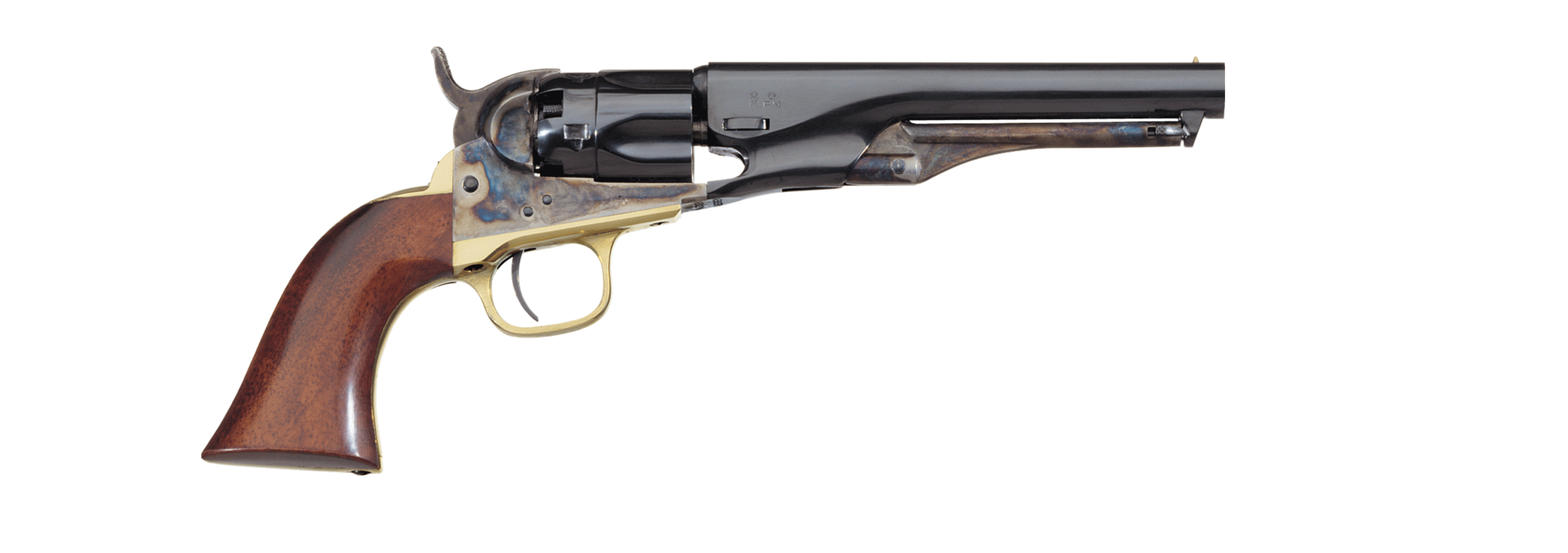

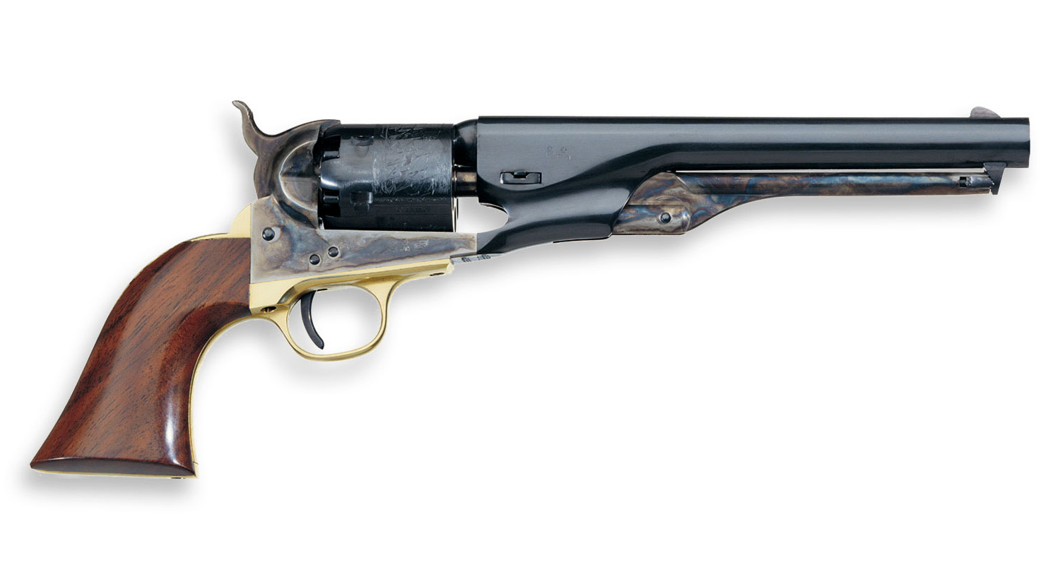

I like the 1861 Navy, and 1862 Pocket Police.

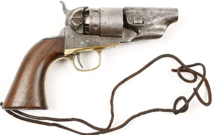

The 38 Short Colt, 38 Long Colt, 38 Special, 357 Magnum and 357 Maximum are direct lineal descendants of the 36 cal cap & ball pistols.
If I'm not mistaken, the 38 Short Colt was a popular cartridge used in the post Civil War conversions performed on the cap & ball revolvers to change them to fire a centerfire metallic cartridge in place of a ball or conical projectile atop a charge ignited by a cap. This transitional cartridge design was initially topped with a "heeled" bullet (similar to what one still sees in the .22 rimfires today) in order to provide an adequate bullet-to-bore seal in these cartridge conversion revolvers.
The actual bore diameter on these cap-and-ball revolvers could be as large as .380" all the way down to about .376". The outer diameter of today's .38 cartridge family is .375". Just like their muzzle loaded predecessors, they were originally loaded with a spherical ball of appropriate diameter, but soon after were also commonly loaded with an enlongated slug having a hollow base to provide a snug bullet-to-bore seal. Both types of projectiles have remained in use. The typical black powder charge was about 20 grains, but could be as little as 15 to 16 grains and as much as 22 to 25 grains, depending on the granularity of the black powder utilized.
The cartridge diameter (OD) for the cartridge conversion was selected specifically to fit the "average" ID of the charge holes on the .36 cap-and-ball revolvers in order to facilitate cartridge conversion without having to completely discard the cylinders. Rather, the cylinder of a .36 cap and ball revolver could be shipped to the facility where the conversion was performed. The factory (or other facility) would perform their "magic" on the cylinder and then return it chambered for what we now call a "38" caliber cartridge. The cartridge conversion cartridges were also loaded with black powder, but with a lesser charge than would've been used in the original pre-conversion cylinder because of the space restrictions imposed by the conversion. It wasn't until the 38 Special came onto the scene that the "power" of the centerfire cartridge in this caliber once again approached that of the original .36 ball loaded over 20 grains of black powder.
Confusing nomenclature? Yes, definitely. Fascinating history? Again, yes, very much so. It fascinates me how each successive generation of firearm technology has "dimensional baggage" derived from older generations. For instance, the configuration and dimensions of the bore and grooves of the .36 cap and ball revolver was directly adopted from .36 caliber muzzle loaders.

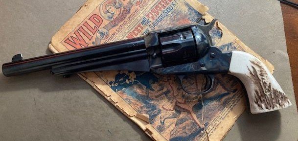

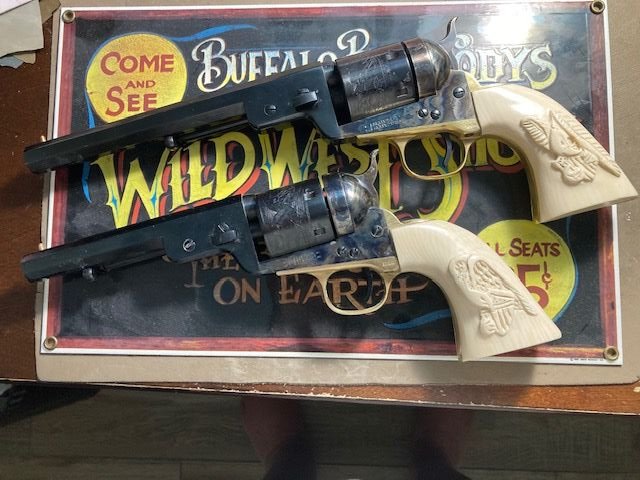

OH heck, I've been sucked for years. these are the .38 sp conversions and my hand carved antique type eagles. ivory is from a piano synthetic ivroy. great stuff. enjoy the gunporn. Ken
