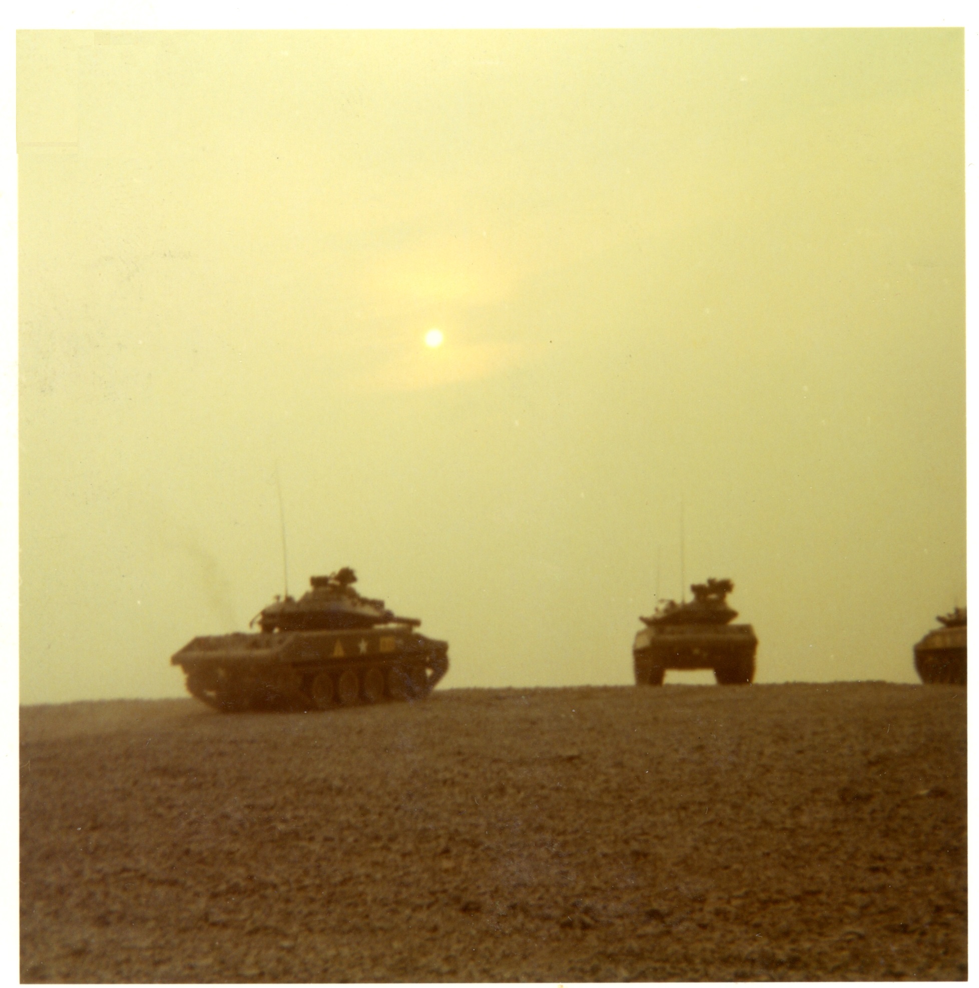

Fog and weather: Post-Vietnam I was at the Armor Board and one project was an upgraded VSS-1 Xenon searchlight. We did all the work, at night obviously, at McFarland-Oliver Special Operations Tank Gunnery Range (MFO). Ft. Knox is subject to serious fog near the Ohio River, and MFO is out Porter River Rd. and the Salt River/Creek runs down the left of the range. Just driving out and down to MFO you could go from shirtsleeves to field jacket in a few hundred meters, descending into the "bottoms". Many was the night we could not test due to fog...we'd hang out for 2-3 hours just to make it look like we were "trying", then call it a night.

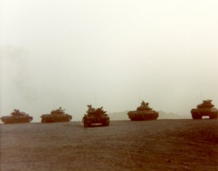

In M551 Sheridan School, before Vietnam for me, we often had gunnery on the Sheridan delayed to as late as 1000 hrs. in the morning! Note the position of the sun in these pics I took at D/1/1, the M551 training company. To me, this no-go stuff for a beam rider, and we're only in Kentucky!

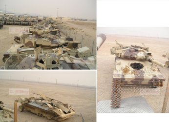

Your experience with all the maintenance to keep them going is exactly what killed them at NTC and replaced with the OSV's. I was out there in 2003 when the fleet started being dismantled.
