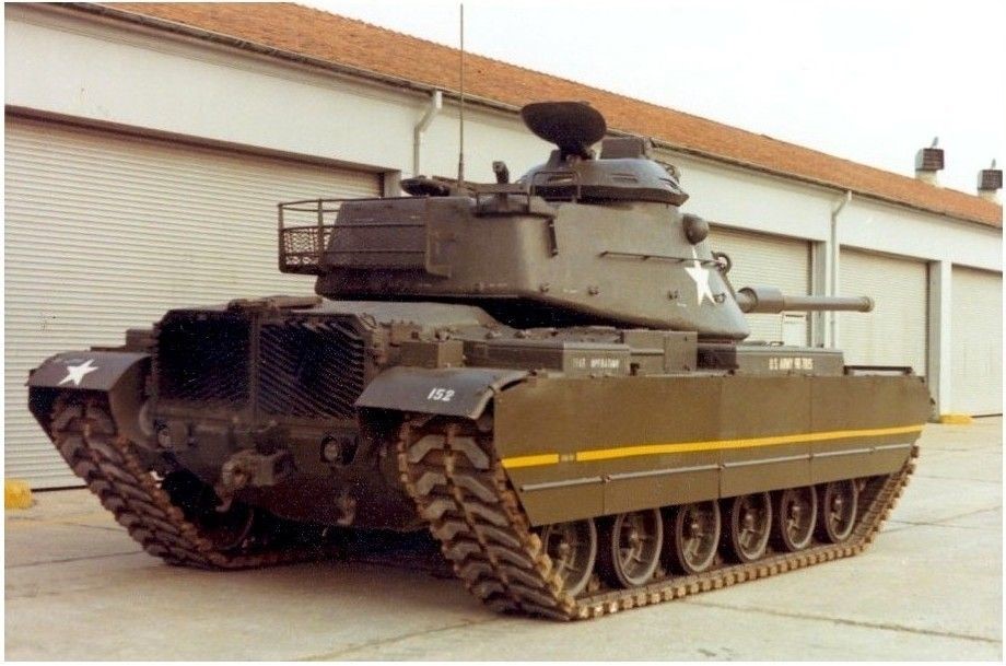

Speaking of "death rays", when I was on the "Hot Pants" M60A1 track skirt project, we had just finished the Hughes LRF test and still had the vehicle, as well as it's array of "Danger-LASER Light" signs. The idea was floated to stuff some impressive pipe into the cupola, hang the LASER signs on it and run an uncaptioned photo in Armor Magazine just to get the Russians jumping through their *** trying to figure out what it was.

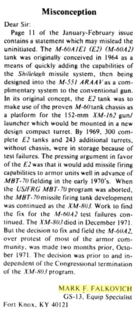

I was on the M60A2 Initial Production Test at the Armor Board in 1973, which was ongoing when the October War broke out. Guess what contributed to the acceptance of the A2 when POTUS promised to make good the IDF tank losses in the first couple of days.
The archival collection of the M551 & M60A2 development from the named GS-13 below at Combat Dev. Cmd. came into my hands years ago...it's a very sordid story.

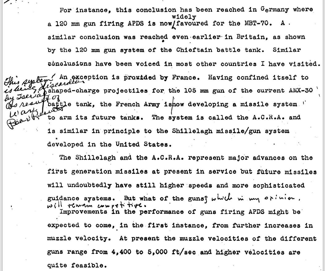

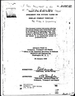

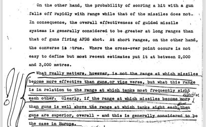

Speakers notes to the Armor community leadership. The speaker was the invited tank historian, the late Richard Ogorkiewicz, author/consultant to any number of Western powers. The text is from one of his several books, then in preparation. From the archives of a Combat Dev. Cmd. member, I do not know whether the speaker or the audience member made the notations.
They loaded in opposite order....read the second attachment first.

There really wasn't an issue with the "gun" specifically...it was that existing FCS could not cope well with ranges of 2K and above. Entirely reasonable ranges for European combat, but our hit rate with 105's was not great beyond 1,500 meters (The Army's own figures for first round hit probability were from .27-.38).
The language of the day did not include "fire and forget", it was expressed in missilery as "homing", which was recognized to be limited by technology to at least 10 years (it turned out to be 30).
The default, and the great limitation, was to accept command guidance. And it didn't help that the time-of-flight was obscene. It was the one parameter that the Army was willing to accept on the M551 just to get it into production, but rejected it out of hand for the future MBT project (at the time, the MBT-70). In the event, we did exactly that with no modification or improvements (nor would there be any...the R&D team for the MGM-51 dissolved in 1971 when it was fully commoditized.

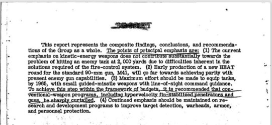

I can't speak to the anti-armor community, not being sure what that is but the two documents in the Armor community that drove the armament decisions of the '60's were ARCOVE & "Mobility, Firepower & Protection", 1958-59. F&F does not occur once in that or any documents that recently followed (to include the Tripartite Conferences in Armor). I'm sure the term existed in the aviation community, but they have a different budget and capabilities, esp. in 1958.

Glad to know there are those who appreciate it. Some years ago I came into possession of digital copies of many archival documents (that have long since been de-classified). Much of it never intended to see the light of day, it lays out the history of tank development here most especially since WWII when a whole area of tech was about to open up. Much of it from a senior figure at Combat Developments Command with emphasis on the MGM-51 Shillelagh, M551 Sheridan, M60A2 development and fielding, among others. His archives indicate a very specific emphasis on documenting the development history of these subjects, certainly in part because the sordid nature of the story.
It's all very compelling to me because I served on all of those systems and worked for the Armor Board where we tested aspects of all of them.

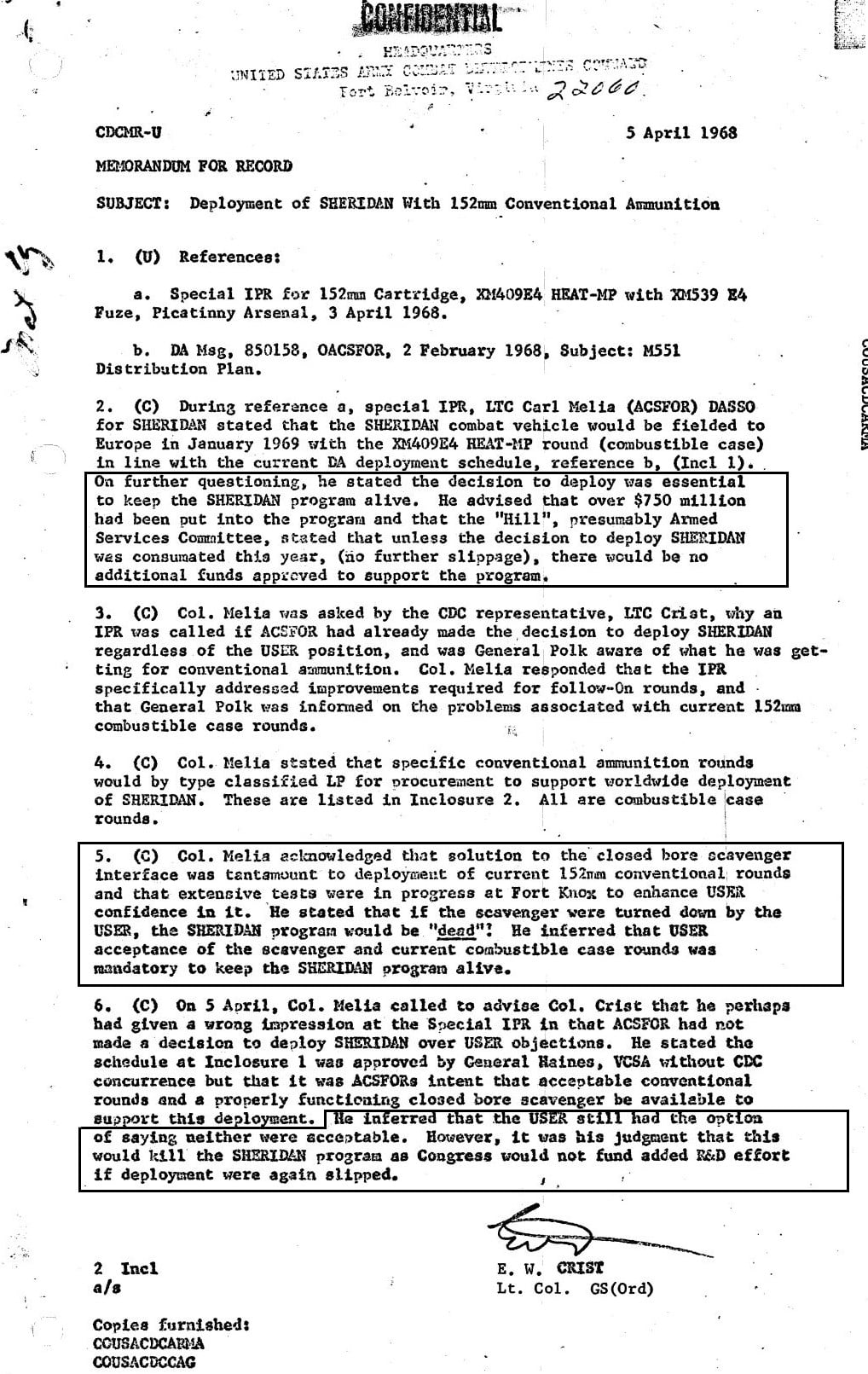

Another GS over at CDC, a former LTC, felt compelled to relate a conversation he'd recently had in the form of a "Memorandum For the Record". You will recognize this as an unsolicited testimony to be read into the record "to whom it might concern" now or in the future. In effect, it both relates a disturbing irregularity as well as putting other on notice what they might expect in the way of testimony should it be investigated.
I have been advised by those well above my pay grade that an O5 would not likely generate one of these unless he had support from above. This would be a career-ending move without support. The highlights are mine from another application...

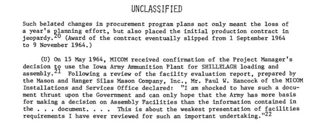

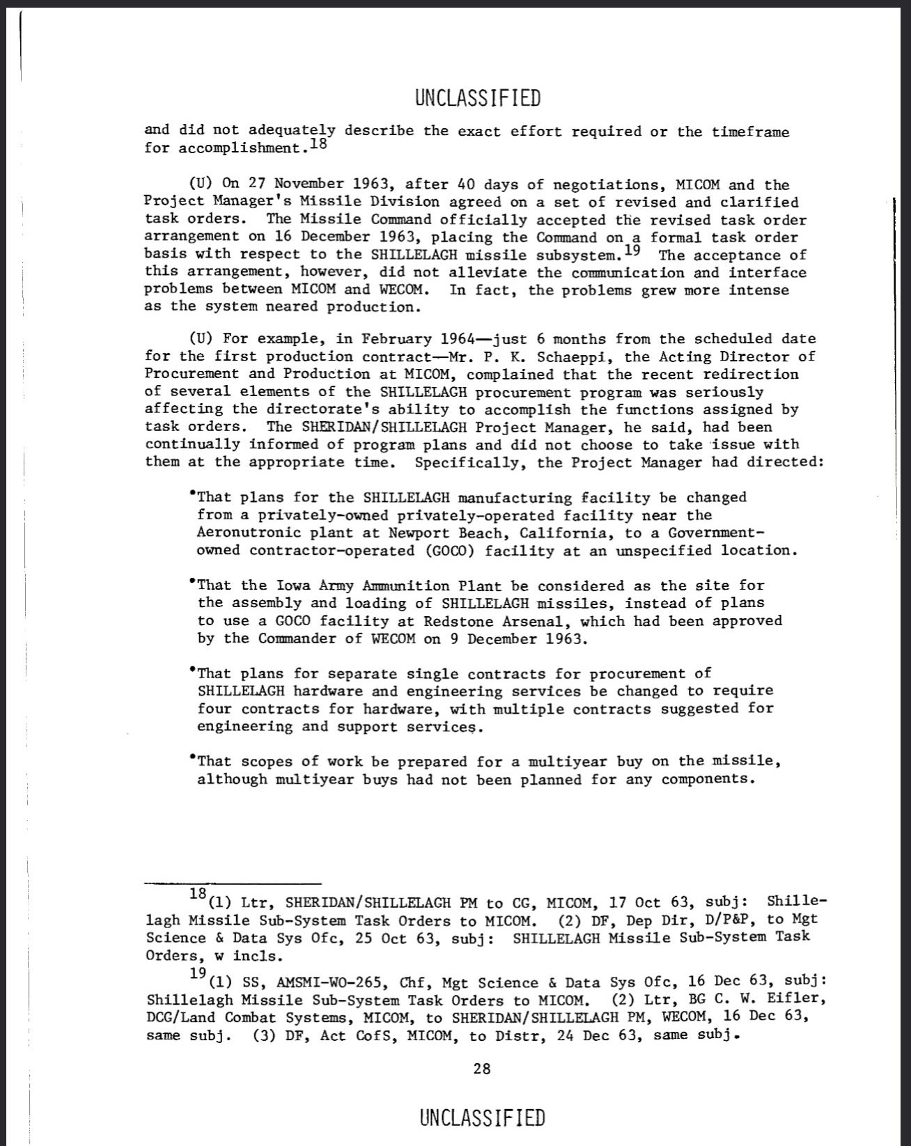

The issue of Project Management for Sheridan/Shillelagh (the two programs were combined in 1964) and for years the PM was essentially what we call today, a "czar". He could issue requirements to various commands in a manner much like "Silverplate" in the Manhattan Project. This was much resented and Missile Command was essentially getting "task orders" and being gofers for the PM. As MICOM was commanded by a MG Zierdt, this was unwieldy. He eventually went on record as saying the situation "was not working and would not work". This is essentially an ultimatum from a CG. "Fix it or fire me". They did change it, after years were lost.
Here are a few examples of what happens when a PM runs amuck with no checks or balances. Note especially the memo from the inspection of the Iowa Army Ammunition Plant....one of the most damning assessments I've ever seen in an official memo that wasn't in the heat of combat.
