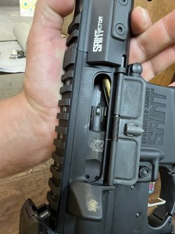

I have a St Victor AR pistol in 300 blk. I took it to the range with my sons to let them have some fun! 1st magazine was flawless! Second mag would not cycle new rounds. Pull the trigger and “CLICK”. Same brand magazine. Even reloaded original that ran fine first time but same problem. Noticed spent cases had a flat spot. Any thoughts?!
Not a lot of information to go by but the picture looks like failure to feed which tells me you don’t have enough gas pressure to operate the BCG for a complete cycle.
Are you using subsonic or supersonic rounds?
Check your adjustable gas block, you may have to make an adjustment or maybe the adjustment screw fell out, it’s been known to happen.

Same brand of ammo both mags ?
When was the last time the bolt and gun had a good cleaning ?

Yes, same ammo in all mags. New gun only 30 rounds through it. Even original “flawless” mag wouldn’t cycle after it was warmed up from firing.
Are you using magazines made for 300BO? They do have a different follower then .556/.223 magazines.
As mentioned by @KillerFord1977 did you take it apart and clean and oil it before shooting it? AR’s like to run wet especially during break in.
