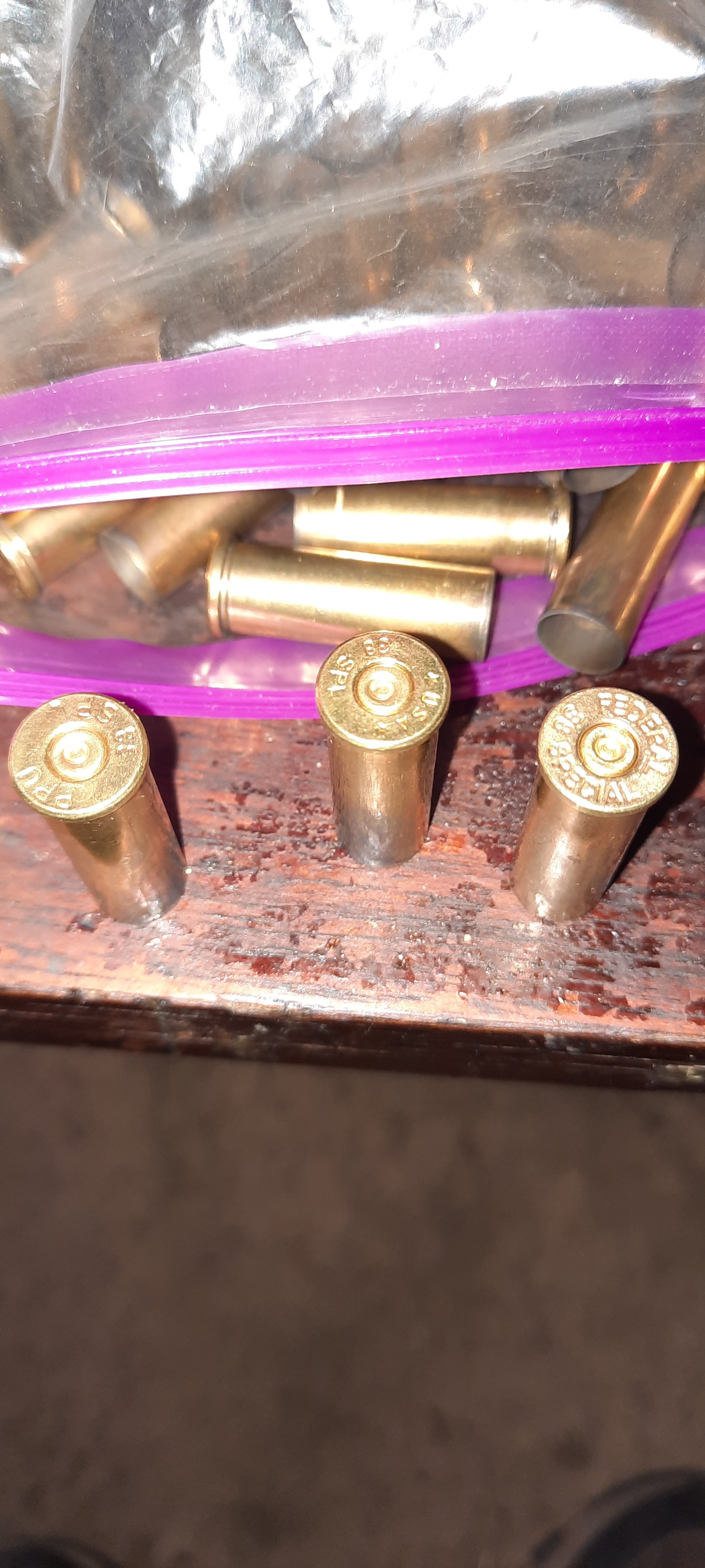

Well they arrived, 3 day shipping can't complain there.
I forget that most machines don't have adjustments for primer depth. I'm loading on a Dillon S1050 that has an adjustment also on my RL550 there is a stop screw that limits the seating depth. I would suggest that you make sure that you firmly seat your primers on other machines.
Well I loaded 50 of my normal 130 RNFP. And used the new primers. Shot them in my uberti stallion. All shot just fine. Guess we move on to a few more.
