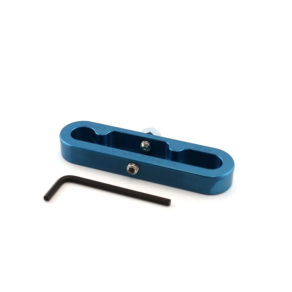

1911 Extractor Adjusting Tool Weigand®
Weigand's patented tool sets 1911 extractor tension against an adjustable stop, so there's no guessing with pliers or a vise. Allen wrench included.jackweigand.com
i watched the Bill Wilson video on how to adjust an extractor, quite simple actually, but i prefer the tool.
what i like about the tool is that, the extractor cannot rotate once the screw sets up against it, and gets bent off center.interesting. thanks. it did the bill wilson method and it worked just fine. barely had to bend it.
i understand the need to have it.what i like about the tool is that, the extractor cannot rotate once the screw sets up against it, and gets bent off center.
then just reverse the extractor, if you need to "undo" too much tension.
takes a wee bit more time with the tool, over Wilson's way
but being a former wrencher.......and a fan of Tim the tool man Taylor.........i just had to have it.
