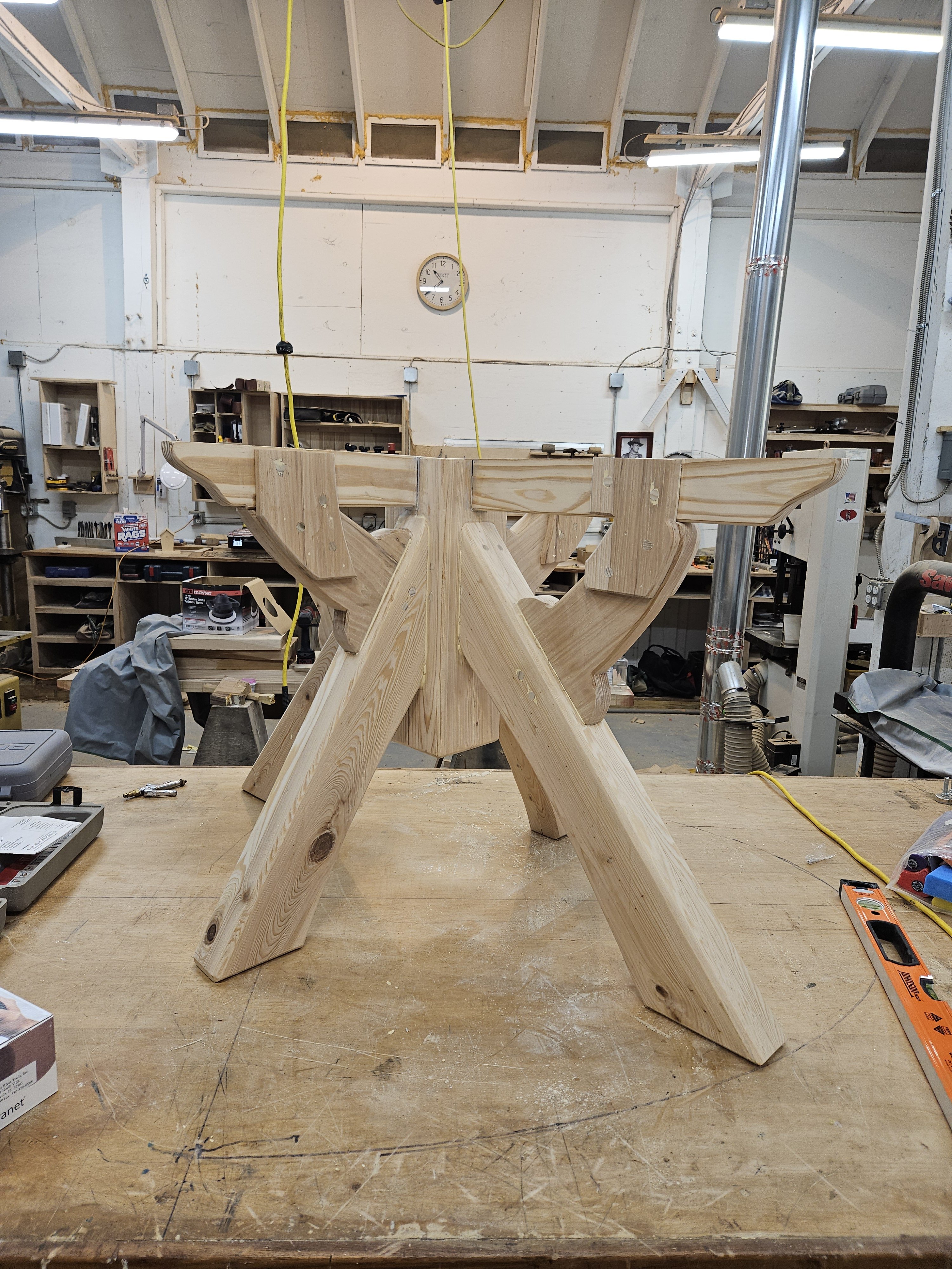

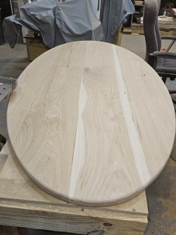

That would be too much like work! Here is the oval top for this one
Looking real good. I got into furniture making about 10 years ago. Definitely not at your level. I turned our two car garage into a pretty well equipped shop. I considered my work as an advanced hobby. I won't tell a long story but COPD put a halt to my woodwork, couldn't handle the dust. I really miss woodworking.
