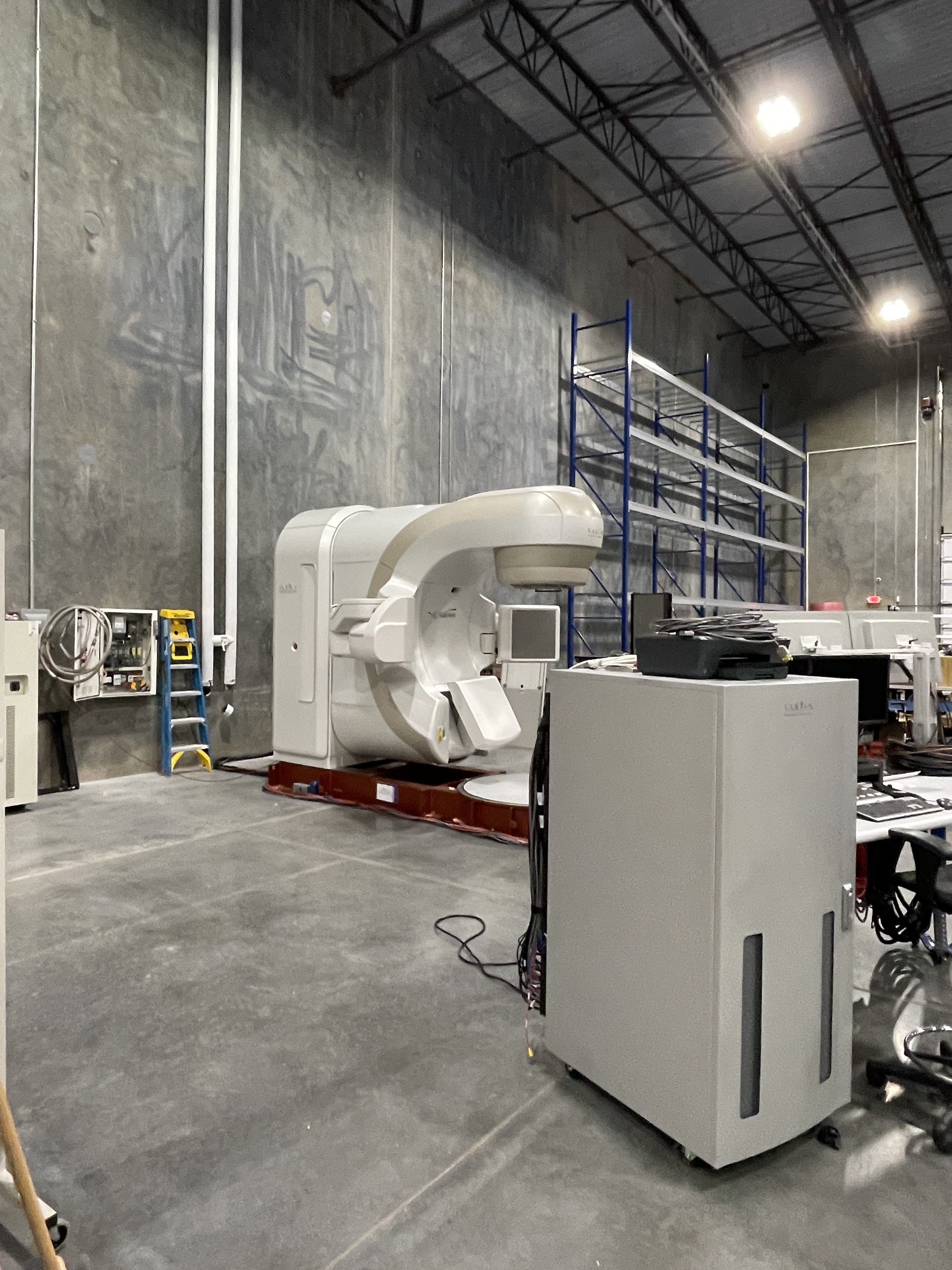

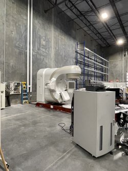

looks SCARY AF
Less scary with covers on. This is what patient sees. Still with high voltage firing there is a loudish buzz and it’s 10k lbs rotating around you it’s pretty unnerving I’m sure. And you are likely in there because you have cancer so…

How do you test them after they are manufactured to see if they are scanning correctly?
We are not manufacturer, we are independent service org. After a repair in the field the machine is ready for qa. It always must be checked by site physics to verify.
When we sell a system we perform manufacturer acceptance testing with physics
mechanical tests like demonstrating all axis rotate around isocenter which is defined by point beam leaves exit window and the central axis of gantry bearing. This must be .5mm for gantry and beam collimator and .75mm for table. Verify readouts etc
Then beam scanning for emergy and flatness and symmetry.
These are therapeutic radiation systems megavoltage beam. They have diagnostic imaging for patient set up as well.
