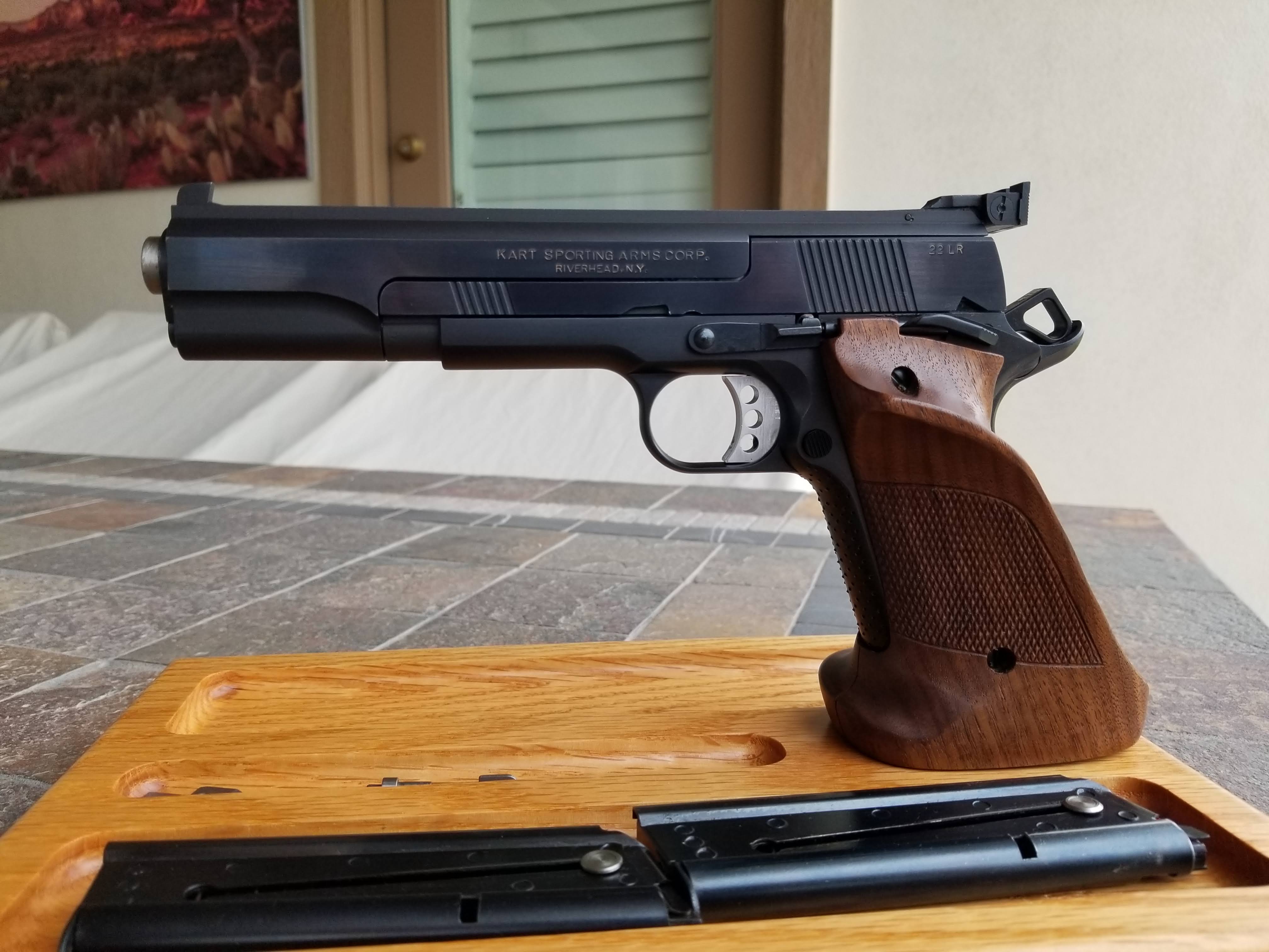

Picked up a Kart .22 conversion been tuning on it and the magazines I finally have it running with Eley target yellow box still needs more testing this thing shoots lights out with the Lapua pistol king ammo hope I can get it to run 100 percent with it.
