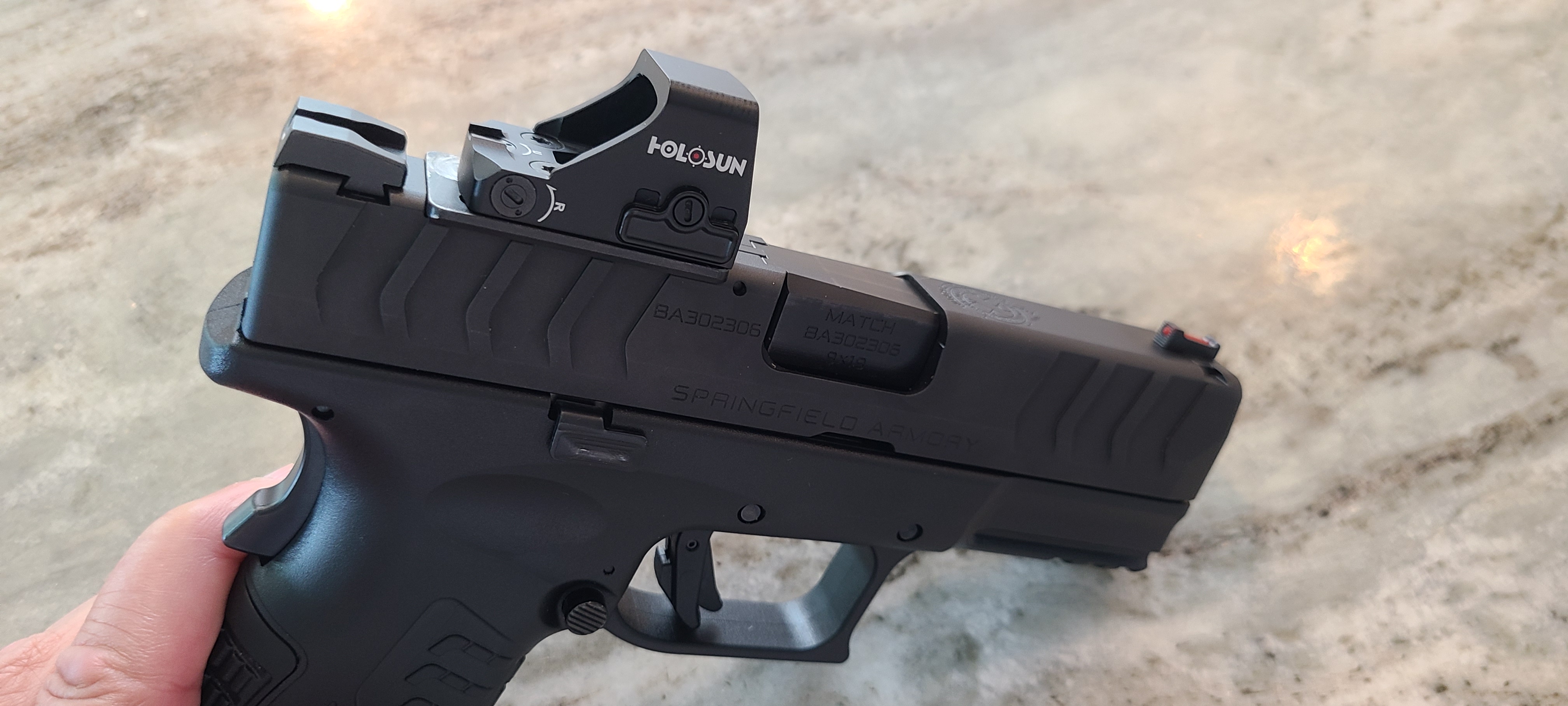

ok so we finally got this done! The 507k x2 mounted on the Elite compact. I got the mounting plate #2 from Springfield. I had to use a Dremel rotary tool to grind off the one front tab, and to grind down the 2 rear tabs about half way. The plate fit the gun perfectly, and now the optic fit the mount perfectly. The only problem was the screws supplied with the optic were too long. I didn't know how to trim them, so I brought it to my local gun store and they shortened them. All now firmly mounted.
That looks great! Also seems like you don’t get that wide overhang from the other rds.
looks like that back site notch on the holosun may still work as well?
