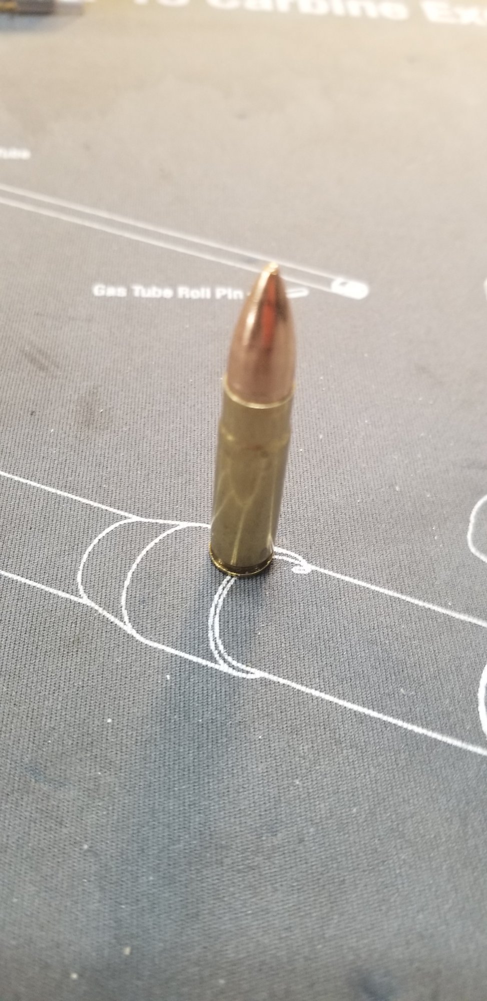

My new never fired SIG brass runs 1.357" and the once fired Hornady is 1.360"
Lyman gives a case length of 1.368" and a trim to 1.358"
Got to have enough crimp to hold the bullet from setting back in the case due to recoil. had a time with that on the 357SIG round. Got a Lee factory crimp die and fixed it.
That in mind I have a Lee factory crimp die for the 300BO also.

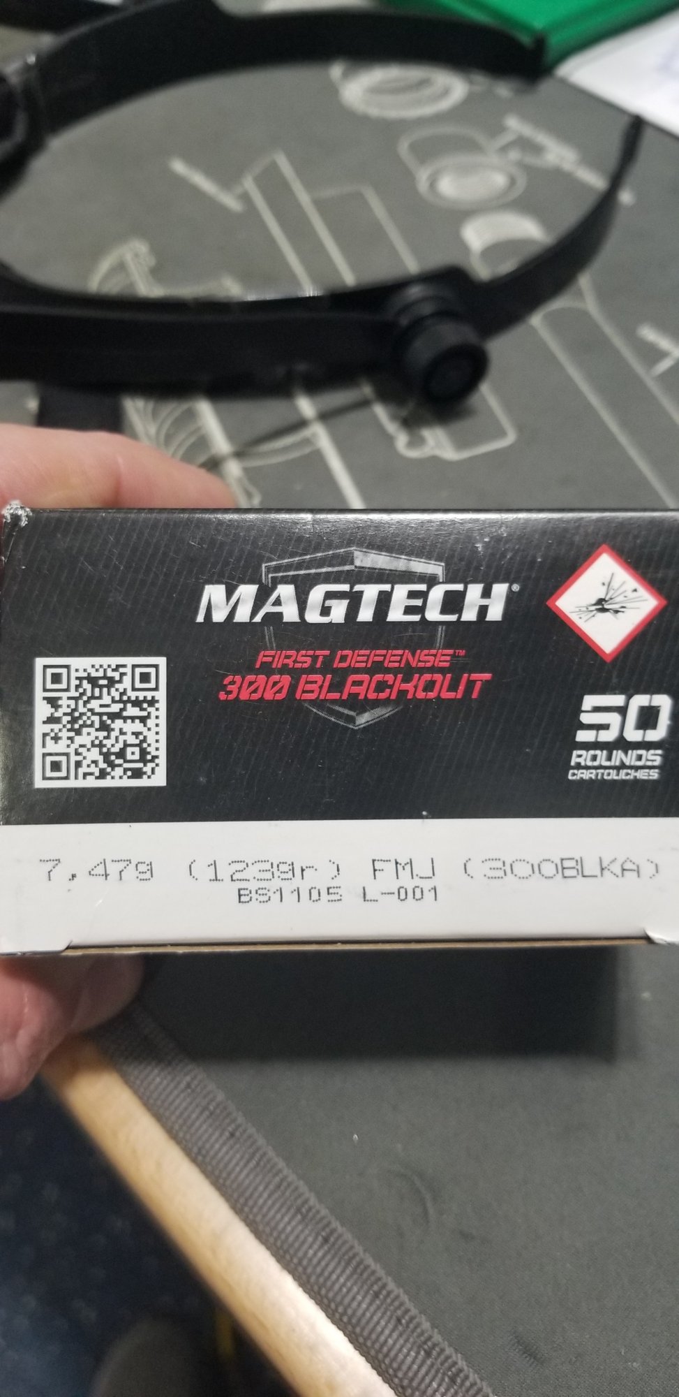

123gr Lapua fmj @ 1.976" w/ lil gun 18.8gr est velocity @ 8.5" barrel 1,909v = 1,003 fpe
Right now I'm just wanting too get 1k#s of muzzle energy no matter of bullet weight, unless for the heavy ones that don't have enough room for powder.
