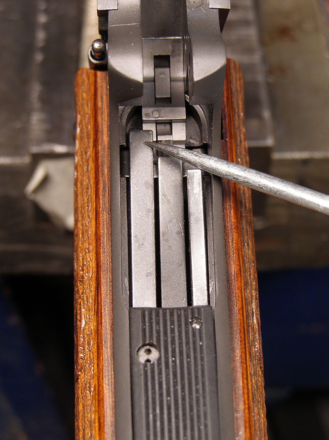

the technical answer is probably you sear spring is bent weak.....maybe someone in the past did a trigger job? Either way I like my grip safety’s extra springy so I always adjust my sear spring to give extra pressure to the grip safety. Look at the picture most standard 1911 sear springs will have 3 fingers. The finger all the way to the right (the picture is pointing opposite of what you need, found on internet) gives the grip safety it’s springyness. Pull that one slightly out Towards the grip safety for extra pressure. Towards the frame for less. Just a little goes a long way.

So if you are not comfortable with precedure contact a pro or Springfield.
Thank you! I posted a vid, and after seeing your instruction, should fix it. Again Thanks to everyone.
