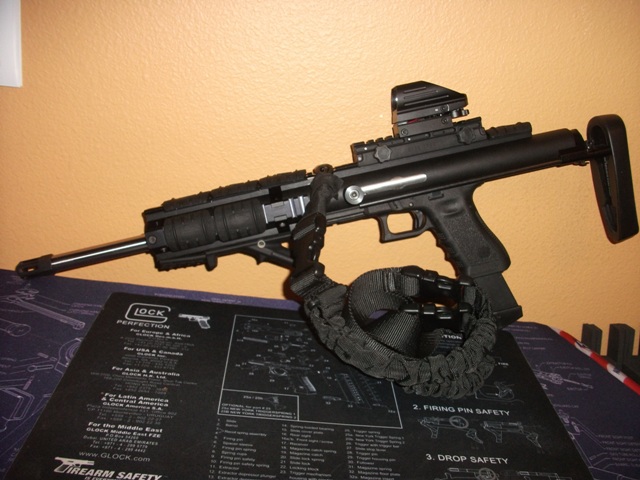

For a PCC I went with a MechTech carbine conversation. I used a G22 lower and went with .40 S&W. The only thing negative I can say is it's not designed to lock the bolt to the rear after the last round. They are available to be used with XD lowers.

They might not lock back, but function incredibly well. I have 1 for my G20/40 and loves very hot ammo! I never had a ftf or fte issue with more than 500 rounds so far!
