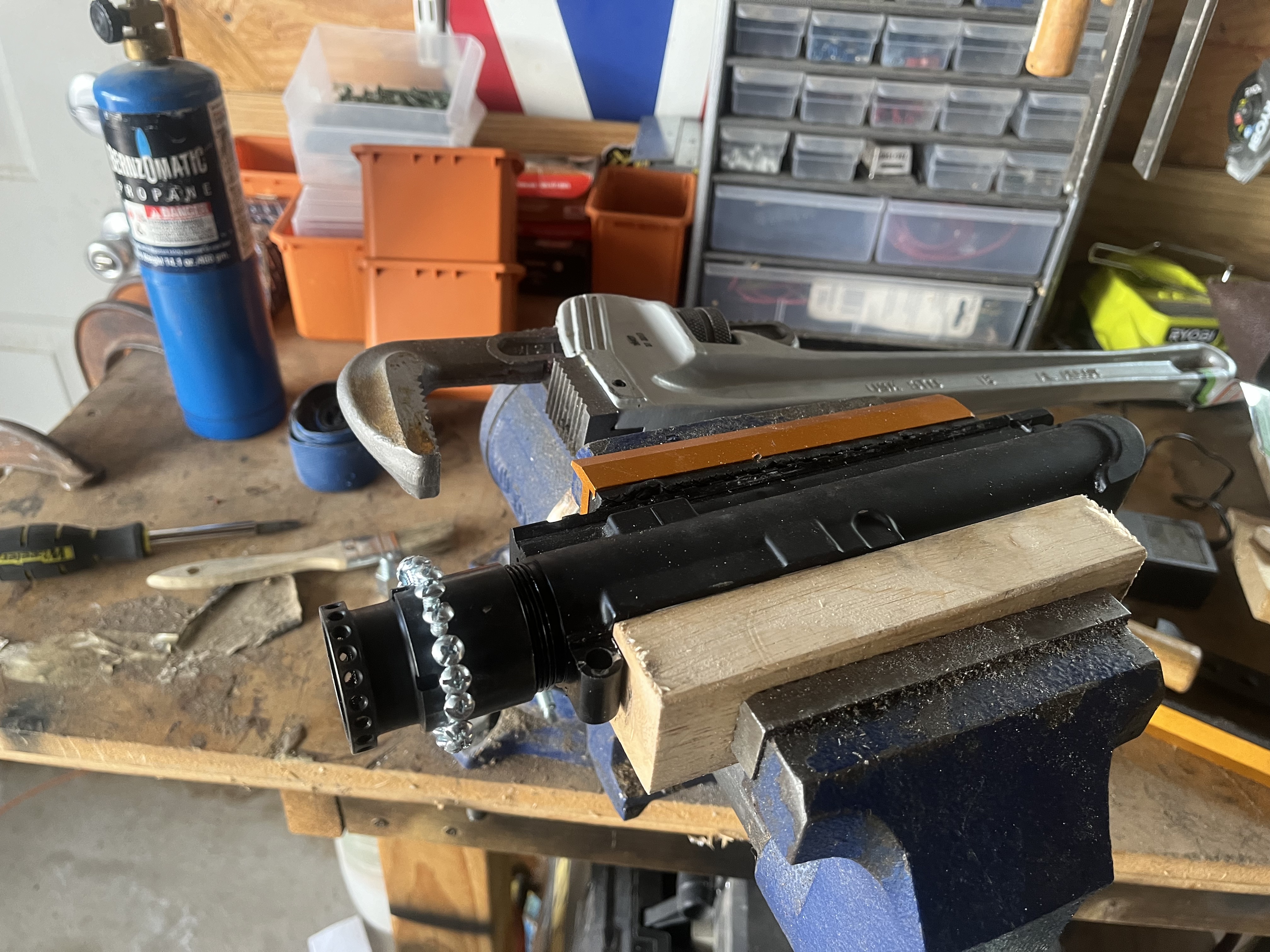

I decided to go for another barrel and ordered a Faxon fluted 5R 20" barrel from Optics Planet. I have not tested it yet but the old barrel is off the receiver and it is a loose fit! I can rattle the barrel in the receiver (I can tell you how to get the barrel nut off with a pipe wrench and not damage the barrel nut!).
The new faxon barrel is way different. It will not just slide in. I have to heat the receiver a little with my gas torch and then it slides in neatly. Likewise to remove it a little heat to expand the aluminum receiver is required. That is how it should be. I am really shocked. The diameter of the Springfield barrel is 30.16mm and the faxon is 30.32mm.

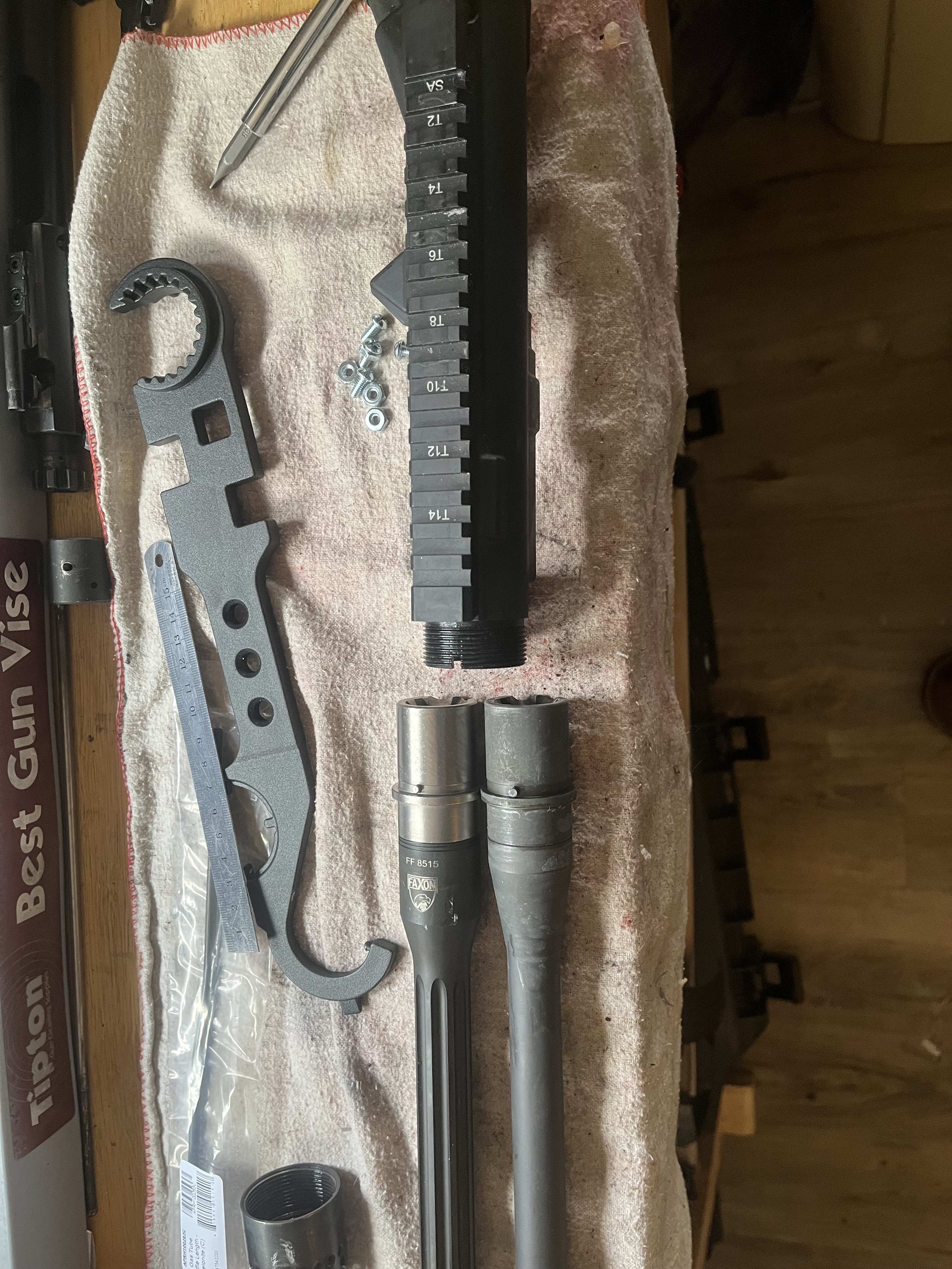

My new barrel is in just waiting for the gas block to arrive tomorrow. I bought an adjustable which is claimed to have 15 positions. My service rifle was a FNFAL and that had an adjustable gas block which had 6 position if I remember which you could adjust in action. None of this having to push a rod down the hand guard to adjust it. Due to the tight fit of this barrel and its high quality finish. I let you know when I can get to the range in a few days. The picture of the 2 side by side the quality difference is obvious. The other picture shows what I did to get theBarrel Nut off. I had to use heat but I also needed a 14" pipe wrench. I bought a pack of 8-32 screws and used them to avoid damage. It worked great but I still had to whack the pipe wrench with a large rubber hammer twice!
Putting the new barrel in I put a little TW25B grease on, heated the receiver and it just slide right in. What I call an interference fit. I put anti seize on the threads. I was able to tighten the nut with an armourers wrench but no way of torqueing it. However with a range from 40-60ftlbs I reckon I am somewhere in that range.
