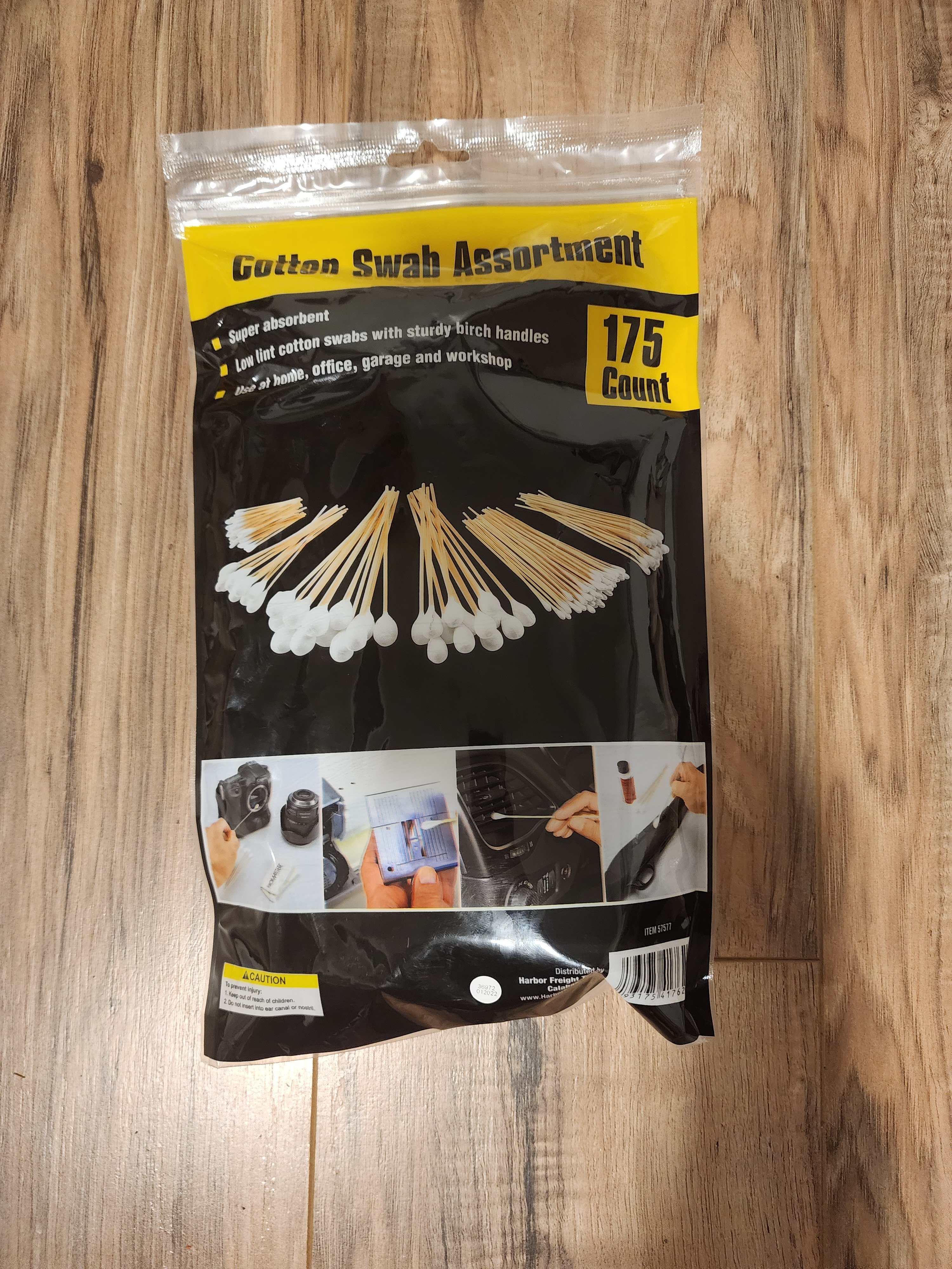

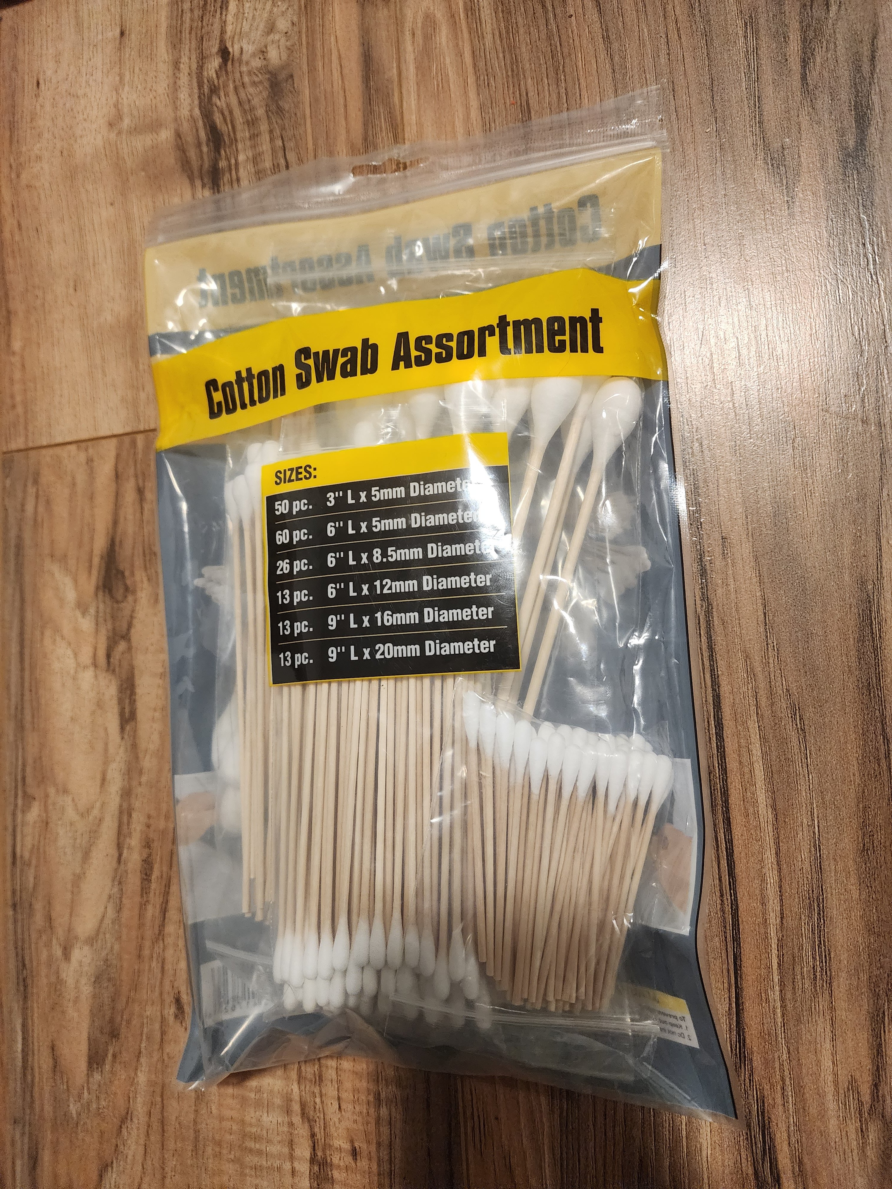

Honestly, I don’t worry about inside the frames of my polymer guns, I just use those big cotton gun cleaning swabs, they look like Q-tips but on steroids, I use them dry, never had any issues with them, use them dry, seems to work well for me
Harbor Freight sells a great assortment of multiple sized wood handle Q-tips for cleaning. I picked these up last week.
