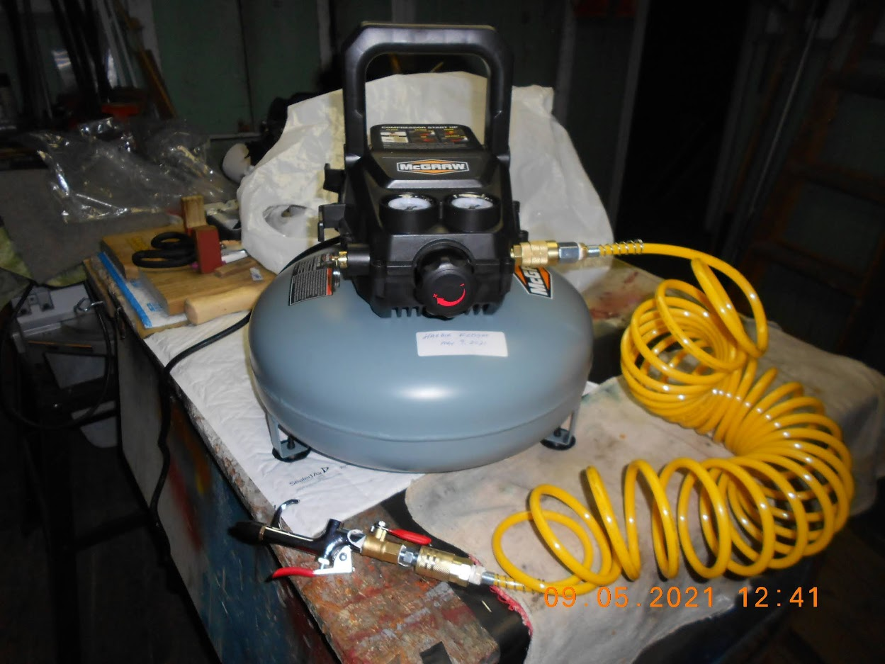

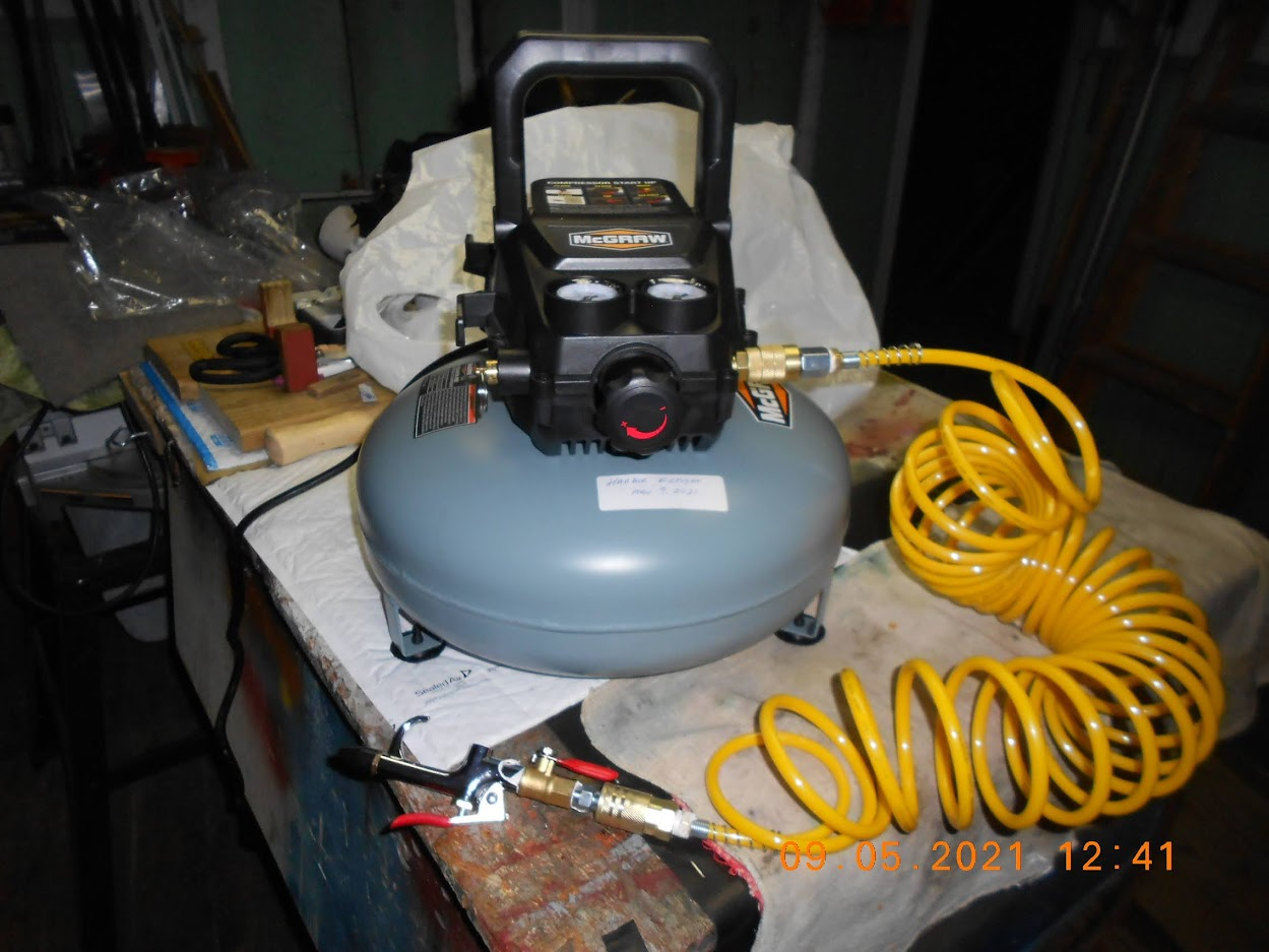

Good point about the low volume of air. I feather the blowgun handle to limit the flow. Turning down the pressure regulator can help also. I also keep a couple cans of canned air on my cleaning bench for more delicate parts.
yeah, i have a "valve" attached to the blow gun, that adjusts the air flow.
it has a red handle on it, attached right to the blow gun.

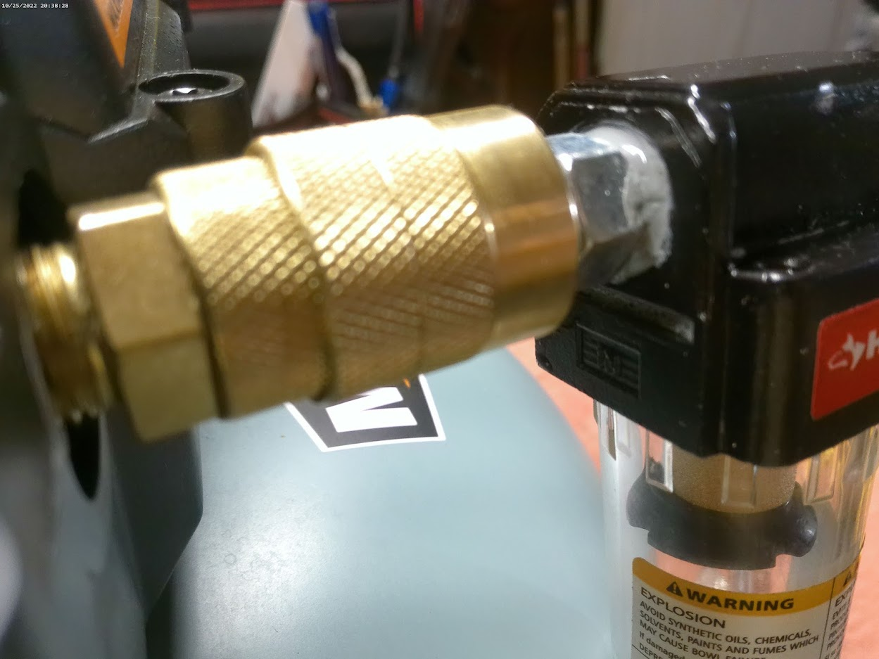

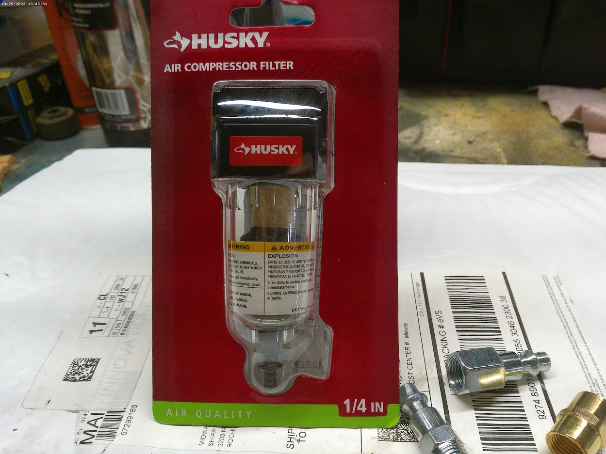

ok, so i went to Home Depot, they had 3 filters in stock.

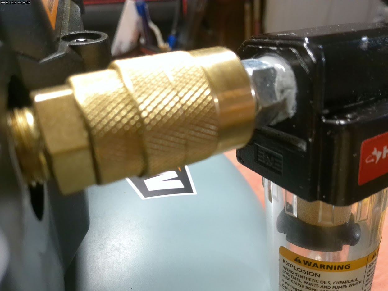

it is made in China, so like that video, the guy recommends using that Plumbers pipe sealer (liquid) over the Teflon tape.
i had air leaks no matter how much i tightened the fittings.
once i applied the plumbers pipe sealer (also known as pipe compound) all leaks disappeared.
with tax, just over $17.00
and i had "spare parts" of like an extra quick connect coupler, and nipples from when i bought the airline kit with the air compressor.
the plumbers pipe sealer/compound, i had in the basement

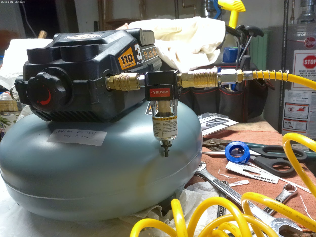

in this pic, the Teflon tape was used.......not a good idea
in this pic, both sides got the plumbers sealer/pipe compound

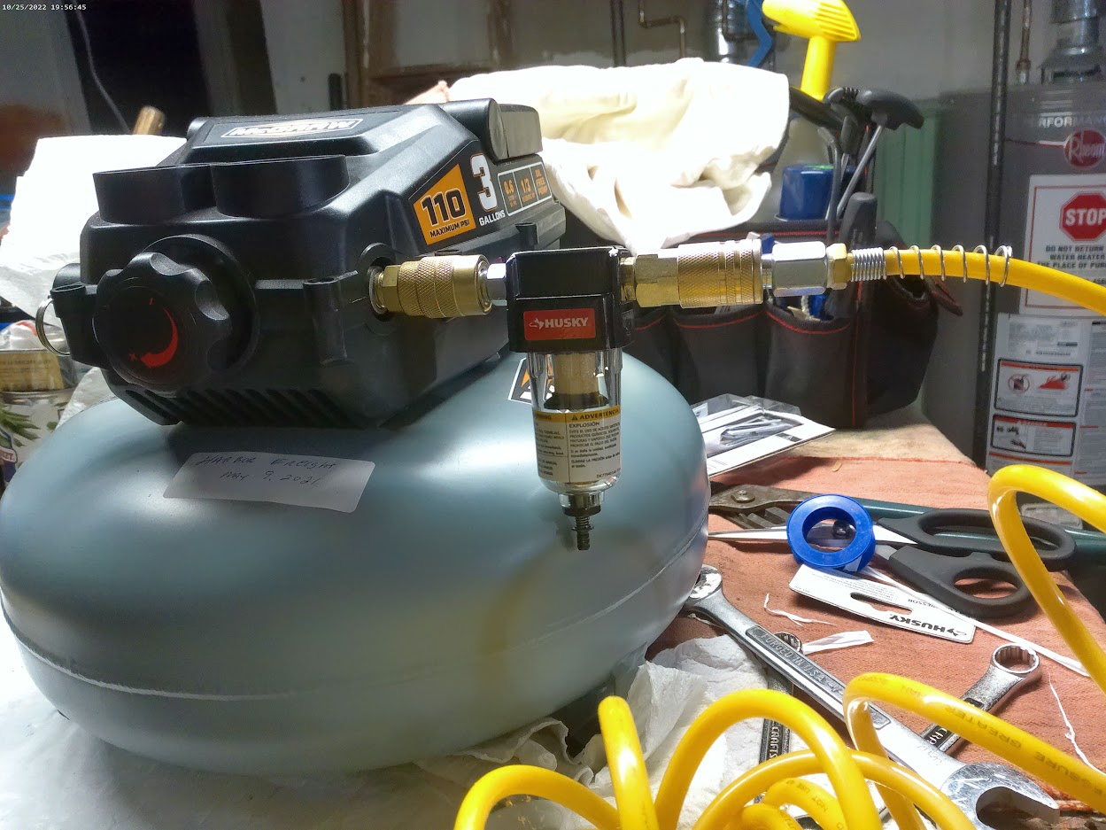

now, does this filter work..??
of course it does. but only a "tiny bit" of water came out, when i went to drain it.
but that tiny amount "could have" been blown into any one of my guns, polymer or metal.

Teflon tape was not developed to "seal" a threaded joint from air or water leaks on tapered threads. It was specifically designed to lubricate threads to make tightening (and loosening/removal) easier. Pipe dope is designed to seal leaks (multitude of choices available). Using both is a good idea on the application under discussion. Even if tape oftentimes seals your shower head just fine, that was not its original purpose...
Incorrect. Pipe dope also is designed to lubricate the threads so you can more easily get the pipe tightened to the point it won't leak. Often when I find a leaking brass tee on a cast iron gas main the tap hole is chipped and wallowed out. Often I can use green dope, a layer of teflon tape and then a thin layer of white lead ( regular pipe dope) and get it to stop leaking. Cast iron mains are low pressure, typically about 8 lbs. And we are in the process ( nearly done actually) of abandoning the CI and installing plastic intermediate pressure ( typically 20-30 lbs) mains. No fittings on the plastic are doped or taped. They are either mechanical with a rubber insert or more often they are lycofit couplings, which is kind of like a tapered step down bit that is forced into the plastic with a machine and then a sleeve is forced on over that. Anything above 1 1/4" can also be butt fused or electrofused. Recently they began giving us the option of shark bite type couplings but none of use trust them or use them. Back in the day there was a similar coupling called an Ampfit and they are leaking all over the place now.
Also tapered threads don't typically get doped. i used to tell my old gasman ( laborer) that all he had to do was touch the pipe and it would be "Pre-doped" :p. Sometimes on some fittings they have o rings. On a flare fitting with a tapered coupling there is no o-ring and typically yellow teflon tape is used, though just as often no thread " Sealant" at all is used.
Now as for plumbing ( Water) they have a grey dope that I think is called liquid teflon or some such thing that works 1000 times better and is easier applied than teflon tape.
It is more accurately called a water trap. It does have a filter, its the sintered bronze filter. You're likely not going to need to filter the air, but the filter probably helps to trap the water by slowing down and redirecting the air. And that is how the water trap works, the air passes through it, gets slowed down and redirected and should catch the water before the air then makes it way out of the filter and down the hose.
Cheap air compressors and water traps are not going to catch all the water possible, I still get water sometimes out of the hose.
Seen guys post they have 3 water trap filters, in series, on their air compressor.
What I have found with my on the inexpensive side air compressor.
Draining the water out of the tank before the job helps.
Using a filter/water trap helps, but can't guarantee it will catch all water.
Having the compressor fill the tank and then wait to let it cool off, works the best to let the compressed air to cool and allow the water condense out of the air and collect in the tank.
Avoid having to run the compressor constantly, this is only time I get water out of the end of the hose from what ever device is connected to it, despite draining the tank earlier and using a filter/water trap. I use enough air that the compressor has to run constantly to keep up, this is where you end up with air still warm from compression coming out of the hose carrying water with it.
If you're doing something that you want to avoid water coming out of the compressor, and you've run the compressor a long time, take a break and let the tank fill and cool off.
If you're doing something critical that you can't have any water in the compressed air, like using a spray gun to paint, use a desiccate filter at the end of the hose. Even then water can still make it through.
One of my Cerakote sessions, I blasted the slide first which takes a lot of air and I had the compressor running constantly for a while. I turned around and started to spray cerakote way to soon, and suddenly one side of slide came out horrible, almost a totally raised bubble on the entire side of the slide. I also had been using that one desiccate filter for a while as well. I suspect water in the compressed air had made its way into the spray gun and that is how I had a 1 second of the spray come out horrible while the rest was normal.
Using a water trap on compressor is best for just about everything. Even filling the tires on your car. Water that gets inside the tire will interfere with linear pressure change with temperature, and the water will help to oxidize and deteriorate the inside of the tire. Dry air is safer, performs better and helps preserves your tires.
The biggest advantage to using nitrogen in tires is simple the methods to provide pure nitrogen assures dry gas going into the tires, while compressed air most methods of supply, while many times cheaper, ends up with water in the compressed air.
Husky calls it a filter.
so it is a filter.
People call things by the wrong name all the time. I love the latest version of the Ford Explorer's owners that call there crossover car a truck.
When company's get caught using the wrong name for something, they claim its a "Marketing Term".
Point is, the way it removes water is called a trap. There are lots of traps people call filters. And it is not going to trap all the water in the air passing through it.
