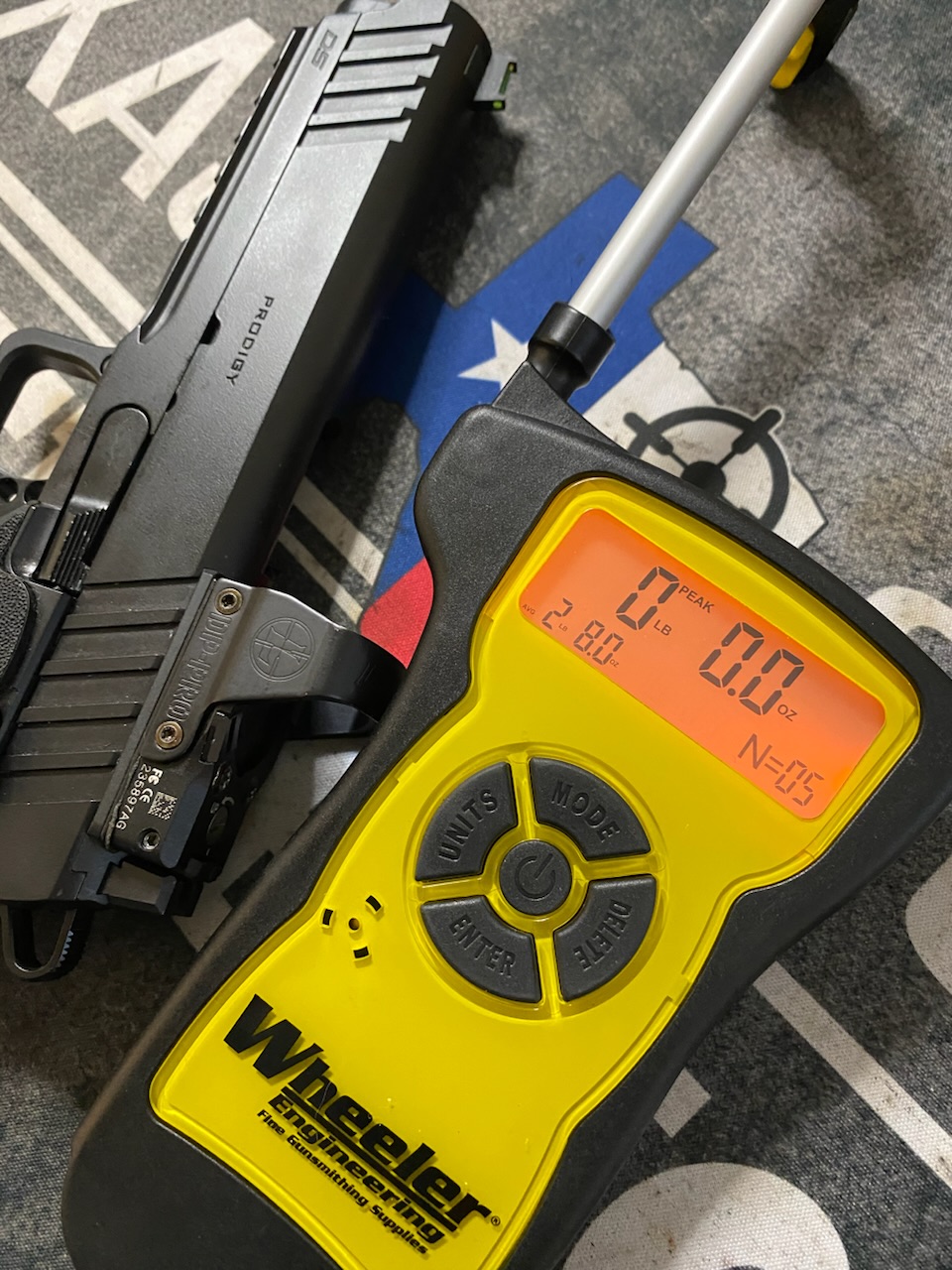

Thought I would share this. After 2000 rds my Prodigy has a 2.5lb trigger pull according to a 5 pull average on my Wheeler gauge. Trigger is stock.
Any chance you could do a short video to demonstrate how you are doing the pull using that gauge?
I have the same gauge, but I'm really not positive I'm doing it right.
Just follow the instructions. Place the sensor on the trigger and your finger over the sensor and pull the trigger. If you hook the sensor over the trigger and pull with the body of the gauge you will get wildly different readings.

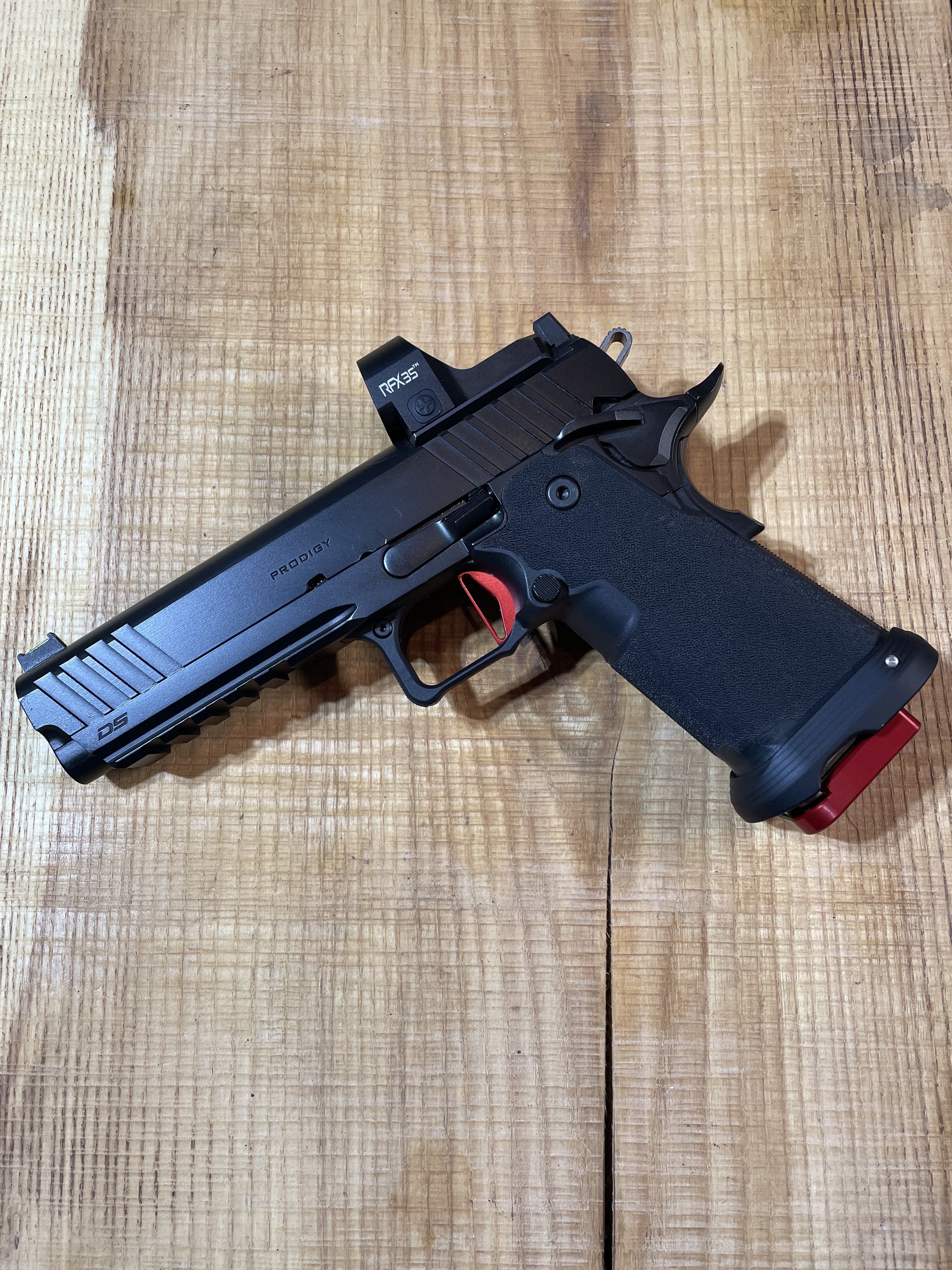

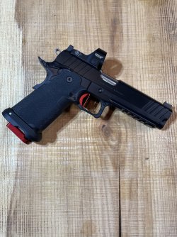

Hey all, im new to this forum, well new to join. figured its past time i get on here and start contributing what i can. i picked up a 5" prodigy about 4 months ago. a buddy of mine had it and then bought a staccato tuxedo so he ended up selling me his prodigy. right out of the gate the firearm performed well and i was very happy with it. im never one to leave things alone though, im always wanting to tweak or improve if possible, and this is a fantastic platform to start with. as a note i did end up with some failures to feed with the stock 17 round mags nothing terrible but still. anyway i ended up going with an egw ignition kit, atlas trigger, staccato magwell, atlas mags and a staccato mag, cheely xl firing pin with wolff spring, wolff recoil spring 10# and 11# (both run perfect), recoil buffer, 10-8 performance two piece recoil spring guide and reverse plug. some custom milling to help solve the disconnect rod contact with slide and once i got my plate i decided to try a Viridian rfx35 as i prefer green dots and like the SRO size. its been a learning experience all the way. but i feel like the time and money spent has been well worth it. im usually a built not bought type of personality. here some pics with a first day range photo after i got the green dot mounted and sighted in at 10 yards.

Just follow the instructions. Place the sensor on the trigger and your finger over the sensor and pull the trigger. If you hook the sensor over the trigger and pull with the body of the gauge you will get wildly different readings. View attachment 35378
I have also noticed that if I pull it very slowly, I get higher readings, and if I pull it quickly, I get much lower readings. Thus why I am curious to actually see how you’re doing it to get a 3.5# average.
I’ve noticed this as well. I take an average of 5 readings when I do mine…and I have the manual gauge not the digital. I try to keep the placement the exact same spot on the trigger, cause on non-1911 shoe style, it can vary.
Average readings is best. Only 100% tried and accurate is with weights, but the gauges can get you within a few ounces if repeatable and done as close to the same each time
I pull it like I shoot it. I also do a 5 pull average. If I’m honest, I can pretty much gauge what a trigger weight is. 2.5, 3, 4, 5+ are pretty easy to distinguish. You just have to pull enough triggers!
