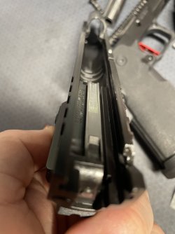

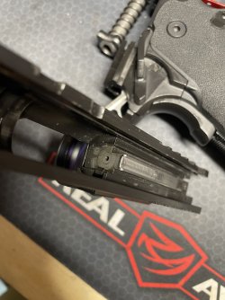

Im pretty sensitive to things like the disconnector rod making contact with the slide. (egw kit in already). and although it does improve from when the gun is brand new to after when you have fired a few hundred to a 1000 rounds its still an "issue" for me. some rigs are worse than others, some people except it others do not. from the pictures youll notice i went for a "fix" that maybe not all will be able to do or find necessary but for me i had access to a milling machine and i like this kind of stuff so i went for it. i milled out the center portion where the disconnector rod would make contact. i faded out the section of milling to zero for a smooth transition. now the action of the slide is a dream and this Prodigy just runs and runs. i cant help but think for some the contact that the disconnector rod makes slows down the slide as it attempts to feed a round into the chamber. is this the only issue for some.... i dont think so, but for me im now able to run a lighter recoil spring where as before i had to run a heavier one. your preferred recoil spring is another personal preference. anyway just thought i would share. this kind of thing is enjoyable for me. the slide milling was nerve wracking but i took very very small amounts off at a time, probably made 6 passes total, and tried each one before i made another pass.
Your repair looks like it did the job. All it would take would be to remove a few thousands of an inch to make a difference. Unfortunately not everyone has access to the equipment to do this fix.
