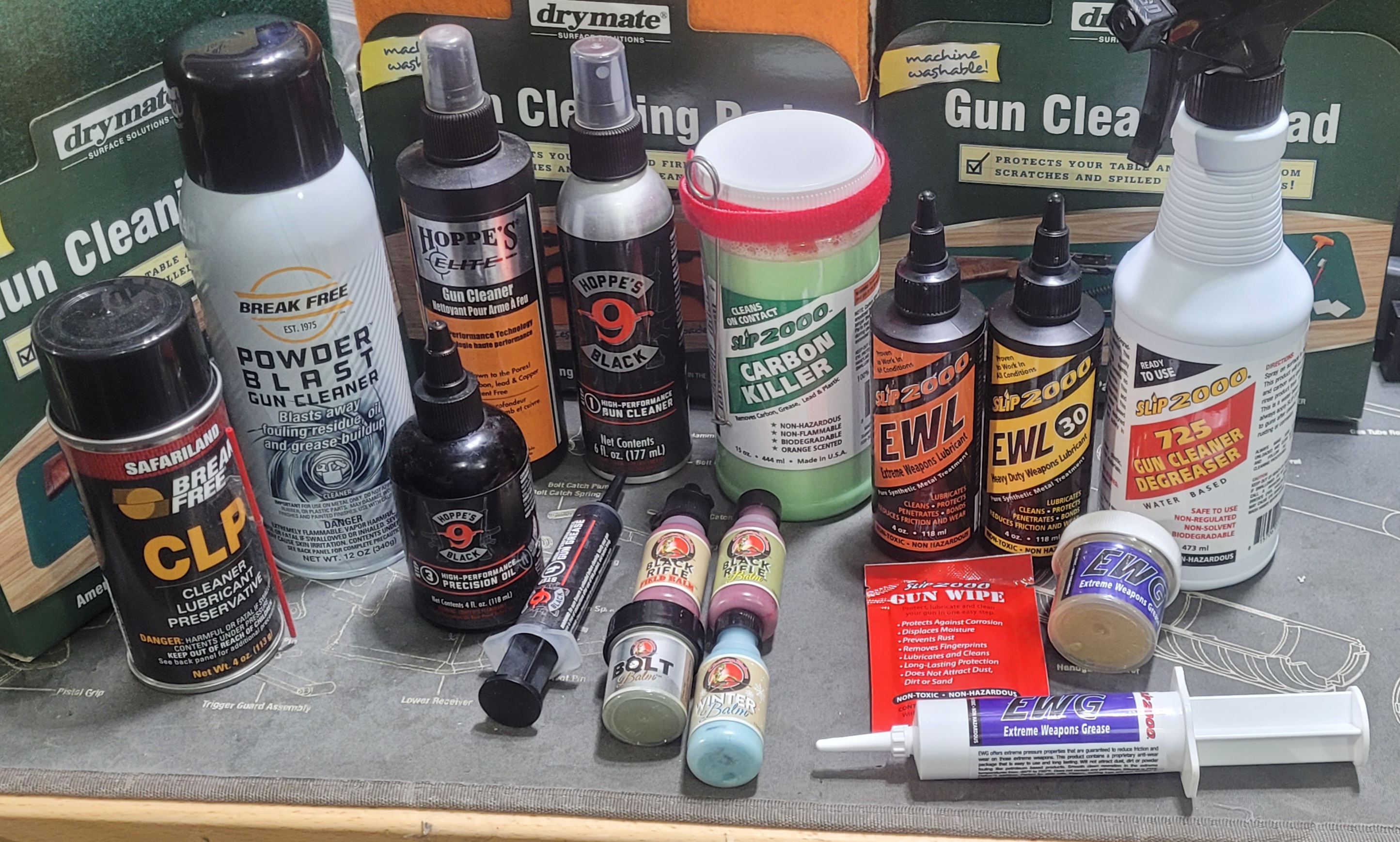

So…here’s a dirty little secret.
AR’s don’t need nearly as much lube as you all think they do, and will run a LOT longer without it than you could dream.
I wonder how much Slip 2000 they lubed it with before they started ?

So out of boredom mostly I have been researching "Best" lubes for ARs. Lots of opinions out there, so what's yours ?
Grease ? If so, what and where ( specifically) and under what conditions ( temperature) ?
Oil ? If so, what and where ?
