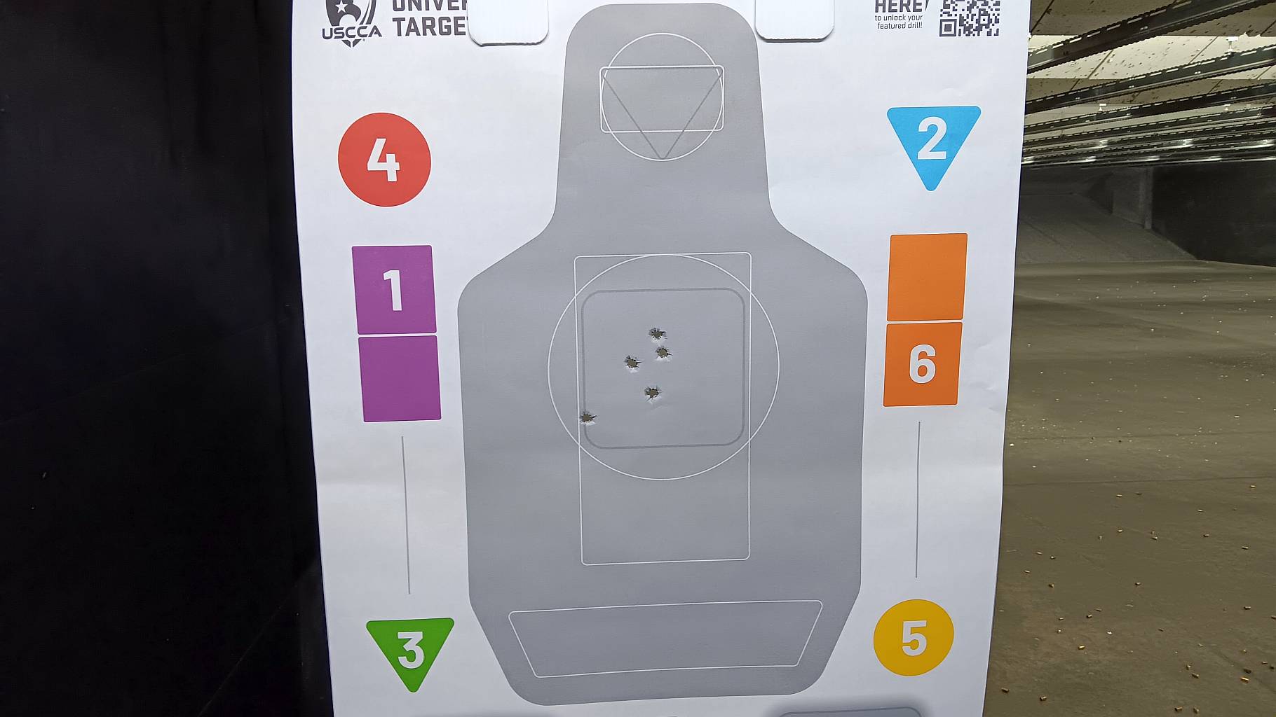

After a trip to the range I've noticed that I am consistently shooting 1"-2" low left @ seven yards with different pistols using iron sites. can you suggest anything to look for in my grip that may be producing this result?

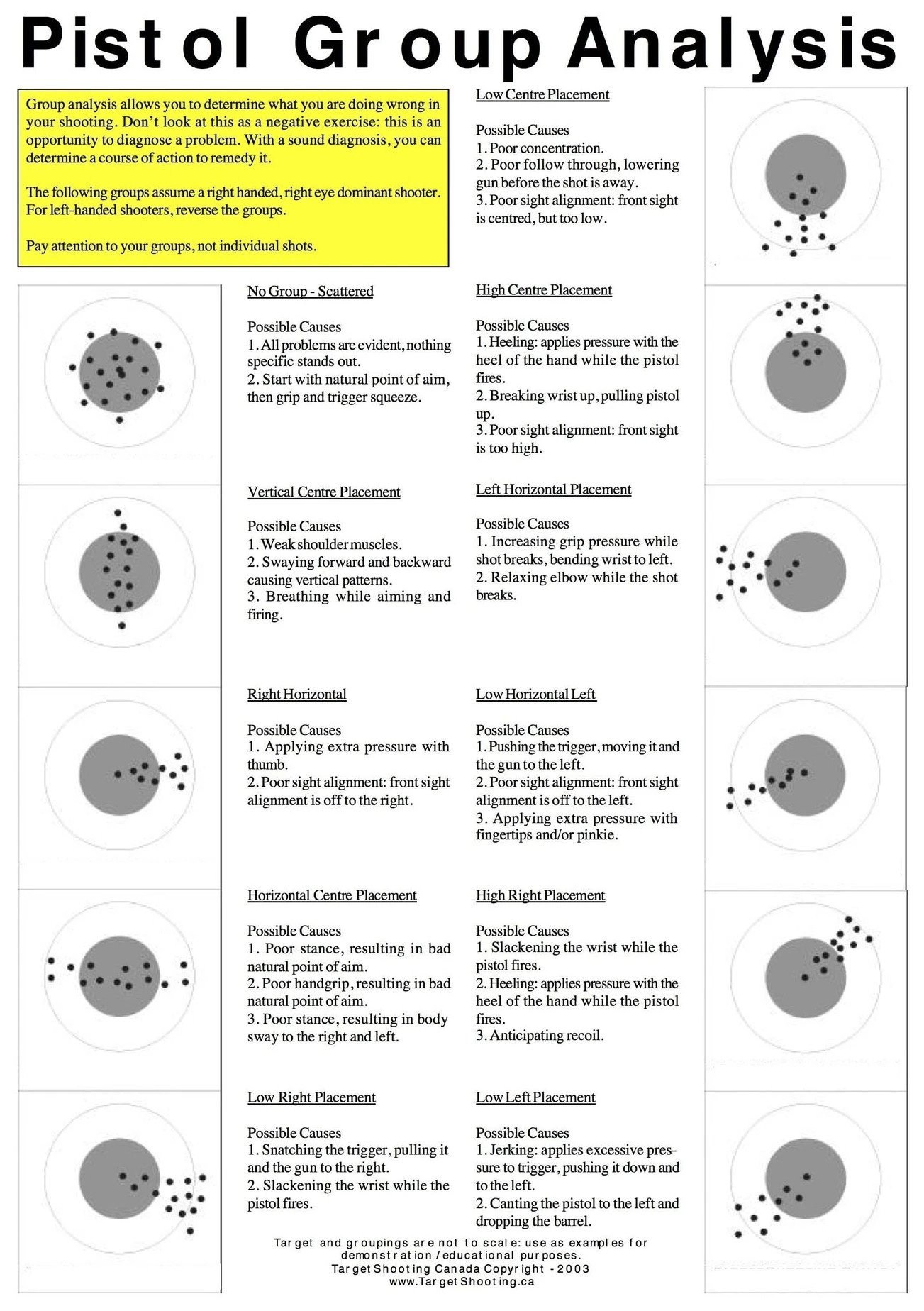

I had the same issues when I bought my first Springfield XD MOD-2.
I found my problem was, I wasn't using a lot of grip pressure, and I found myself slapping the trigger instead of pressing the trigger.
Hope this makes sense.
I learned to shoot years ago with revolvers and did not have any issues.
your finger pad placement on the trigger may also play a part (below is for 1911, but can be applied to other pistols as well)...
