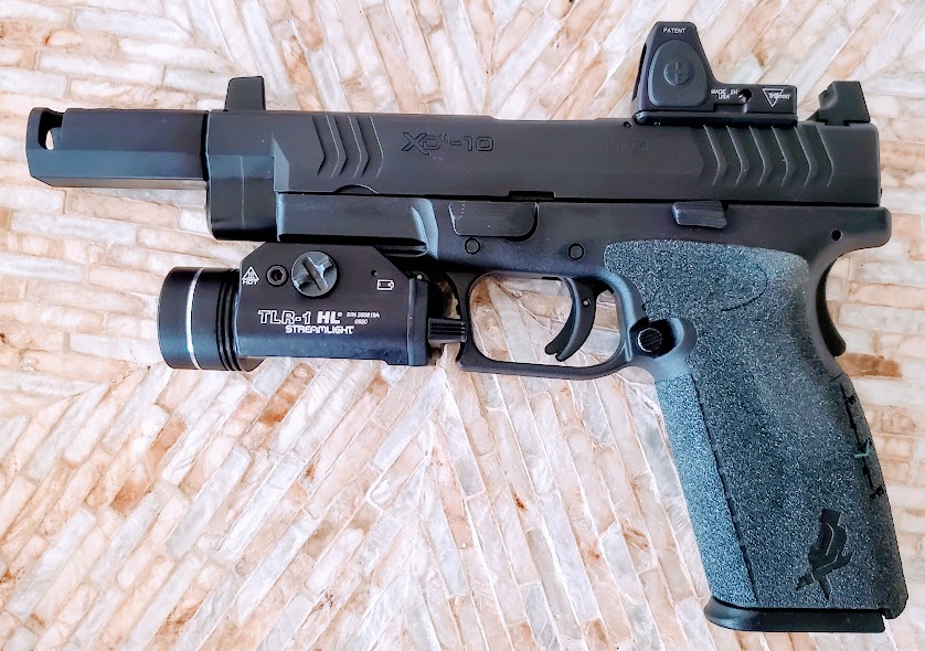

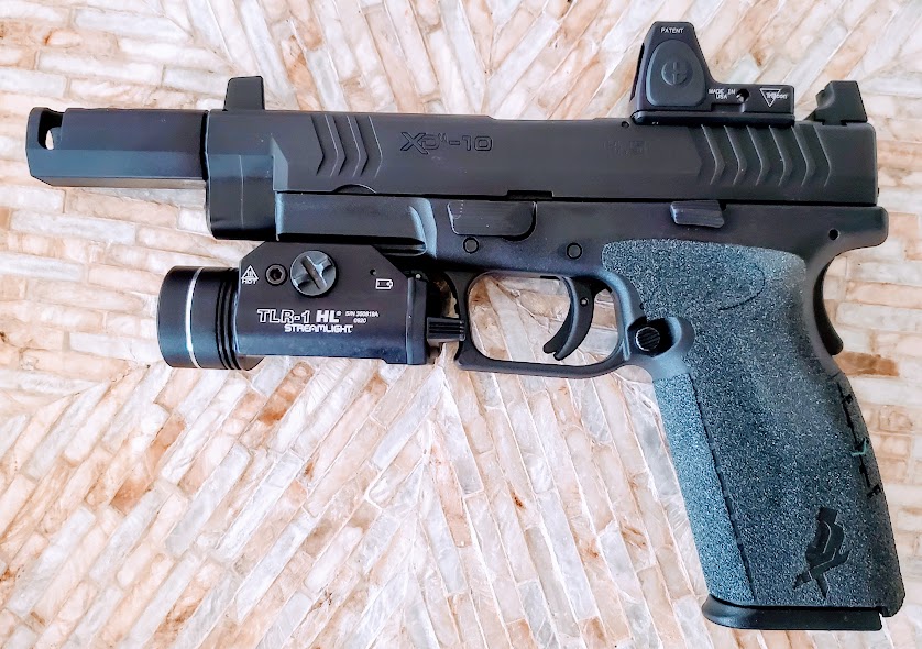

I have a Springer comp on my XDM 10mm 4.5" OSP w/Threaded barrel and co-witness iron sites (not-elite), and YES it makes a HUGE difference. It's a little bit louder, but the felt recoil is much less, I can push hot 10mm 180gr 1600fps and the recoil is no more than a typical 45acp or even a stout 9mm+p. With a 10mm round that is basically equal to a 357mag in fps & ftlbs that's a alot of reduction. I can make double tap and fairly rapid follow up shots with this hot 10mm round. With the comp and red dot I can make them quick and accurate as well. I do have more than just a comp helping me, I also have a TLR-1 light on the rails which helps keep muzzle flip down with the added weight. Springer has good options for many SA and other guns, check out their website... https://shop.springerprecision.com/ - I highly recommend Springer and this type of platform. I hope to use this as my hog gun 25-50yds out. Biggest challenge is finding a holster to carry this guy (not CC) but maybe a chest rig. Working on a custom solution, but not there yet. Any suggestions?

So, 1,023fpe from a 4.5" barrel.................................................are you running 50k on pressure. I know I've had over pressure with some 357sig loads that were very hot, but doable with a brake/compensator on it. I put a warning label on the box of my reloads stating "use comp only" for safety reasons. What was the charge and powder used for this velocity?

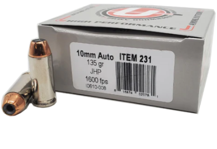

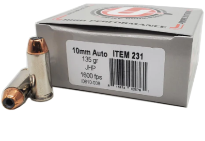

I am not loading my own, these are the stats from the side of the Underwood ammo box I use often. I have not done any tests to confirm this velocity. I also stand corrected, its 135gr at 1600fps per the box (not 180gr). If my math is right these should have about 750ftlbs of energy. Assuming we're actually geting to the 1600fps level. In any case, still greatly reduced recoil with the setup mentioned/shown earlier.

That makes more sense. I've had myself several typos, so no worries. I need to chrono those very hot 357sig loads, but I'm guessing it's 5k or more over pressure. I have 2 in that cartridge (g31 and p226). The g31 is the gun I shot with those op loads and no way am I going to try it in the 226!

Agree - would not do this on a carry gun of smaller stature. Clearly this is not one of my carry guns ;)

So, when you clean it you have to remove the Comp. Do you think it wears out the gripping of the barrel or is damaging and do you use lock tight? Not sure how this one attaches, some have a screw then a sleeve like balancing pressure and some are direct screw into barrel for grip... Thank you!!
EDIT:
I checked Springer and they have a great video explaining my questions. Locktight, clean with Comp attached and no screw locking the Comp.
