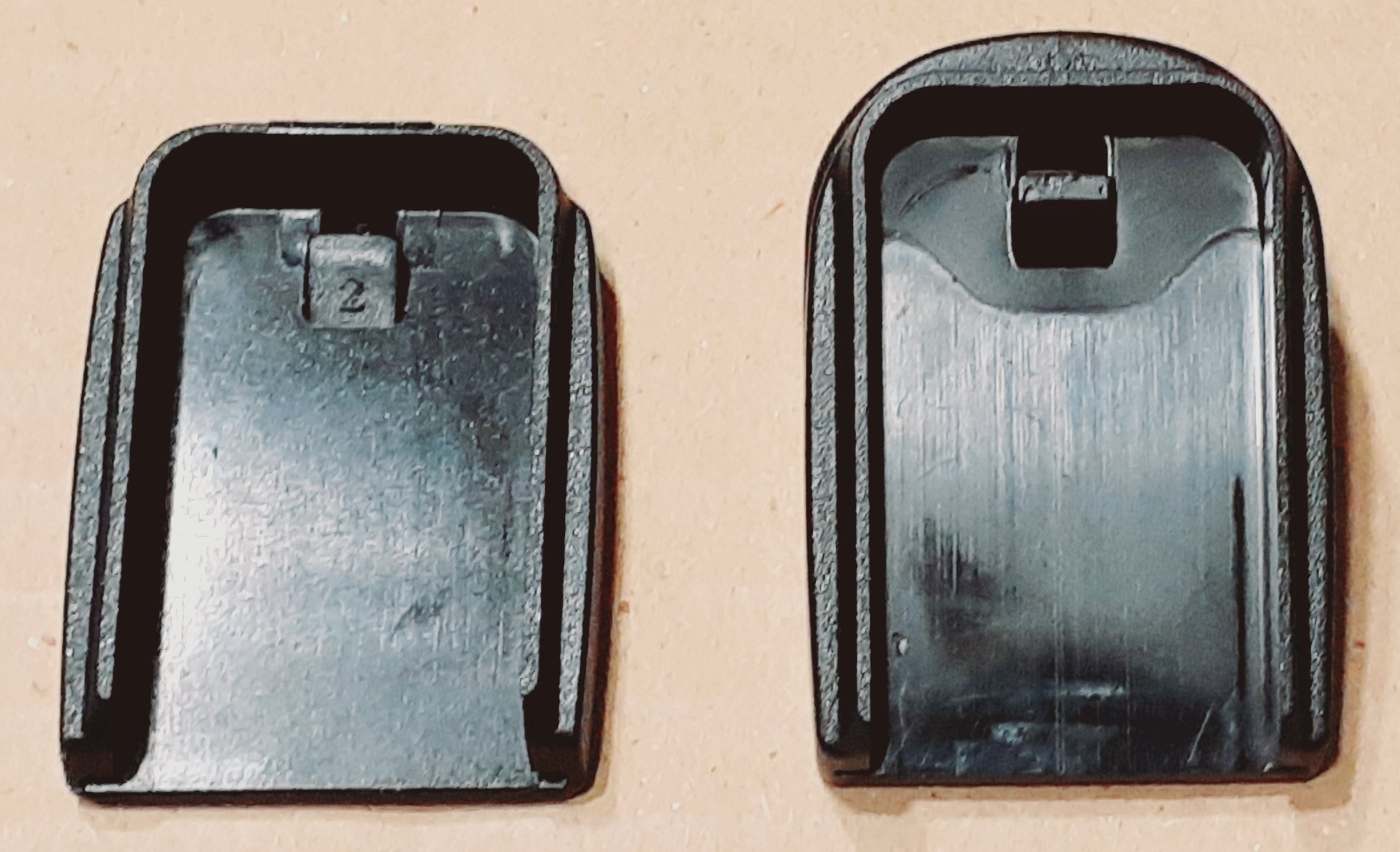

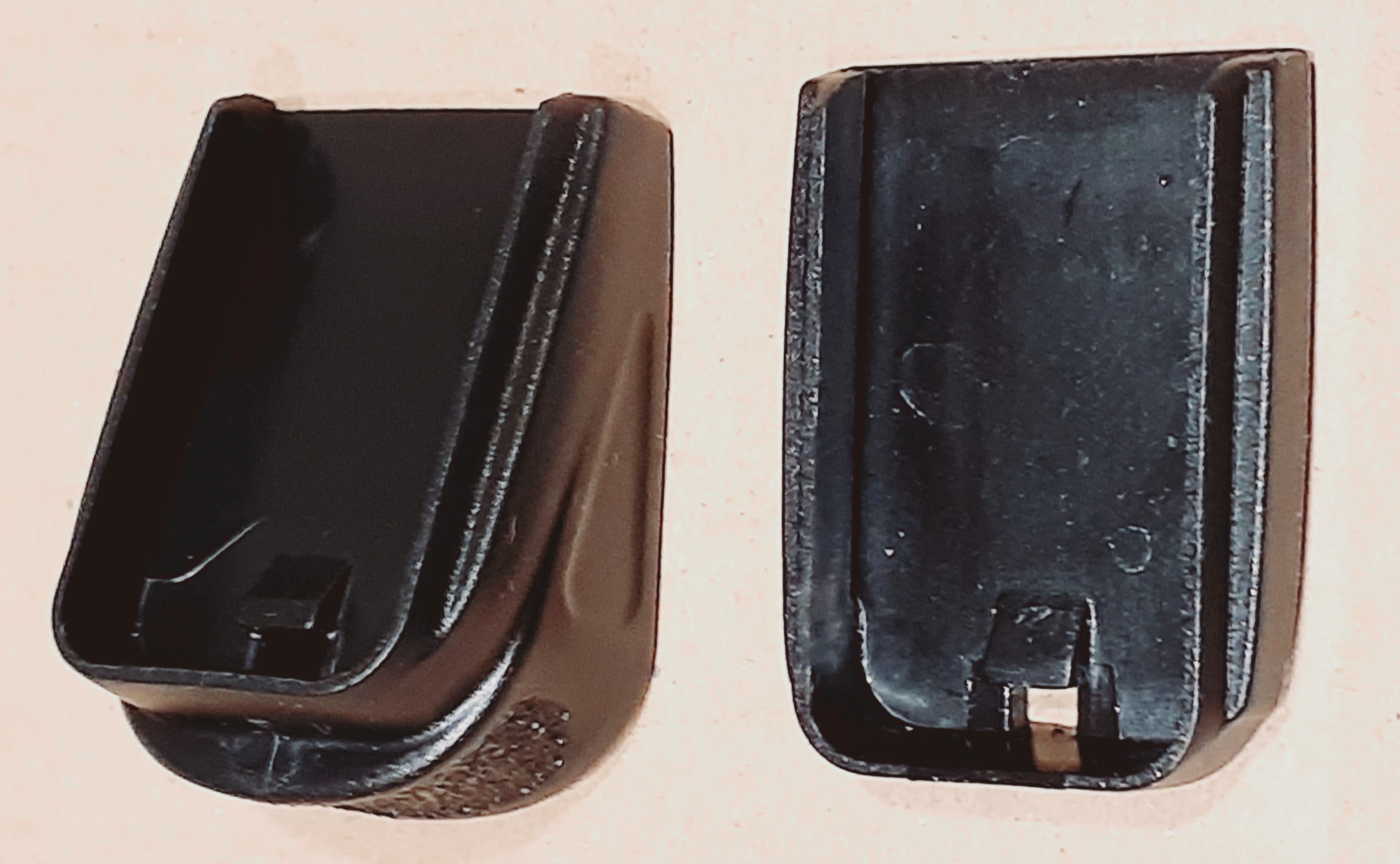

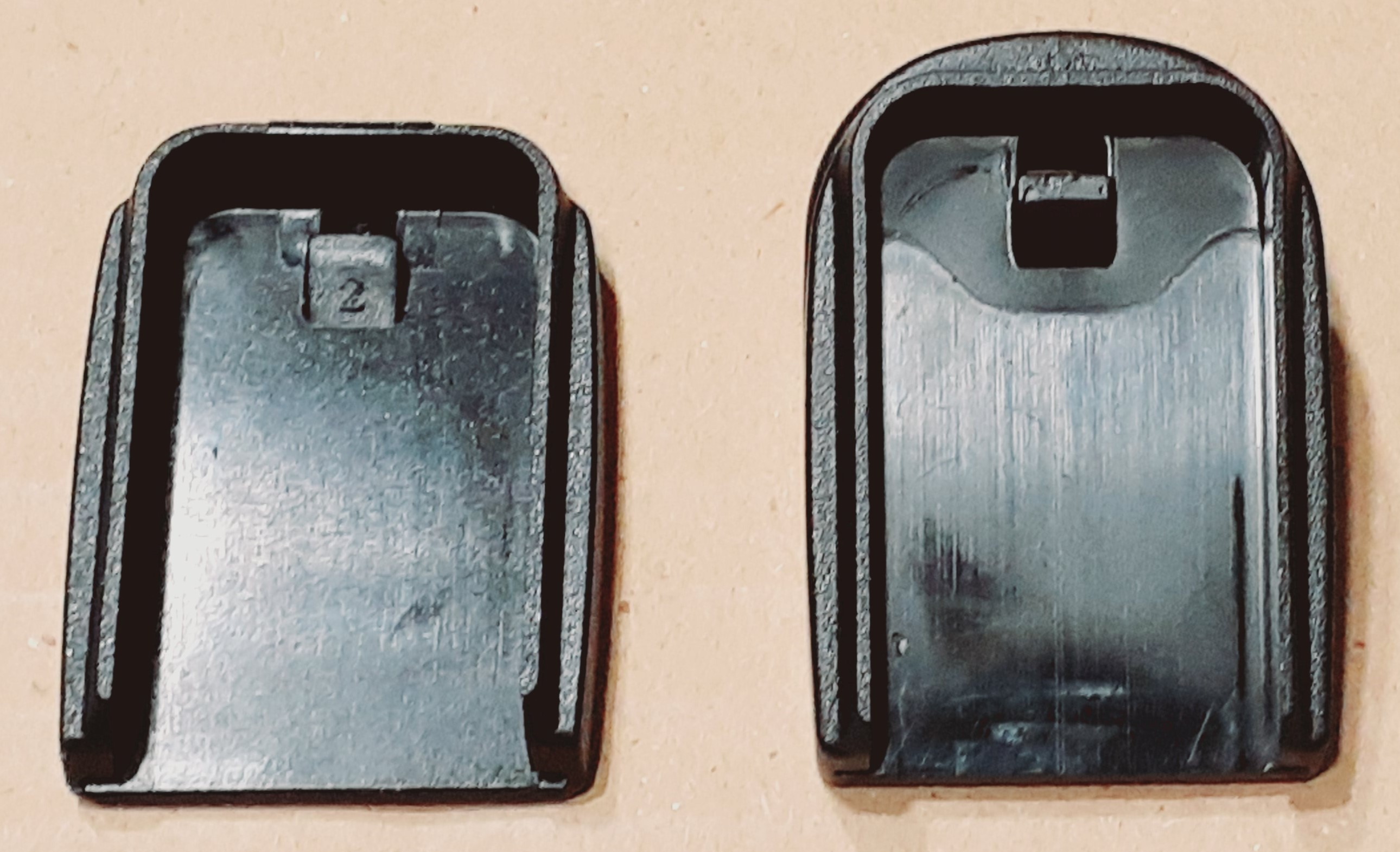

Looing at the picture of the 10 round mag, externally, it looks like an 11 round mag, except it is just missing the 11th round sight hole. I am betting that it is just a spacer at the bottom of the mag and not a different follower. If you can open one of your 10 rounders and verify, maybe post a pic, I can compare it to the 11, 13, and 15 round mags that I have here.
If you need any different angles or better light let me know.
Edit: here's the spring/follower (round for scale)

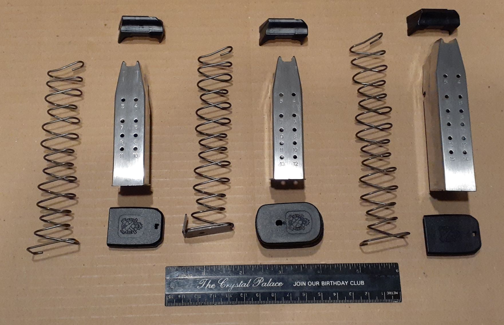

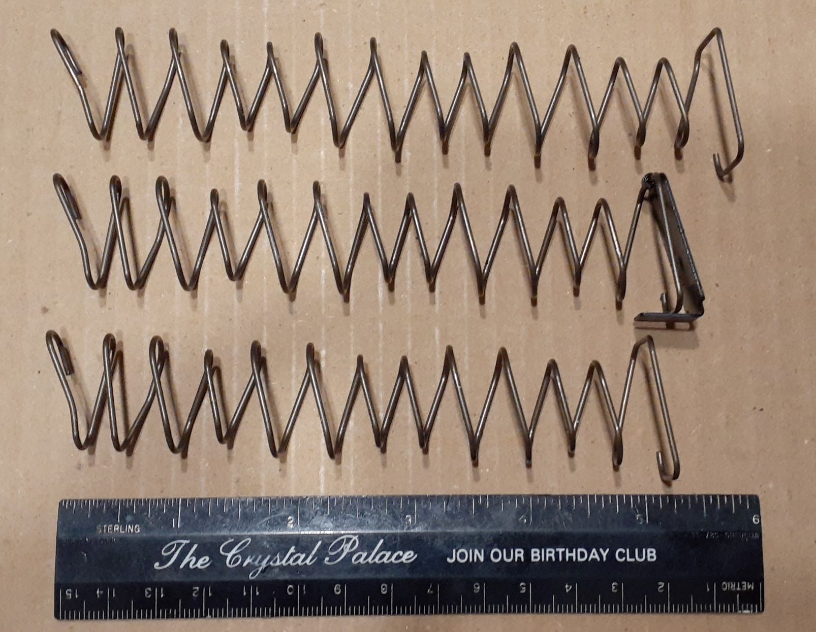

From what I can tell,
1. The follower is the same for the 11, 13, and 15 round magazines, so I would think that the 10 is the same.
2. It looks like the 13 round mag is just an 11 with a +2 base plate
3. The 11 and 13 round springs appear to be the same length/turns. I don't know why the changed the base plate retention method for the 13.
4. The 15 round is just longer.
5. The +2 baseplate fits on the 15 round mag, so yo could do a 17.
Looking closer at your base plate, I think that the 1 round spacer is integrated into it. So I think that you just need a "flat" base plate to got 10->11. or a plus (+) adapter to go above 10.
Update: for the +2 baseplate to work , you would have to somehow get that plate off bottom of the 13 round spring as well since that is what keeps it in place.
Hope this helps.
That kinda sucks. That means that the baseplate for the 10 rounder is "unique" and incompatible with any of the other 3 mag sizes base plates.
Yeah. I already messaged a couple manufacturers that make the extended plates for the hellcat and none of them have any intentions of making a version for the 10 rounders.
The magazine bodies are the same for all the mags.
The 11th round is the first round on the follower, as well with the others that have extended base plates/pads.
No extra sight hole(s) are needed.
There is a difference between the 10 round and the others. Look at the lips the hold the baseplate. The 10 rounder is folded in. The lips on the 11, 13, and 15 rounders are folded out. I was speculating on the differences before I saw the pictures of his 10 rounder.
Minor difference in order to hold the extended base plates better. The "bodies" & the number of holes are still the same.
