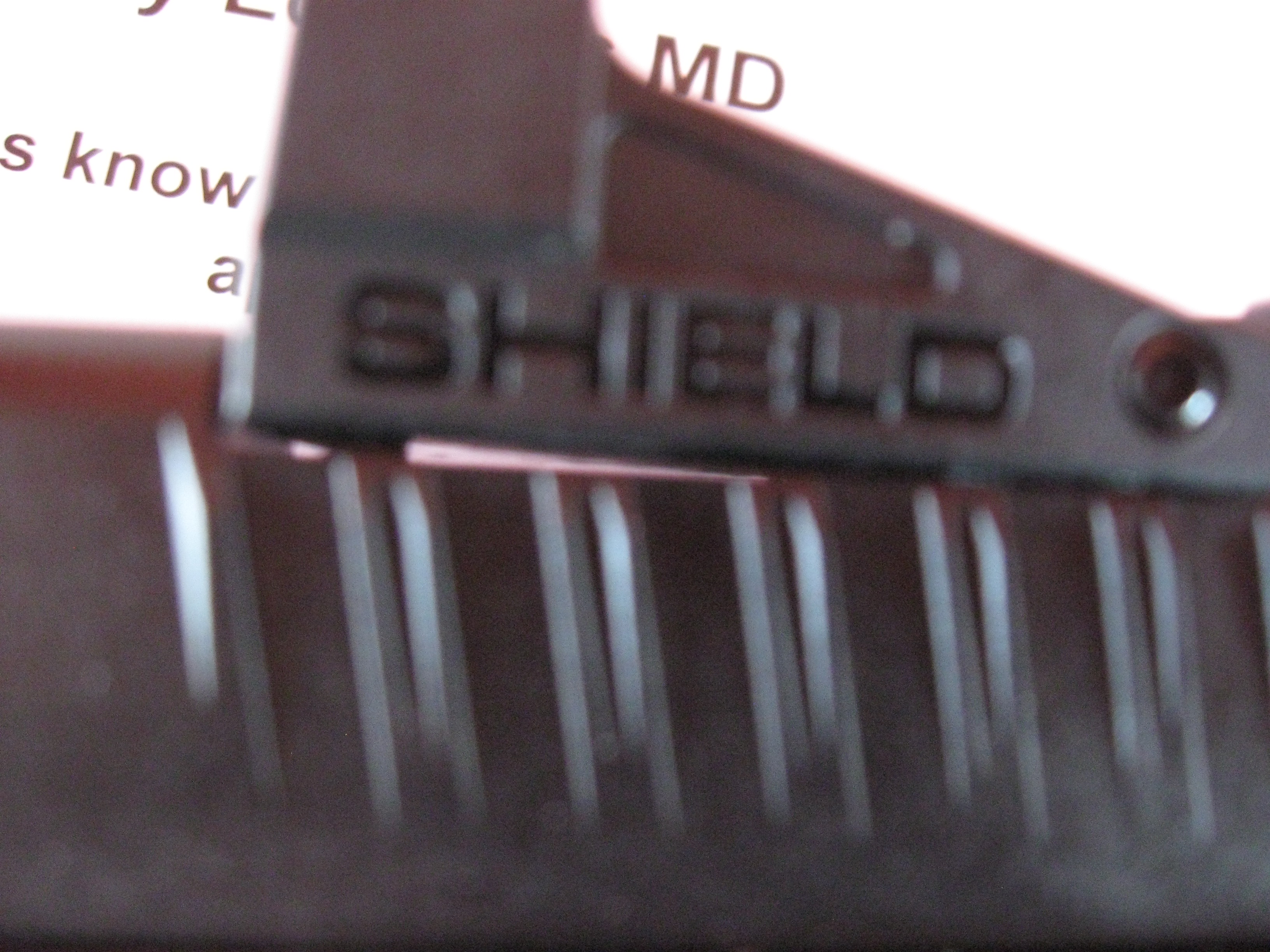

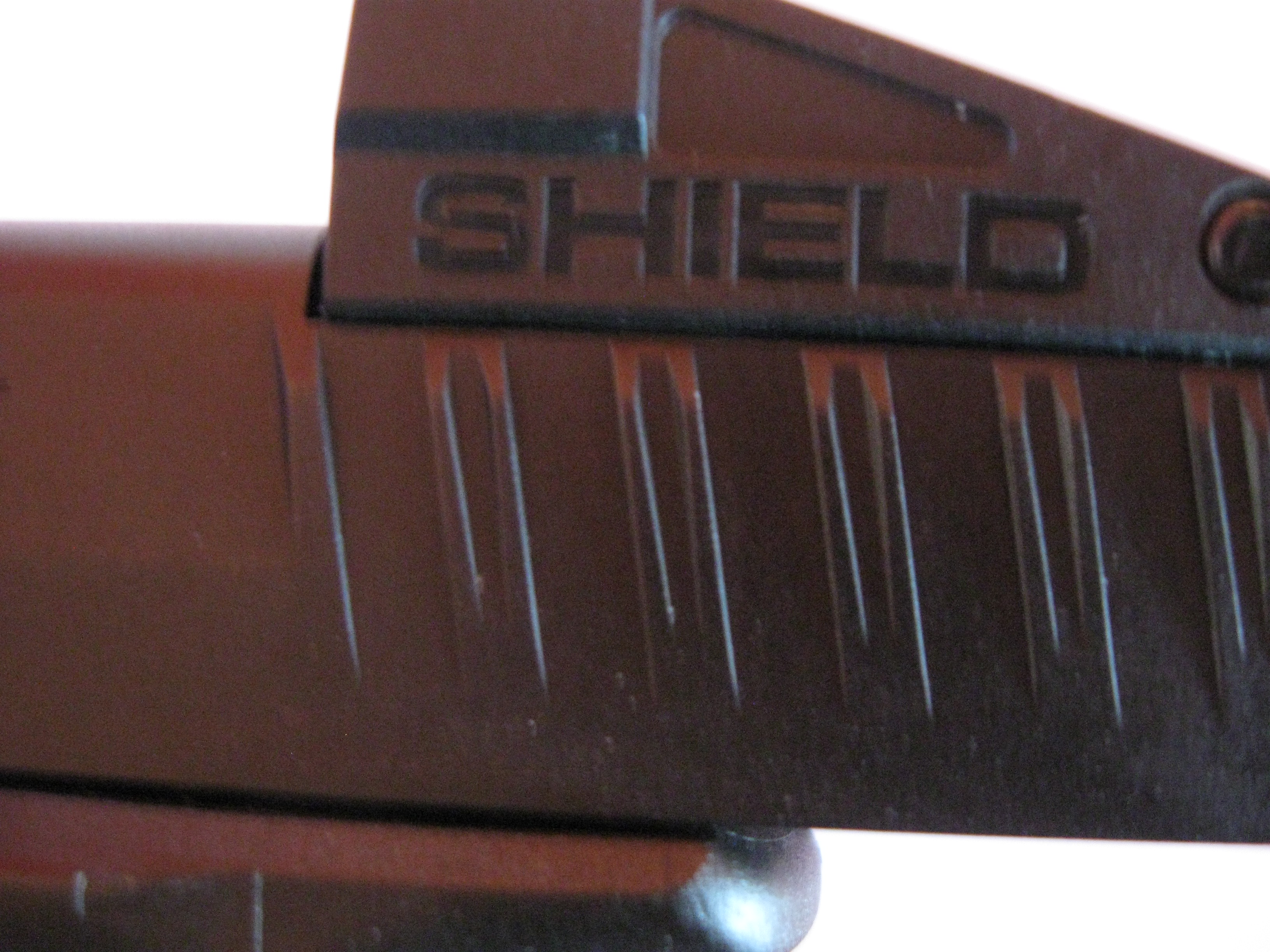

I share your annoyance. I got my SMSc through Springfield Armory today, and honestly it looks and feels like a 50-cent prize you'd get from a gum-ball machine. Once I installed the optic and roughed in the dot, I racked the slide using the optic. Wow, the dot is nowhere near the irons now. I looked at the optic and saw that the front part (window side) was raised up off the slide cut-out a wee bit. Removed, reinstalled, no gap. I adjusted the dot back to "just above a good iron sight picture" and racked the slide using the slide serrations instead of slinging it with the optic, and the dot again was off. To me it seems that with no "third mounting screw" near the front end of the optic, the polymer optic frame is free to move about at will.
Any suggestions?

Heck, I make somewhat better than "average money" and I'm still torqued when I run into things like this. I know the pics ain't great, but it's the best I can do right now and you should have an idea what I'm talking about.
I won't mind running the Hellcat naked, it takes the place of my original Shield that I ABSOLUTELY HATE the grip on. I'll consider this gun a step up with the increased capacity and better feel in my hand, but even a billionaire doesn't like throwing cash into the toilet. That's how they became billionaires. The SMSc is $300.
Figured it out. The "washers" supplied from SA are some type of plastic, which crushed down too much when I tightened down the optic mounting screws. Because they're PLASTIC. I went to Lowe's and picked up a baggie of "Small Flat Washers metric M4x8" (83 cents for baggie of 12) and they work like a charm. Reapplied blue Loctite and mounted the optic using one washer for each screw, no more wandering red dot and no more gap at front of optic. SA,or Shield, whoever puts this "kit" together: please spend the extra $00.1383 for two steel washers. Then bump the price up by $5.
